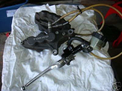

Oh oh.......I may have purchased the wrong calipers......
the mounting tabs look very different than yours....

Old Sep 22, 2007 | 09:22 AM
VTRumble's Avatar
Posts: 187
From: Massachusetts
Those look like the older SRAD calipers, late 90's I think. Don't think they fit.
Doug.O
Old Sep 22, 2007 | 09:41 AM
redman's Avatar
Posts: 387
redman is on a distinguished road
yah...ouch...oh well, back on Ebay when they get here.
