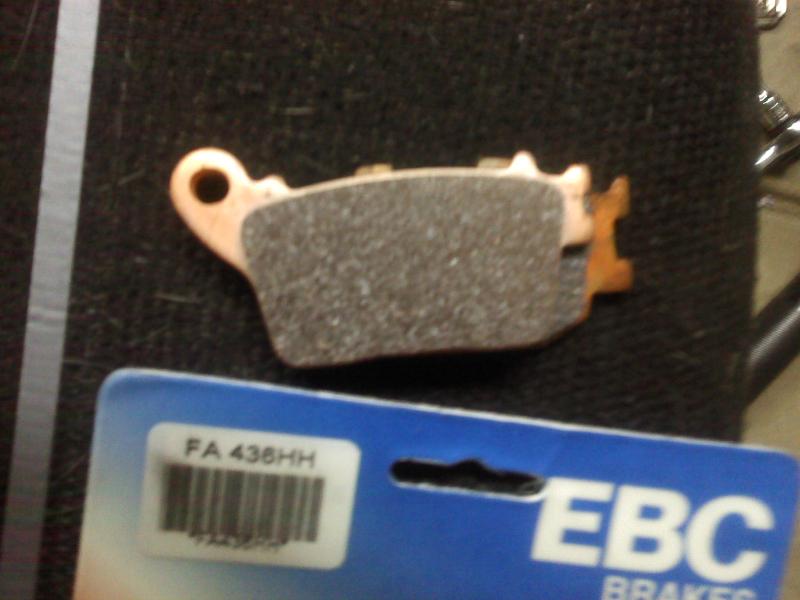

Old Nov 11, 2011 | 12:25 PM
Duck007's Avatar
Joined: May 2006
Posts: 302
From: New Mexico
Replacing pads for the first time and I'm having a brake pad WTF???
See the attached pic with REAR EBC HH laying on top of the stock pad....I could have sworn I ordered the right part #....anyone else have this problem or did I brain cramp the order? Rear pad part # is FA436HH.
I have the pads to replace the front FA187HH but haven't opened them yet.
Thanks!
Old Nov 11, 2011 | 12:36 PM
thetophatflash's Avatar
Posts: 834
From: Nooksack WA
Mistake, the rear is the FA174HH. Did mine earlier in the season, worked good.
