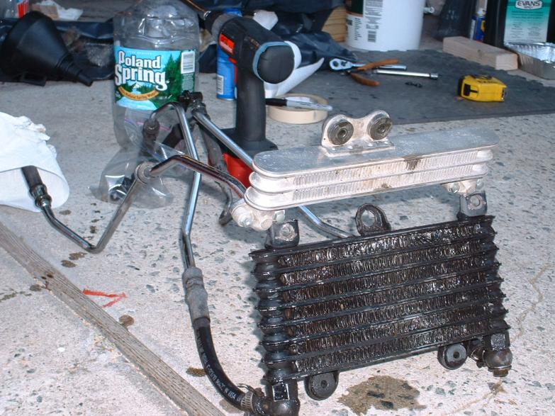

I am running a zx-7 cooler. Works wonders. This pic show the size difference. The bike keeps its cool in 101* city traffic jams.

Old Aug 15, 2011 | 06:58 PM
JamieDaugherty's Avatar
Joined: Aug 2005
Posts: 1,864
From: Fort Wayne, IN
Nice!
