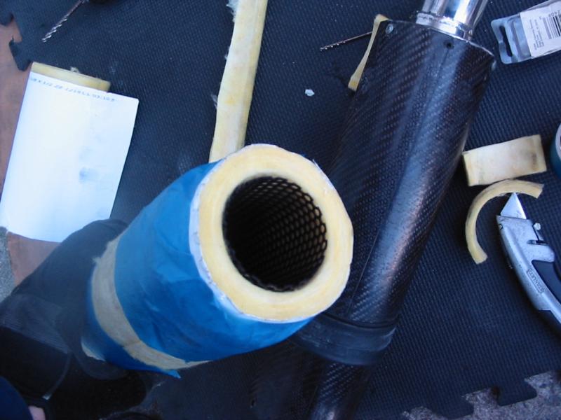

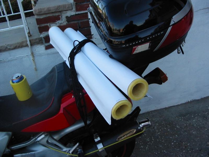

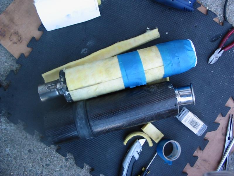

Back in my day...ahem.....last November(ish) we'd just ride on down to the plumbing supply store. Well those guys have insulation already in the right shape!. Bungees right onto the back of your steed and a few hacks of the knife later, you are on your way!
Actually did this only cuz a storm was coming and I really didnt want my carbon cans blowing up in the mean time. Super cheap but doesnt last long.
Then I got this ceramic stuff. Has lasted a good while and sounds good.
Ceramic Silencer Motorcycle Muffler Packing Kit 1" x 12" x 24" High Temperature | eBay
I agree with Carlsbad about the steel stuff. How mad are you after all that rivet drilling and popping when you fire it up and it sounds like a teenagers coffee can muffler econobox?
Attached Thumbnails Muffler repack-loud5.13-lg-tv-012.jpg   Muffler repack-loud5.13-lg-tv-013.jpg   Muffler repack-loud5.13-lg-tv-014.jpg   Muffler repack-loud5.13-lg-tv-011.jpg

Quick and easy repack
My friend who is a Master Honda showed me years ago how to repack mufflers back when we were racing 2 strokes and at a time in motorcycle history when back pressure was a must in order to go fast!
Man was it an oily messy dirty job.
Ok,
Wrap your new packing as tight as you can around the core, then go around the outside of the packing as tight as you can get it with everyday masking tape.
The masking tape holds the packing in place so you can finish the rebuild.
Once the engine gets up to operating temps the masking tape burns away and the packing expands to fill the voids inside the mufflers.

YES SIRR! Thats what the blue tape is in my pictoral tutorial. For sure its not a fun job and the dog days of summer is the worst. All those micro fibers flying into open sweaty pores.
I was amazed how nice the job got in 50*F and long sleeves.
