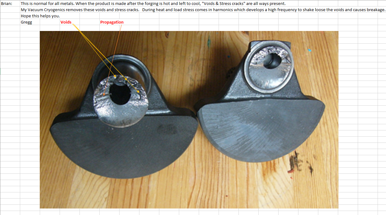

Have we? I must ha e missed that...thought it was a myth or one of those..."at 11000 rpm my crank broke..." Things. Kind of like a yeah but we'd pretty much expect that to happen, but not typically. I mean, my current rotating assembly is only trued for straight with balanced rods and it seems redline no issue. Whose crank broke? I'd love to read about it.
Av
Old Jun 14, 2020 | 10:11 AM
ACE VenTRa's Avatar
Joined: Jul 2018
Posts: 568
Apparently the search function still works...
I sent the pics of the broken crank over to the engineer that helps me out and here is his very brief answer:
A very brief (no charge) answer.

You can ignore it , because there were very odd circumstances involved.... Also,, After extensive Google-Fu, I can't find any other reports of failure... Pick just about any other bike and search..... So it is just a random bizarre thing...
.Also...... "My Vacuum Cryogenics REMOVES THESE VOIDS AND STRESS CRACKS..." ????? No.... It doesn't.... May cause them to be less of an issue by hardening the metal around them, But no amount of any kind of tempering will fix a crack, or fill a void...

Cryo does not harden....it decreases the tendency to fatigue by changing the properties of the metal. The austenitic/martensitic conversion through use of cryo is a well documented and researched topic and has been for decades. I know personally from having conducted literally 100k or more ultrasonic shear wave tests, and other non destructive tests, on aluminum, steel, and other materials that this true. Hardly debatable like it was in the early days.
