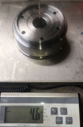

Old Mar 31, 2019 | 05:26 AM
Originally Posted by ACE VenTRa
Ahhh, does that mean you've got a flywheell on the way? Best mod ever...Did you sort that cylinder gasket yet?
I never give out customer names....but can say somebody in this thread is getting a 4lb 6oz package shipped to them on monday.
