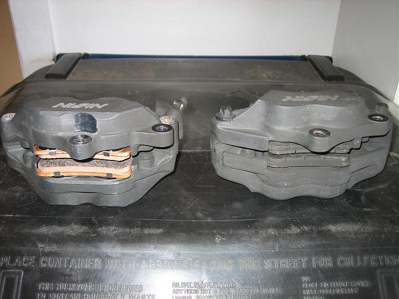

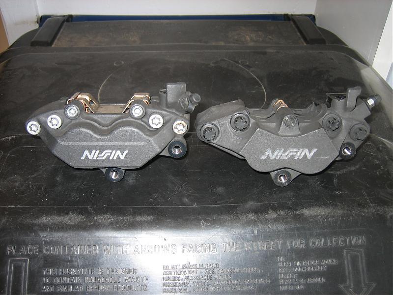

Maybe this pic will help...
Here's a pic to help you those see the physical differences in a 929/954/RC51/F4i Caliper (On left....F4i in pic)vs. a VTR caliper (on right).
The GSXR1000 Calipers (I forget which years fit...Ask Superhawk 22 for that) do bolt up...some have said 4 pots are lighter than 6 pots...I don't know...it up to what you like and that both are a great upgrade to your bike...
Attached Thumbnails List of Bolt-On Front Brake Mods-img_1327.jpg   List of Bolt-On Front Brake Mods-img_1328.jpg

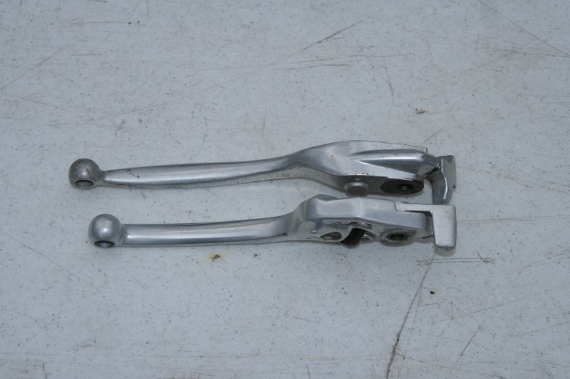

Here's a picture of a 600RR lever (top) and a stock VTR lever. The 600RR lever, which will fit the mc's from the 929/954 and RC51, is obviously thicker and won't fit the VTR or F4i mc.
