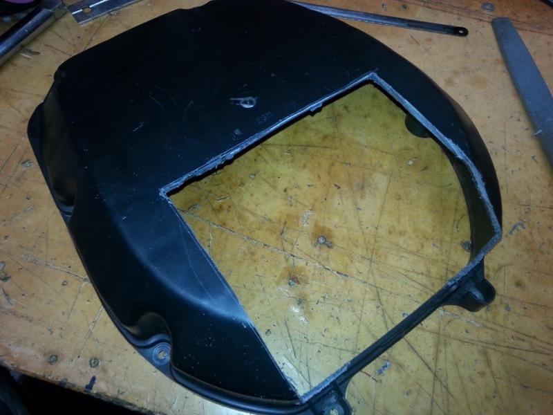

So started at lunch time. So far it looks very easy how im doing it. To the point I had to stand back and make sure I wasn't missing something. I will have the lid ready to assemble tomorrow. Photos being taken so will post later.

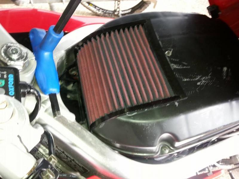

It has started.....
Attached Thumbnails Latest OCMD project: modded airbox lid-10626486_10203670212329039_6130216108485704140_n.jpg

Originally Posted by NZSpokes
It has started.....
Nice! Now, are you going to conform the filter to the lid profile? Mikstr and I both sunk ours down a bit into the lid, so it wasn't tight up against the bottom of the tank and could get some decent airflow. We both still raised our tanks a bit. Food for thought.
I currently have 2 plans. First is just fit the element in the hole as it will just clip in. Then raise the tank 10mm. Frontal area is huge in comparison to stock. This I may well try first as it is easy. the K&N once it is off its solid board is flexible so will easily conform to that shape.
Other way is to mount it on the inside of the lid. I would probably make clips and rivet it down. Then use RTV to seal it.
My preference is the first way as it will be the easiest to replicate for others to do. The filter area is more than enough to flow good hp even with the top part restricted by the tank.
I will also be using an O ring to seal the airbox not a cut up filter housing as that will gain me a couple of mm.

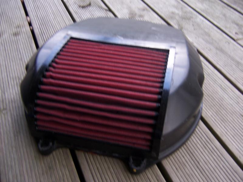

Getting there. I cut the hole a little big but it hold there fine. Will run a little RTV round the edge on the inside and use some to hold in the O Ring.
And the geek in me has to weigh it all as well.....
Should be on the bike later today.
Attached Thumbnails Latest OCMD project: modded airbox lid-100_2199.jpg

That's awesome! I wanted to do that with mine, but the pleats on my K&N filter ran 90 degrees to yours and couldn't bend that way. You got the most post filter volume by doing it that way. Looks great man.
What are your plans for carb settings first time out with the new lid?

Well its on the bike. Ive got 10mm shim under the tank but I may half that. Will take photos at the first jet change.
Im going to ride it as it is. Going out in a couple of hours. Im sure it will be wrong but will give me a starting point. Only ran it for a few mins but its doesnt like idling. Sounds blubbery so I suspect its rich.

Oh another idea i had, just in case it really doesnt run well I can re-fit the K&N filter holder . Not sure if this would help but just something that jumped to mind.
Weight savings is 400grams. I can eat another Big Mac.

Im no good at photos but here we go.
Attached Thumbnails Latest OCMD project: modded airbox lid-10628500_10203688001573759_2586977671462824564_n.jpg

Looks fantastic all together. I can't wait for you to get the carbs dialed in. You won't believe the difference!
For jetting, maybe look back at mine to get ya in the ballpark, since your K&N looks to be almost the same size.
