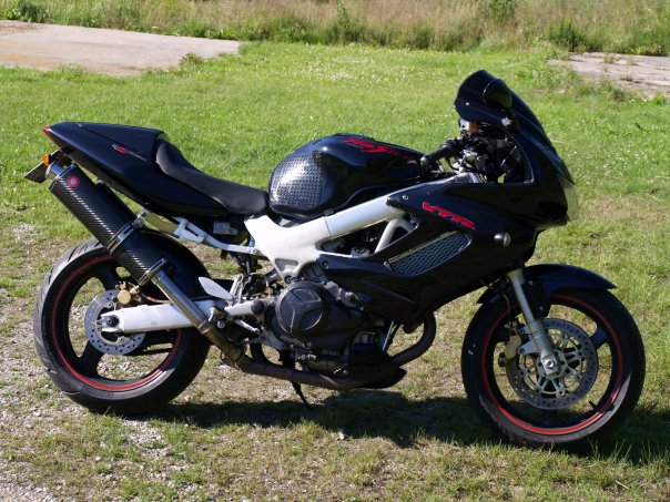

I've been looking for the same thing. so far I have found that you just have to cut and weld.

I just found that on Facebook, He said he just cut it, angled it, then weld it back. took him and a buddy about hour & half. I wish my exhaust looked like that!

Cut or bend and use high mount brackets. If you can't find any brackets make your own out of some thick aluminum.

i've always thought that the mufflers on a sport bike should be parallel to the bottom line of the tail fairing. i've not been a big fan of crazy bends in the elbow pipe to bring the muffler up. a smooth, sweeping bend from under the bike is what i like for the elbow. i think my hawk has yosh that are close to parallel.
then i got my rc51 and began to change my mind. the elbow has the smooth and sweeping bend but then keeps bending past parallel, the way you like it. it's grown on me too.
one time, back in my young and foolish days, i bent the pipe by hand. i grabbed the tail end of the muffler and pulled up. i pulled it up little by little until it was upswept pretty steep. i should try to find a pic of that and post it.

just noticed that the pipe in the above pic is a yosh. that is what i hand bent. it took the bend without any problem at all.

Yosh doesn't make their full system anymore. I tried to buy one off a guy selling his bike locally but he wouldn't go for it. He claimed he could get me one new but it was like $1500-$1600...something crazy. The easiest way to duplicate the low to high look I found was to use a pair of two brothers high mount hangers with a pair of hindle standard mount slip ons. The mids just rotated up and everything still fit great and looked awesome. Im sure you could do the same with plenty of other high mount hanger/standard mount slip on combos. If you use the search (try keywords like "high mount" and "hindle") tool I used to have a picture I'm sure you can still find here the forum.
