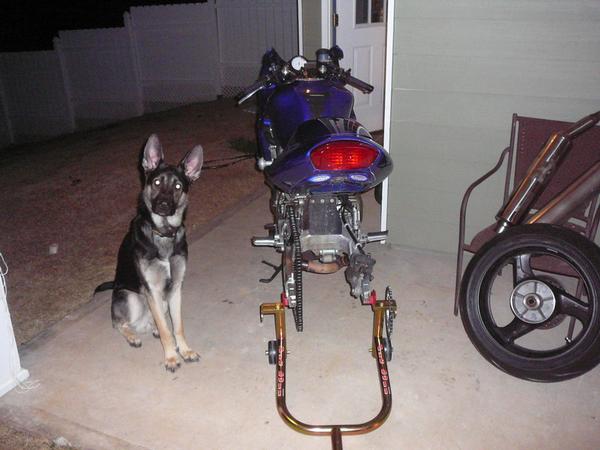

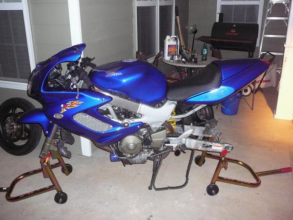

Old Jan 13, 2008 | 06:41 PM
Condor's Avatar
BANNED IN D.C.
Posts: 701
From: Athens, GA
Here she is now. should i get rid of the woody woodpecker decals? i like them, but others might find them fruity..... all of this should be pretty quick fixes. My little helper's name is Nietzsche. always there to lend a hand.
