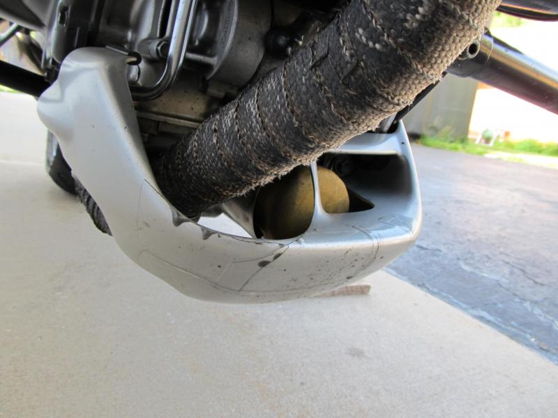

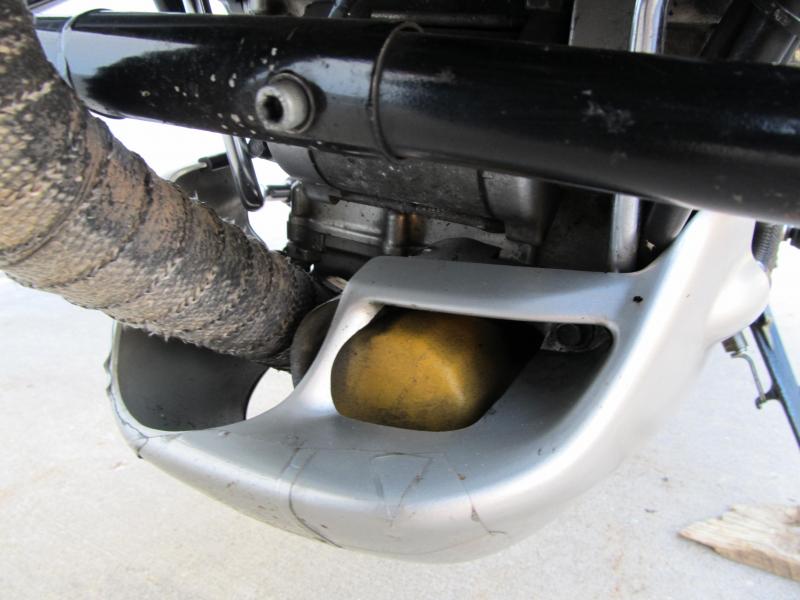

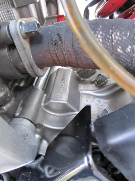

As I said, keeping some heat off the shock and front of the motor and oil filter. I also fabricated an oil filter heat shield (see photos).
Everything positive stated in this thread and what I've read related to the + & - of header wrapping still leads me to believe the positives out way potential negative results.
Attached Thumbnails Header wrap?-img_0074.jpg   Header wrap?-img_0075.jpg   Header wrap?-img_0099.jpg

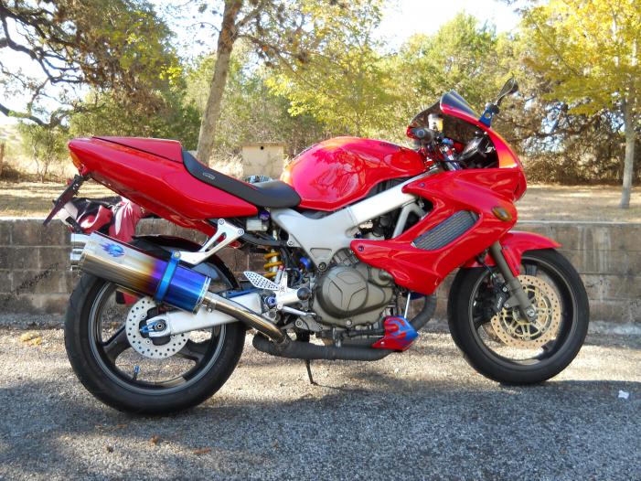

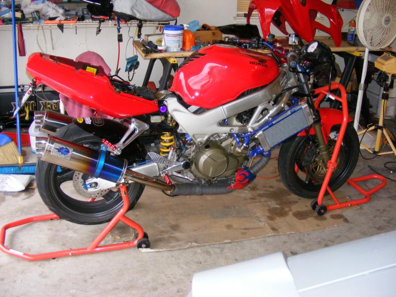

Well, i guess i'll throw my 2 cents in. i have had my pipes wrapped for over 10 yrs. now, & recently unwrapped them, to put new wrap on. my pipes, looked exactly the way they did 10 yrs. ago. I would imagine, keeping the wrap painted with a good high temp paint, that would keep them sealed, would help prevent moisture getting to the metal.
The main reason i performed this, was to help take some of the radiant heat from the pipes away from the engine, & rear shock. I have worked in the industrial generator field for over 30 yrs., & we insulate diesel engine exhaust with thermo blankets/covers to help keep the internal exhaust temps higher. This does help with the scavinging of the exhuast gases.
Do not think this would cause the engine internal temps to rise, if the hot gases are removed faster.
Included a couple of pics of my pipes.
Attached Thumbnails Header wrap?-bike-pictures-024.jpg   Header wrap?-dscn0634.jpg
