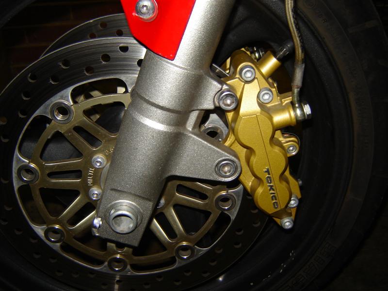

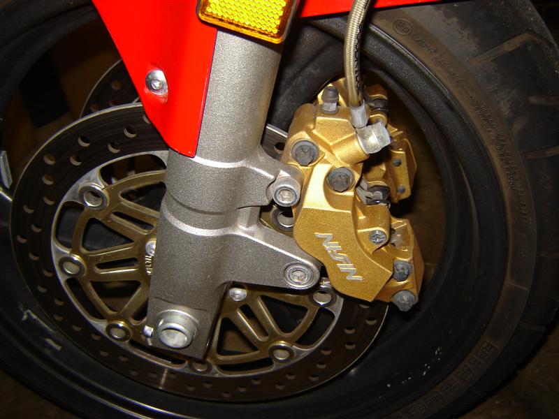

I did the swap a few weeks ago and recommend getting new pads. This will aid mating your pads to your disc. Adding SS lines will improve the feel as you won't feel the spongy-ness of stock lines. While I did get the GSXR MC with my set up, I have yet to install it. May be that will be a winter project as I have several other things on my plate now.
Attached Thumbnails GSXR mod-stock-fr.-brakes.jpg   GSXR mod-gixxer-fr.-brakes.jpg
Old Sep 15, 2009 | 09:50 AM
New pads and some rebuild parts for the 6pot calipers have been orderd.. I'll add that and some new fluid when I get home,,,, if it works, great, if not, I'm changing MC.
