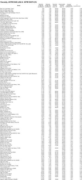

Old May 31, 2010 | 08:53 AM
Get the .85 springs. Change the oil and replace with same or slightly lighter oil viscosity than stock. Stock oil is Showa SS-8 at 36.47cSt. I wouldn't use anything lighter than about 30cSt. Maybe Redline medium (red). This will still allow you some rebound damping control.
See Jamie for a shock.
