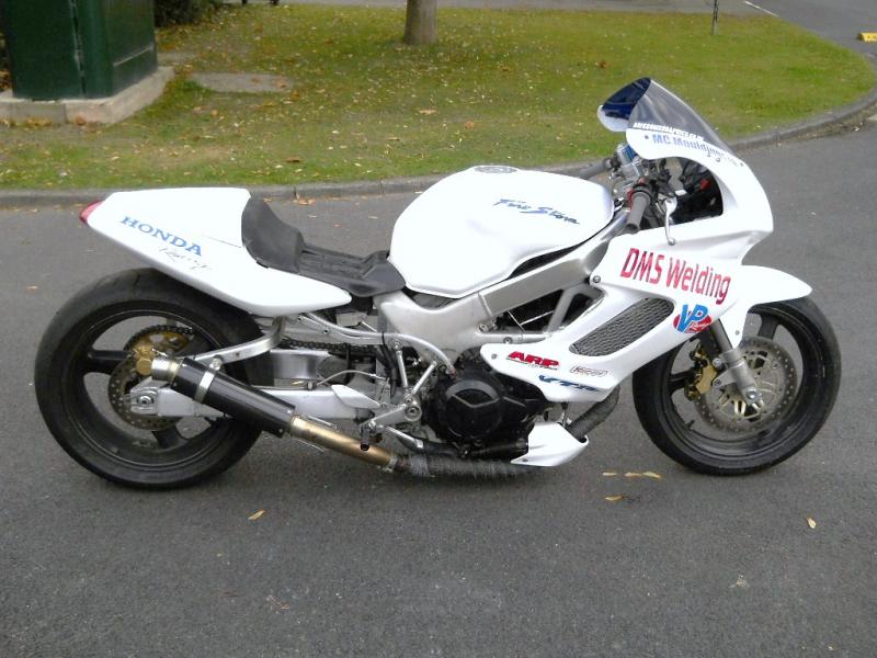

ignitech
Feeler: Group buy of HRC-replica ECUs?-014.jpgHi All, im about to order a ignitech sparker programable race ignition for my vtr dragrace only bike, i was going to strip all wiring and make a fresh race only loom but would like to try with standard wiring first does anyone know if the converter unit fitted on these bike would cause a problem or for that matter what it does .
Old Oct 5, 2011 | 12:00 PM
  #43
Sorry, can`t help you on the question, but wanted to say you have a neat looking VTR.
