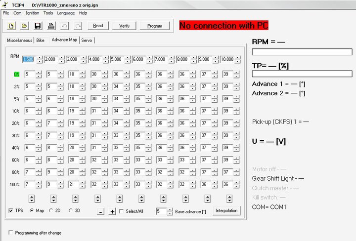

This is the stock info:
Feeler: Group buy of HRC-replica ECUs?-30665_1454003795065_1382402328_1172709_8090541_n.jpg
Rama was able to get the info and posted it in this thread (where I stole the posted chart....)
https://www.superhawkforum.com/forum...52/#post268061
As for the HRC numbers...... don't have that info.....yet

so im dumb, what do those numbers represent?
That particular MAP is that of our stock ignition advance and what the degree of advance is at any given throttle to RPM ratio. This produces the optimal acceleration for an engine (aka best performance). HRC then went ahead and created their own map with their optimal running conditions (without EPA breathing down their neck and various other considerations).
Now a pertinent question; what kind of modifications are going to best utilize this HRC map? Because that bike had a how shall we say... sizeable quantity of mods done to it, and while yes, some is good, in that same way, too much is the opposite. In other words, if this were done to an otherwise stock engine, would it cause any problems or would it otherwise help any pre-'00 engine?
And IIRC, high comp. (which I think you're running???) and high degree of advance is good because you're going to be running higher octane gas, while not everyone on the forum will be, I guess that's my main concern before I throw my name in the melting pot.
And whether it'd be okay to use with a +4FP advance. =)
Old Sep 13, 2011 | 12:43 AM
jay956, bass4dude, the posted numbers are STOCK... Ie that's what your bikes are running now...
The HRC data is for now non-existant... The data still needs to be extracted out of a HRC box...
As for what it does... It advances more on lower RPM, so there will likely be some gains on a bone stock engine, but at the expense of fuel mileage... On a tuned engine, say Stage 1, the gains will be more noticable, and the loss of mileage vs stock box will probably be less... All conjecture, but rather well founded on facts...
And the good part about doing this with a programmable aftermarket box, is that once you start with the HRC numbers, you can tweak them on a dyno to suit your particular bike... And the Ignitech box has the option to select the sidestand switch on or off, and a selectable limiter... So basically, set it up the way you like...
but what do the numbers actually represent? i know its timing, is it degrees before tdc or something?
Old Sep 15, 2011 | 11:03 AM
but what do the numbers actually represent? I know its timing, is it degrees before tdc or something?
Well the way to read the chart is first you have RPM from left to right a crossed the top and then you have throttle position (from the TPS sensor) from top to bottom on the left side.
So what the numbers represent is the firing pulse BTDC calculated by looking at both the RPM and throttle position.
