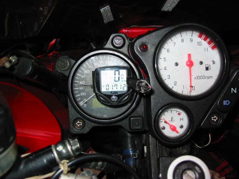

So with my re-gearing my speedo is wrong (of course). I have always wanted a digital so until I do a dash swap I am using a bicycle computer/speedo.

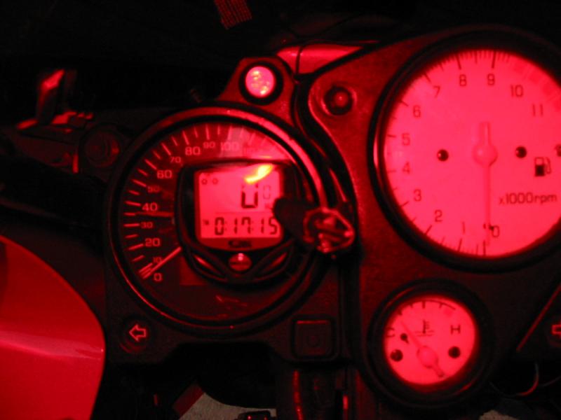

Its wireless, works great and sits right on my analog speedo. Turns out the wheel circumfrence was 1880mm in case anyone does this. I even installed an LED light wired into the dash lights to light it up red.

I'm curious can you post a pic? I'd like to see it.

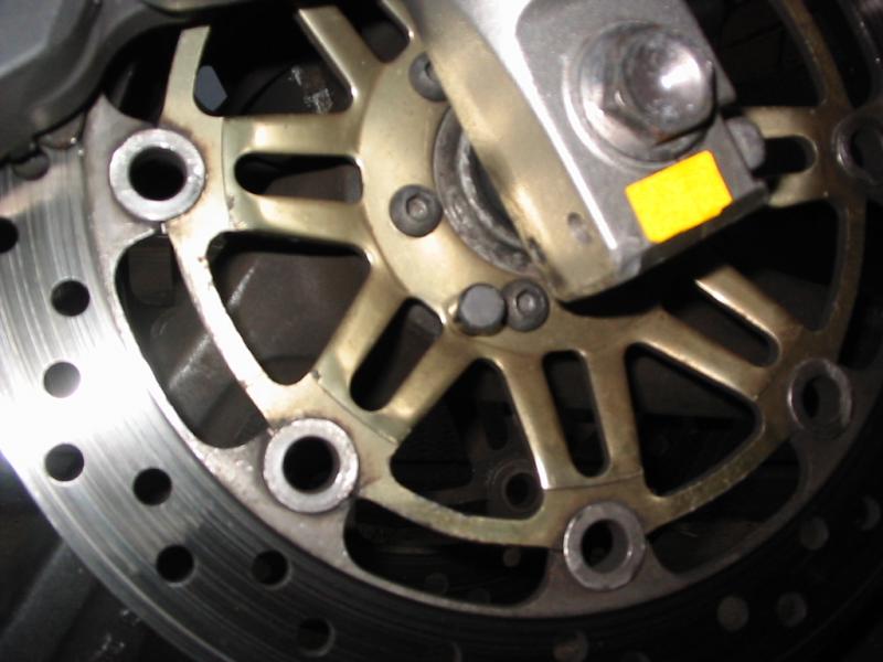

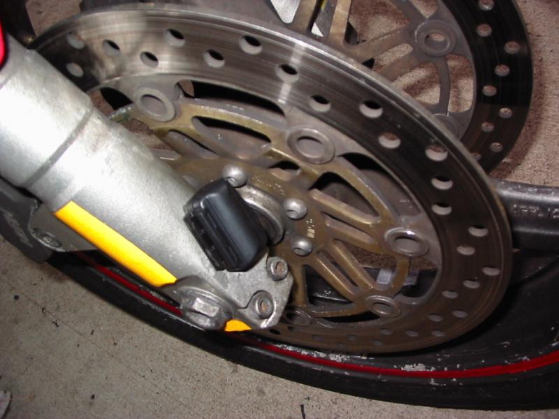

I've thought about doing this. I have a wireless bike speedo that I rarely use. Where did you clip the magnet?
Old May 19, 2011 | 08:03 AM
I will post some pics, its not quite a monsoon here today. I mounted the magnet to the disc carrier. The unit is wireless so that simplified things.

Some pics. I made a video but have yet to figure out how to youtube it.
Its actually strange to know my actual speed.(I havent for years). Usually kind of superfluous info since its more "go survival speed" than care but on out of city rides its nice.
