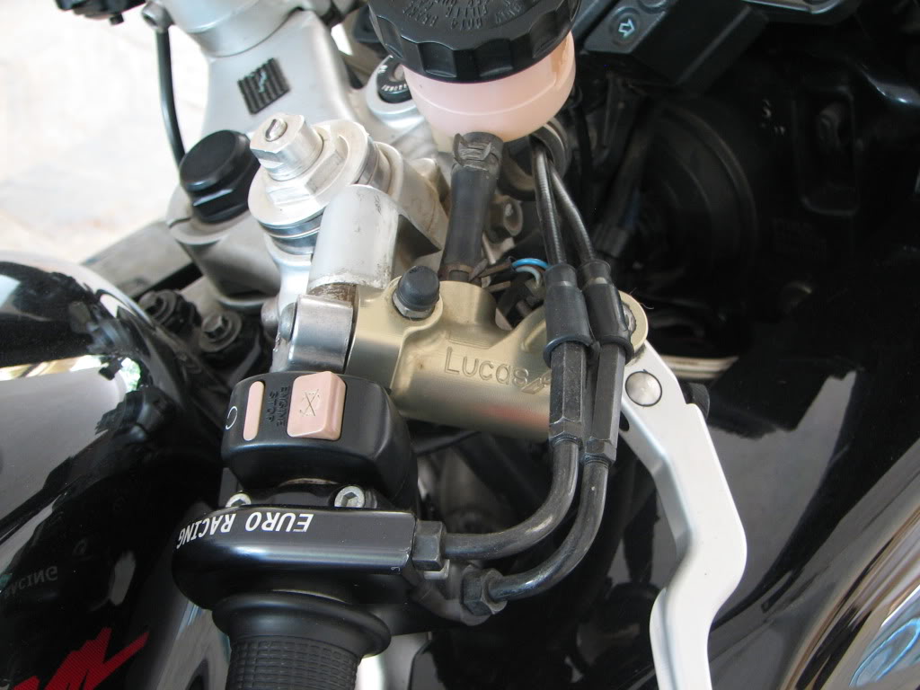

Some hints, front brakes are 6pistons calipers from gsxr 1000 02. Pump is lucas.
Same , lucas pump for the clutch, works very soft.1/10 the pressure on clutch lever compared to stock.

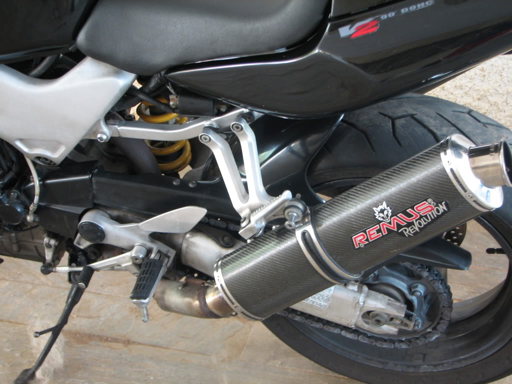

Mufflers are upward tilted like the sp"s. Sp1 are the rear footpegs brackets.
Rear fender is from cb 1300 if i remember correctly.

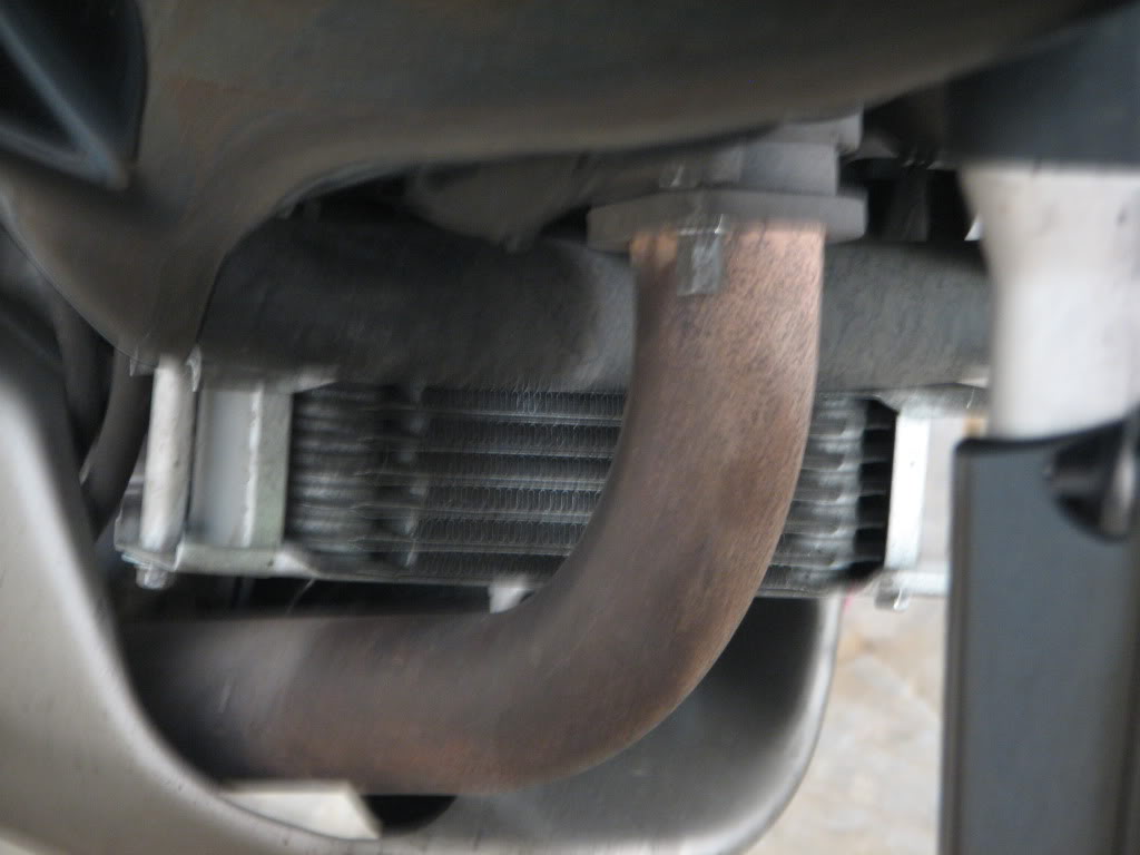

Oil cooler is from somewhere in the us, larger than the stock, and placed where it is like moriwaki does.
