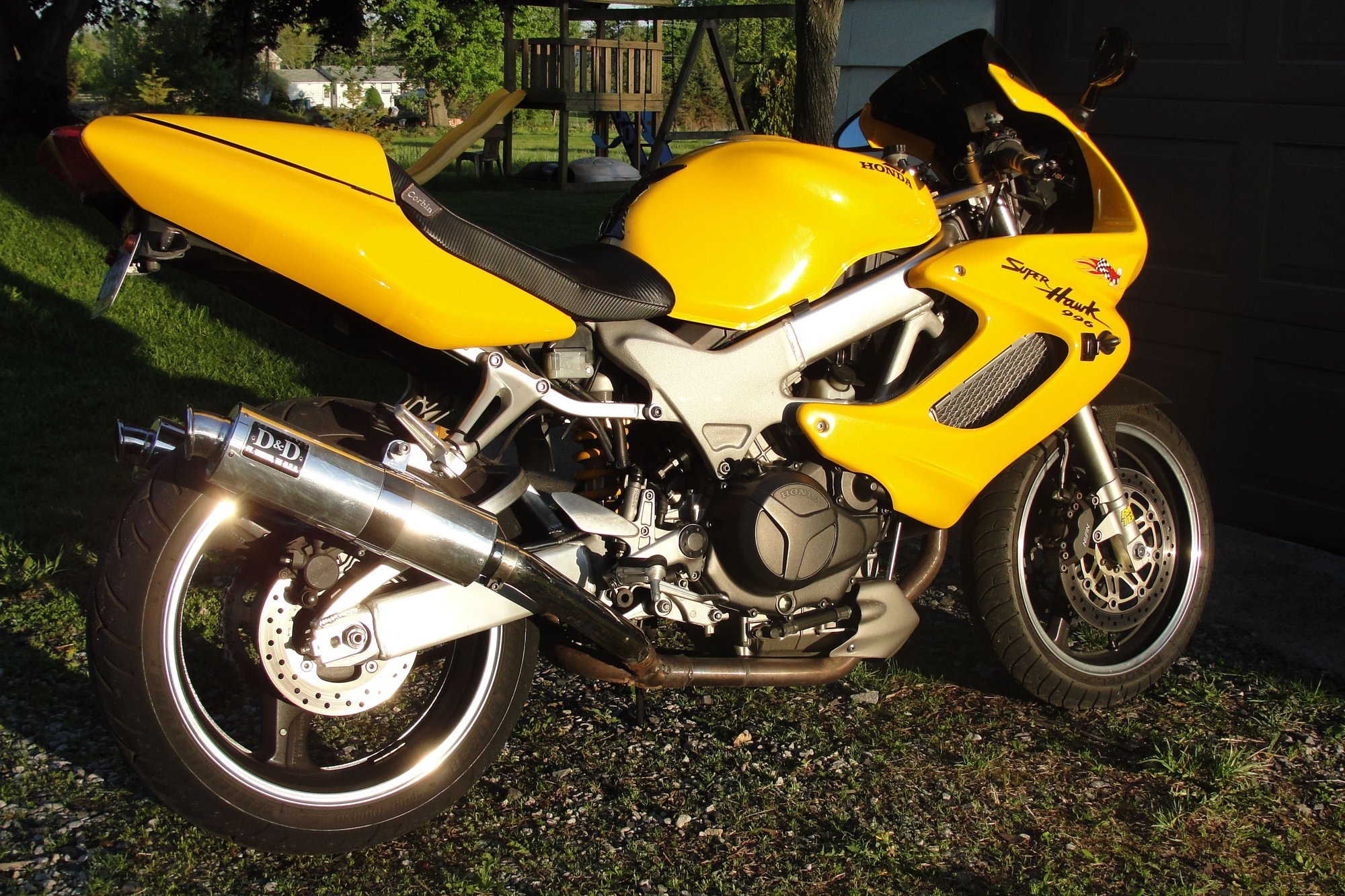

Old Sep 4, 2022 | 05:16 PM
I shortened my D&D's and the quality of sound was excellent. Not obnoxious at all.
Looks really good! Out of curiosity what was the length you cut them to?

Old Sep 4, 2022 | 07:36 PM
I’m not saying they weren’t loud, but definitely not obnoxious.
Was 6” off.
Old Sep 5, 2022 | 07:11 PM
