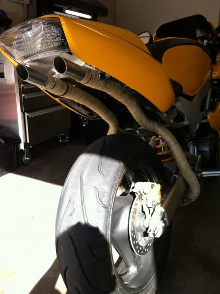

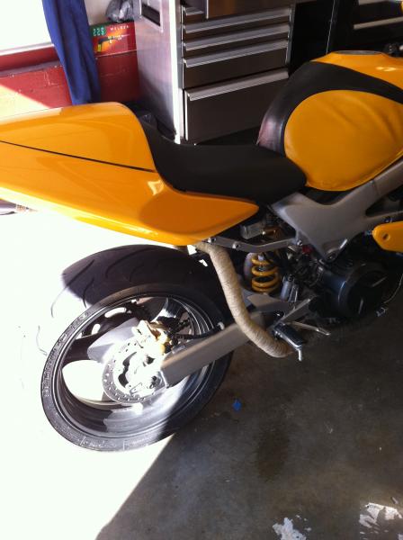

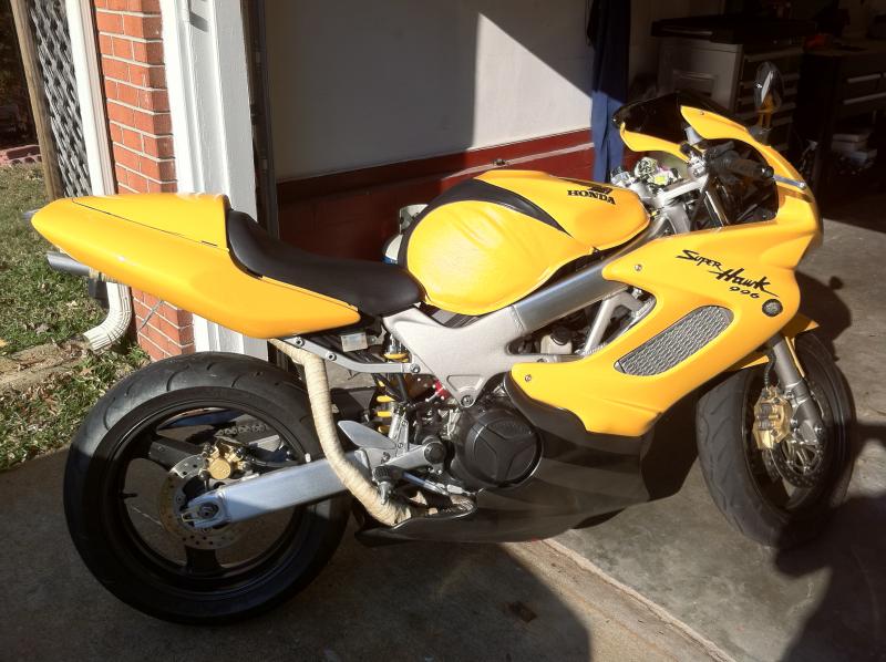

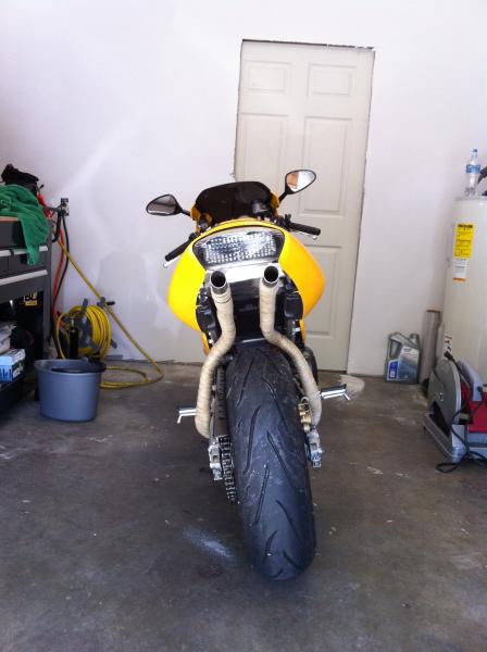

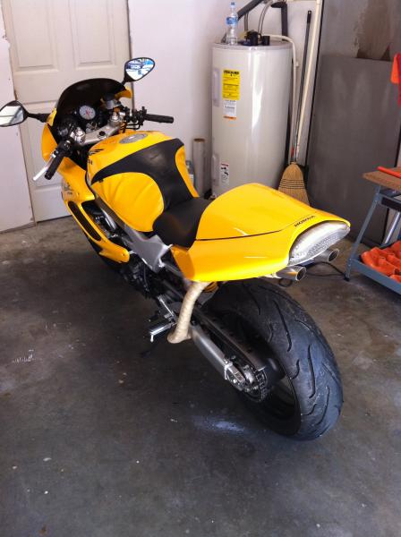

Here are some finished pics of the project. Sounds great with the race baffles and looks and feels great as well. Thanks!

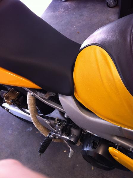

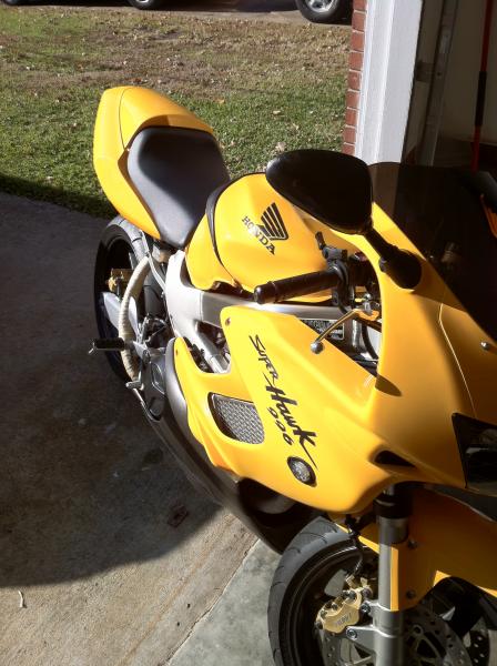

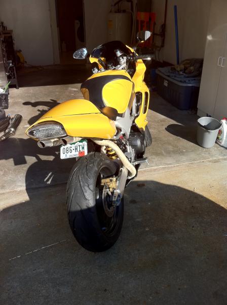

more pictures..
Attached Thumbnails Creating Custom Exhaust..Inputs?-012.jpg   Creating Custom Exhaust..Inputs?-013.jpg   Creating Custom Exhaust..Inputs?-015.jpg

how is that temperature safe for anything that is around it?. taillamp only needs 200° to pull the glue apart. and ive seen some nasty burns from awkward chopper **** postions
Ive been riding in 40-70*f temp ranges since completion. Using the exhaust wrap and wrapping the undertail assembly with some exhaust shielding tape I have not had any issues with any components. As stated I replaced most of the undertail assembly with sheet metal so the plastic will not melts. And continued that sheet metal up under the tail light assembly. The one thing I have noticed was every once in a while when it is cold out my taillight fogs up due to the moisture coming from the exhaust.
Couldnt be more satisfied guys.. For someone who has no skills bending pipe and fabrication I cant complain. Used a nice 90$ mig welder from harbor freight and 16 ton pipe bender as well..

Have you looked at my pictures and clearly see that my bike is registered in Colorado?

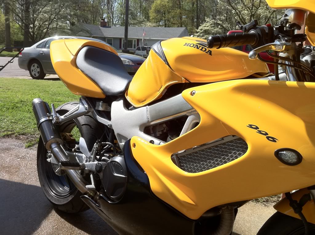

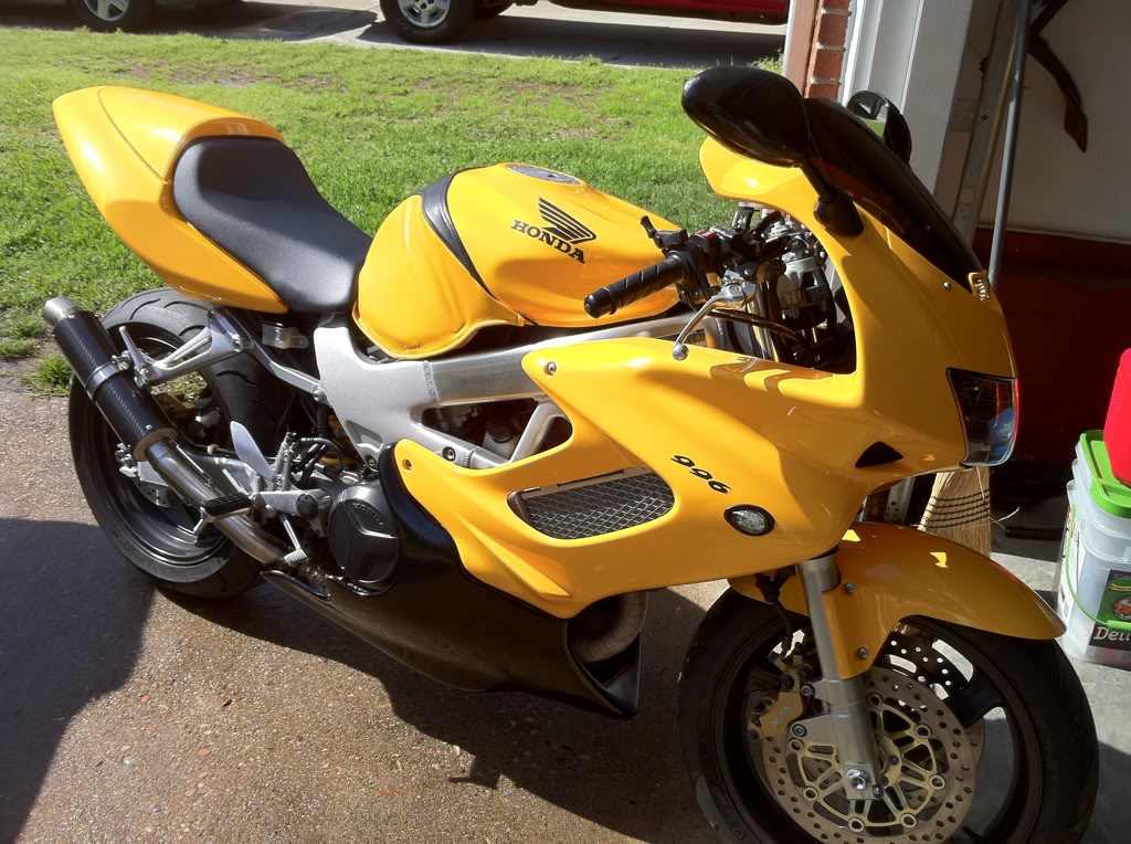

Welp ditched the custom exhaust. Anyone who is interested in doing this more power to ya. I just felt like I was driving a drag bike around for the most part.
Went with a Dan Moto exhaust and my wife couldnt be happier. Now she gets to ride again.

Thanks for the compliment! Yeah I love it. Looking forward to warmer weather again. The turn signals were purchased on amazon for $15. Not sure if they are still available but you can probably still pick some up. I adapted my old signals to fit these. Works great.
Amazon.com: Motorcycle Smoke LED Turn Signal Marker Blinder Flush Lights In Side Mount for Honda CBR 900 929/954 600 900rr 03 04 06 07 08 924/954 F4i: Automotive
The under-fairing came with the bike when i purchased it used back in 2004. So not really sure but its fiberglass. Hopefully they still make them.
Anyways I really like the sound of this Dan Moto exhaust. Perfect price for what it is and is throaty.
