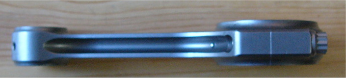

Pics (sorry if they are not perfectly clear....)
Attached Thumbnails Carrillo rods arrived!!!!-carrillo_and_oem.jpg   Carrillo rods arrived!!!!-carrillo_side.jpg   Carrillo rods arrived!!!!-carrillo_top.jpg

LOL, aww, they're so short! Man they're beautiful aren't they. The stock one's look like something you would use to dig a hole with..
