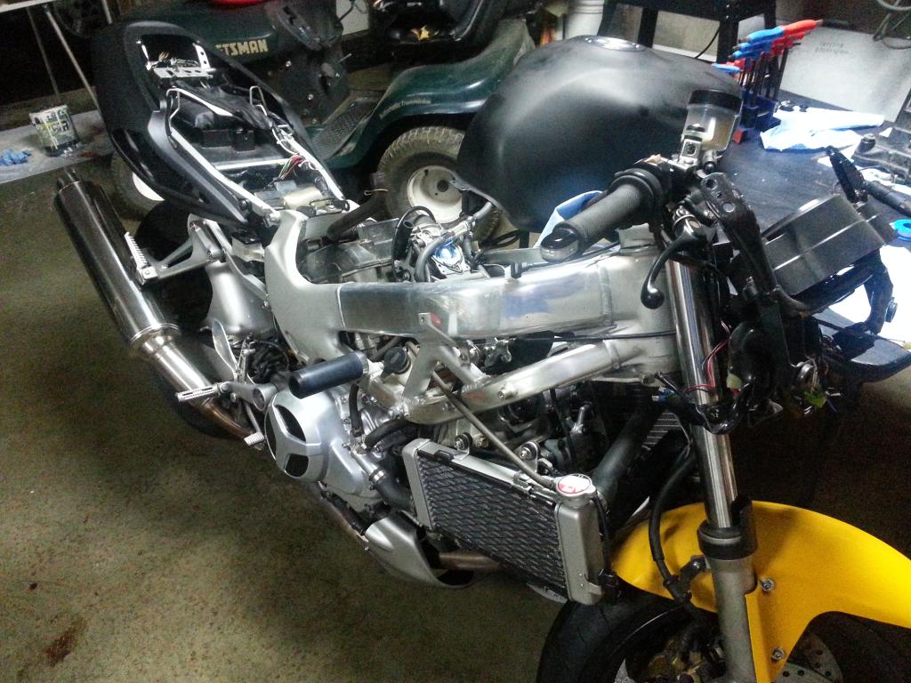

Old Jun 29, 2014 | 08:58 AM
  #85
Oops. Work has been very busy and I forgot to post this.
I got the valves shimmed. What was wierd, was just the front head exhaust cam was out of spec. It was exactly .100mm to much. That might have been the clicking/metalic noise I was hearing in the front head.
I should be able to get my carbs back in place and continue testing after July 4th.

Old Jun 29, 2014 | 06:20 PM
  #86
jerryh's Avatar
Posts: 972
Did you polish the frame Mat?
Old Jun 29, 2014 | 06:23 PM
  #87
jerryh's Avatar
Posts: 972

Front exhaust valve or lobe...any signs of wear (out of the ordinary)? Tenth is huge
Old Jun 29, 2014 | 08:55 PM
  #88
I think the previous owner polished, or tried to polish the frame. I didn't keep it up, because it's getting powder coated black anyways.
Yeah, .1mm is quite a bit. I have a few theories why it happened, but I'm just glad it's back within spec.
I also put my stock coolant bottle back in, just to see if there is any change with the cooling system (the overflow tube is really short for some reason). I haven't taken it for a ride yet, but I am assuming it will be just fine. If all is well, I will have a "kit" available to relocate the coolant bottle in the classifieds for those that have Jack Flash's fuel screws.
