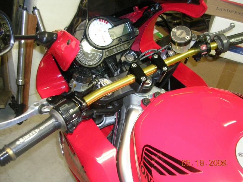

I tried Heli bars before adding superbike bars and the Helis were better than stock, but IMHO as far as comfort goes you'll have a hard time beating SBBs.
Attached Thumbnails anyone go from VFR bars to superbike bars-dragbars2-30%25-smaller.jpg

Anyhow... FL02SupaHawk996, how much did you trim on the fairing. I can't tell by the attached picture...I'm this close --><-- to going with a bar conversion. Thanks -- R.
