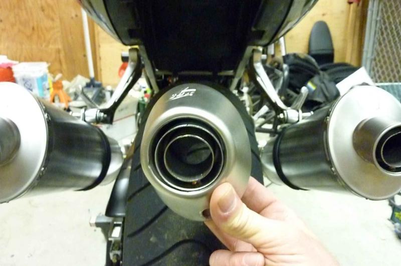

Well, I can tell you that when I fitted my new Leo's they did EXACTLY the same thing, and I couldn't have that.
Read my post in this thread:
https://www.superhawkforum.com/forum...t-ideas-28619/
What I did to fix it? I called Leo Vince factory, and told them what is going on, and that I was going to send them back due to "birds chirping in my exhaust on deceleration". They said they never heard of it happening before. So I googled "Leo Vince odd chirping noice on Decel", and got this;
1100GS Exhaust - ADVrider
and this
Exhaust noise bugging me.
and the list keeps going on...
So if you read the above thread what cured it was I ordered the conical end caps (Paid Xtra $60.00) with a larger dB killer and no more chirping. Size difference not much, 1.9375" to 2.125". Not sure why the other end caps do this but I assume it is because of the flat shape of the end of the muffler and the curved spigot creates a odd exhaust resonance that the conical end cap and slightly larger straighter dB killer does not.
Anyone ever heard exhaust do this? w/ video-leo-conical-w-quiet-insert.jpg
Anyone ever heard exhaust do this? w/ video-leos-w-conical-ends.jpg

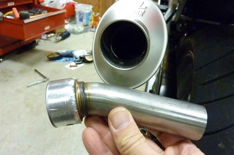

I didn't mention that before I replaced the end caps, I did take some Aluminum tape, (see photo below), and wrapped enough around the dB killer O.D. before inserting it so that the fit was t-i-g-h-t. It helped but did not completely cure it, before I replaced the end caps. (I also wrapped those).
Anyone ever heard exhaust do this? w/ video-leo-quiet-insert2.jpg

You can try the aluminum tape first, but yes you have to drill the rivets out, when replacing the end caps. Just make sure you have a good drill bit intended for stainless rivets and its a breeze. The conical caps and new dB killers come with new rivets. I made sure the strap overlaps at the bottom of the silencer just for a cleaner look. I like the look of the conical caps better anyway, but yea not free for sure. The others should not make this weird-*** bird chirp to begin with IMHO.
