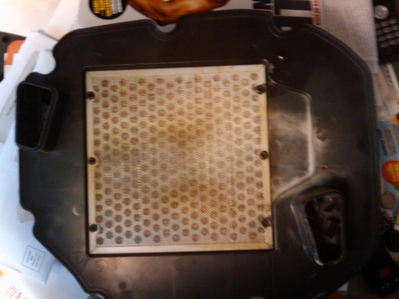

Old May 28, 2011 | 06:55 AM
superh1998's Avatar
Joined: Mar 2009
Posts: 182
From: chicago
OK,
I took a look at the filter this morning, and I am not sure what type it is.
It is definitely not a K&N (those have separate block offs for the small filters). I don't think it's a BMC filter, but it does have the built in block offs like the BMC.
The only numbers/letters on the filter are "H61 HM-MBB".
I do not have the small foam filters that go in the airbox, since this filter obviously blocked them off.
Maybe someone else can help identify this filter?
Let me know if you still want the airbox/velocity stacks/air filter.
Thanks,
Mike
Old May 28, 2011 | 12:14 PM
MBB in the part number..... Factory Honda part.
You better pick up the small foam filters and install them unless you want to buy a new set of carbs sometime soon..... yes they are that important.
Old May 28, 2011 | 02:10 PM
autoteach's Avatar
Posts: 1,611
From: Belgium, WI
Agreed Hawk,
They damp the slide movement and not having them leads to premature...needle jet wear. I had to buy a set of carbs due to this (didnt know they deteriorated and disappeared).
Old May 28, 2011 | 03:03 PM
superh1998's Avatar
Joined: Mar 2009
Posts: 182
From: chicago
Thanks guys..I had no idea what it was..this is from a parts bike that I picked up a while ago.
Old May 28, 2011 | 04:03 PM
No, this does not "block off" the small foam filters... They are still needed...
When people are talking about the K&N having separate "block-offs" or the stock filter having them integrated, they are just confusing themselfes and others... Those chambers are not blocking anything...
The airbox have an inlet in the bottom, at each corresponding part... The air passes in there, through the foam filter that sites between the airbox chambers, and these chambers, making a loop in the chambers, down into the hose connected just half an inch beside the inlet... These small chambers keep the airbox and the carb vents separate, making for separate pressure... No separation means a bad running bike, and no filter on here means the carbs will literally self destruct...
Just hoping to clear up the confusion for some people...
