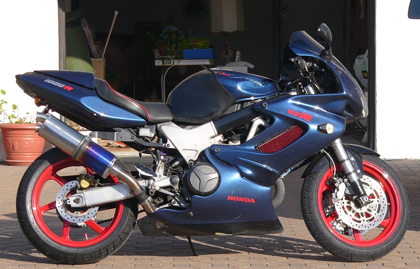

I have PVM cast magnesium 6-spoke wheels I picked up on eBay. The front needed to be straightened slightly and I had them powdercoated red. The result: fantastic. The bike turns in much quicker, accelerates harder and generally runs better in every respect. The only downside is I have to be even more on the lookout for potholes, not an easy thing to do in Quebec.
Wow your setup looks pretty wild. Wheels look good on there....
