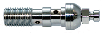

I was thinking of these banjo bolts from Venhill.....I usually wind up cracking open the fitting on the MC, which is crude and messy, but works. Not sure if this one is different from the speed bleeder fitting. I'm getting some of these fittings to try out. I'll let you know the results. I can also get custom sets from Venhill, which ever hose, fitting combo you want, to your lengths.

The bleed banjo bolts are supposed to be the ticket, but I'v never used them.
