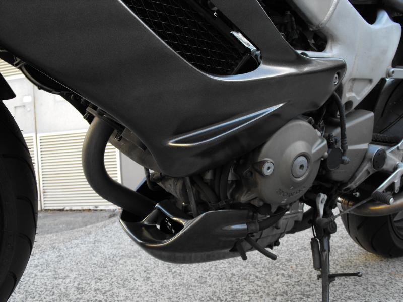

I'VE PAINTED MINE 2-3 TIMES OVER THE YRS. KRYLON WORKS PRETTY GOOD. THIS IS THE LASTEST VERSION.

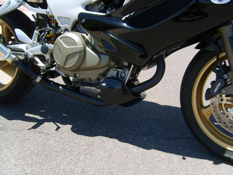

Krylon Fusion gloss black:
Attached Thumbnails Who's painted the little belly pan fairing thing?-vtr-002.jpg   Who's painted the little belly pan fairing thing?-vtr-005.jpg
Looks great bro...!
Nice header, too!
Ceramic coating?

Originally Posted by chickenstrip
Nice header, too!
Ceramic coating?
The header was painted with high heat, stove black paint. Rattle can.

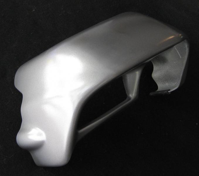

I painted mine with spray cans,matt black under coat,metallic charcoal base coat,3 coats of clear.
Attached Thumbnails Who's painted the little belly pan fairing thing?-2009-06-12-11-17-04_0030.jpg
