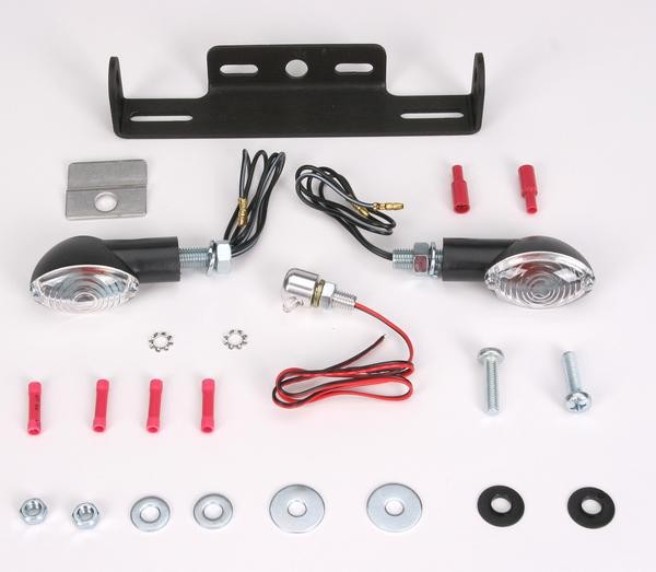

Ok cool. I think I am going to buy that under fender piece.. it says it does not fit a 98 but I think its wrong. I have a piece that I ordered on ebay that is metal and has a tag light on it. I do not see how this works together with that fender piece..
well,the problem with this piece is,it wont work with the under tail you have.
it is made to fill in the hole where you would cut off the plastic on on the stock tray.
you will need something like this to bolt it up to the undertail.it will hold the blinkers,tag and tag light.

are you talking about the tag bracket kit pic,
if so,that will go on most of any after market under tail.either have to drill holes or line them up with holes on the under tail.will have to have a 3rd hole to run wires to signals and lights.

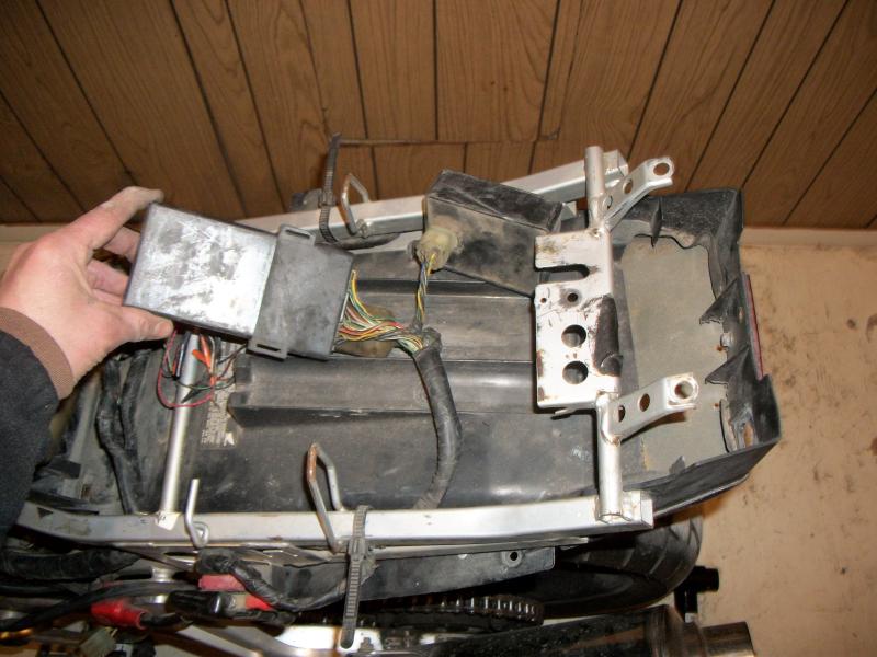

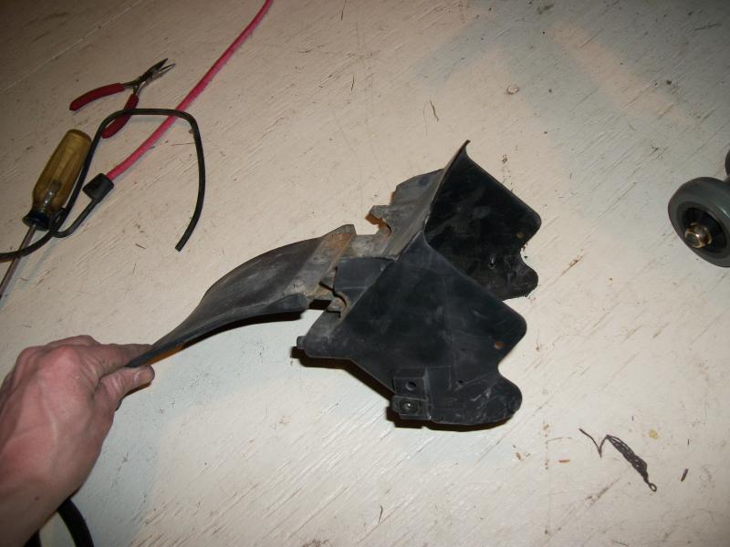

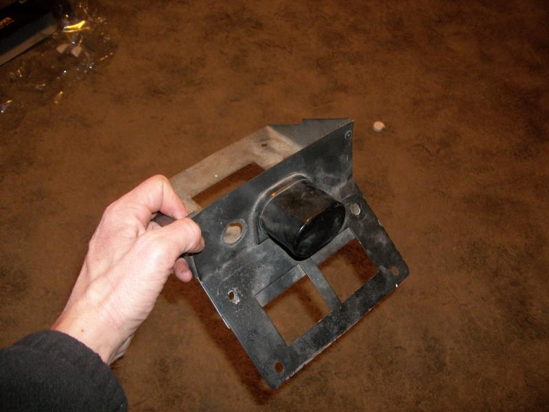

I already ordered the stock under tail. I dont care about that aftermarket one that I have. I will put it on ebay if I get everything else right. I wouldn't mind going with a KIT but I can't find a good kit anywhere.
Anybody know what where this piece bolts on?
Old Jan 26, 2014 | 07:19 AM
  #38
It looks like a home made piece. The way you are holding it in the picture, lift it straight up to the very back of the tail. Not sure how it mounts though. Looks like that black oval thing holds a light which shines on the license plate. The license plate is placed over the two rectangles. Understand? Thats the best I can come up with, without seeing it in my hands.

Splika is on a distinguished road
yeah its the license plate and tail light bracket. I just don't see how or where it would fit. it lightly says HONDA on the back. Has the spot of the seat lock. Also has the spots for turn signals. I just haven't seen any pictures on a bike. I guess I will find out more when my fender comes in.

Ah, that's right, you don't have the stock plastic piece under your tail. That's why you can't see it. I'd assume that it would attach to the stock plastic piece.

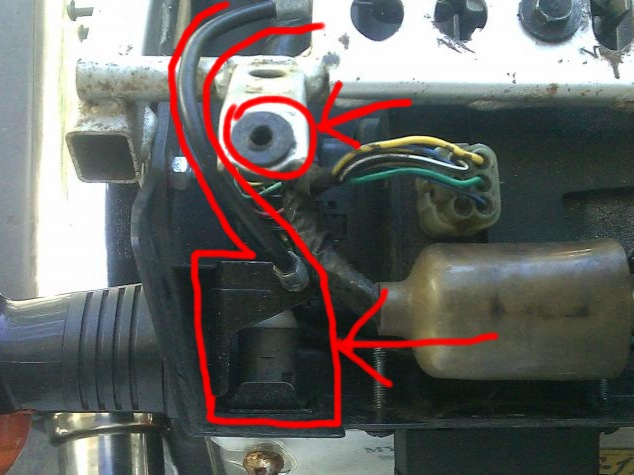

Splika, in a thread that turned up in one of my recent searches, I saw the metal license plate part w/light you have. Click here.
Old Jan 28, 2014 | 05:35 PM

Yep! That's it. I hope that under fender has a spot to bolt it to. Still kinda hard to tell but at least I have an idea! THANKS!!!

Also he stated in there that it was an aftermarket plate holder.. I was told it is stock. That may be the difference between the VTR1000F A and the VTR1000F AC models...

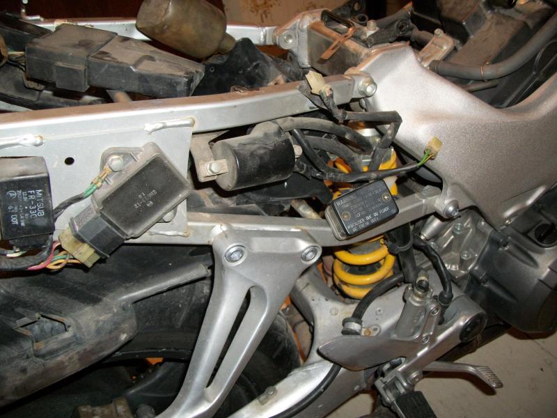

On another note. My part came in today. Came in great shape. Unfortunately someone has cut the very end off and altered it a little... The license bracket I have does not fit on there...dam it...
Old Jan 30, 2014 | 04:19 PM
  #51
saige's Avatar
the boss

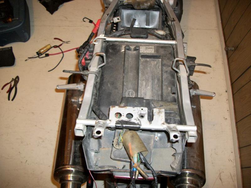

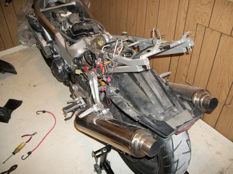

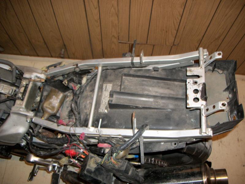

As I promised... Pictures!
Under Tail Fender.
Was kind of a pain to get it in there but not bad. Had to unplug everything to get the wires out of the way. So much better knowing my electrical is safer!
Attached Thumbnails Show me your rear end!-100_1018.jpg   Show me your rear end!-100_1019.jpg   Show me your rear end!-100_1020.jpg   Show me your rear end!-100_1021.jpg   Show me your rear end!-100_1022.jpg

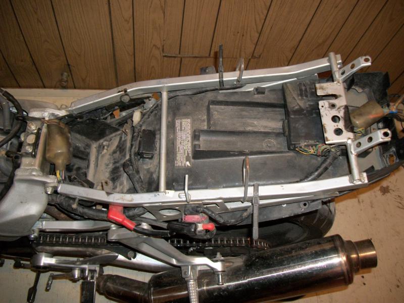

Under Tail Fender.

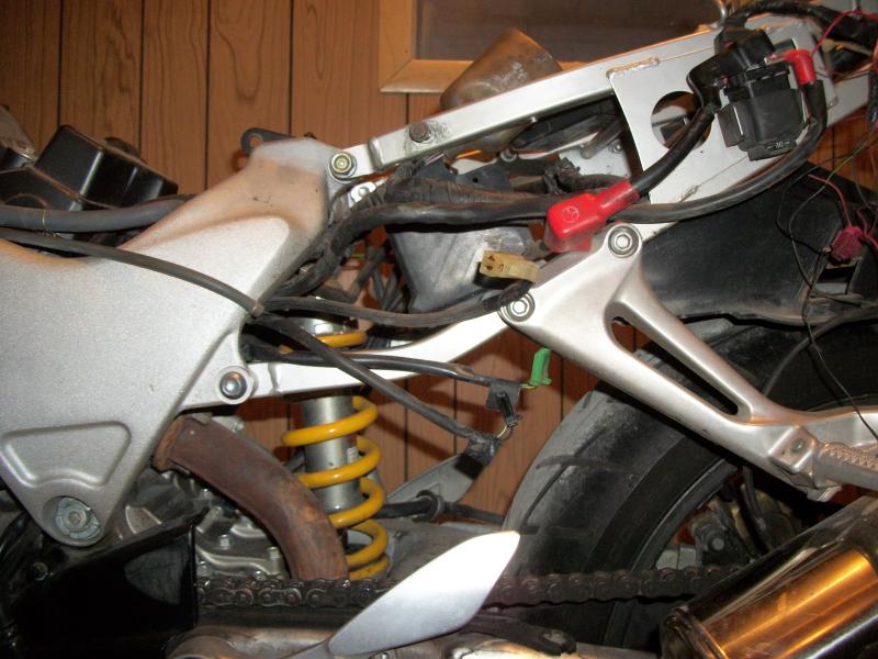

I got everything plugged back in. Ran wires where I thought they should go. Moved everything to the rear. Looks much better!
Attached Thumbnails Show me your rear end!-100_1024.jpg   Show me your rear end!-100_1025.jpg   Show me your rear end!-100_1026.jpg   Show me your rear end!-100_1028.jpg

This is all that was left of the stock fender... Just the battery box and mud guard.

I'm not sure if I put everything in the right place but I gave it my Best Guess!

Looks pretty good. It is pretty hacked up but you may be able to get it to work and look good. Much better having the majority of the factory undertail to hold everything in place.

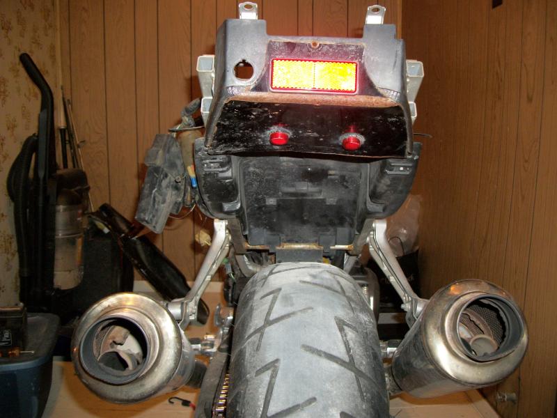

Splika, don't be suprised if the mods move all this to its own thread. You kinda took this one over!
Looking at the pictures you took, it looks like your subframe is tweaked a bit. The back looks kind of low on the right side. Maybe it's just the picture, I'm not sure.
However, if it is, I had the same issue with my subframe. Mine was twisted just like yours and the plastics wouldn't line up correctly and the seat wouldn't lock properly.
I took a string and ran it down the centerline of the bike, then using tie downs I was able to get the bike perfectly plumb (perpendicular to the ground). Then, using a long pipe, I was able to twist the subframe back to stock. The plastics line up great and the seat lock works fantastic.
