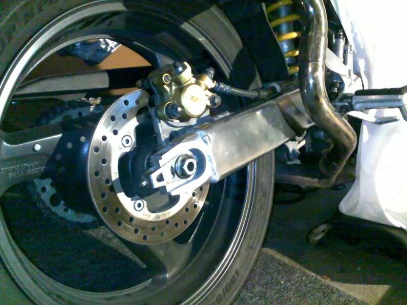

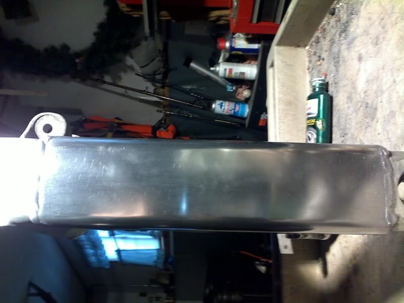

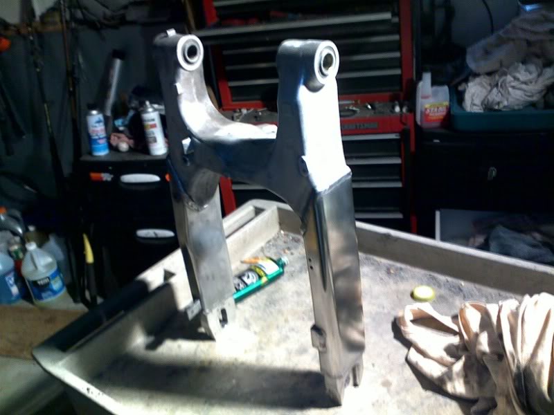

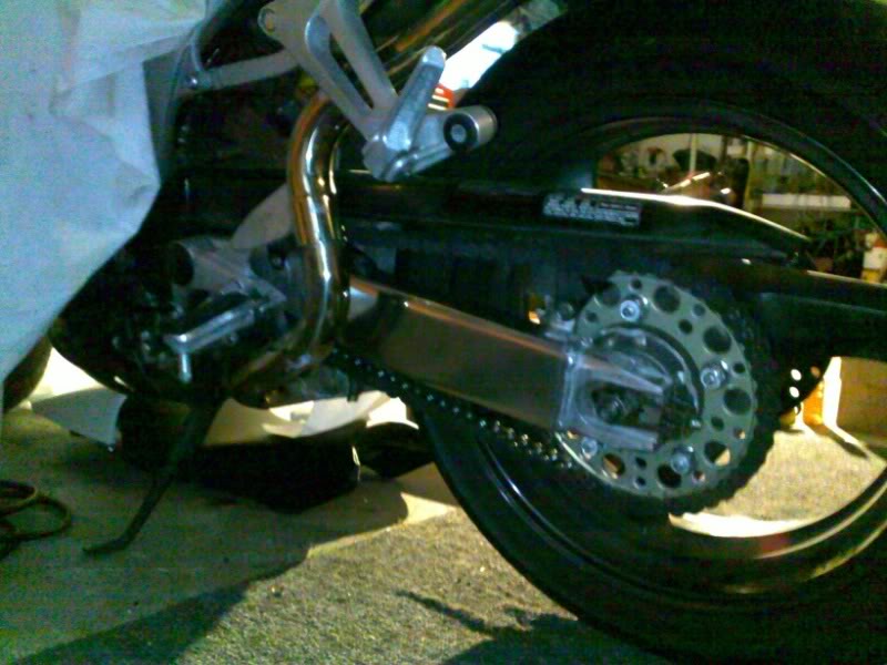

I started off by cleaning all grease/grime off this thing, then continued with a sanding wheel for all the deep pits and oxidation, then moved onto 180, 240, 320, 400, 550, 800, and then a red scotchbrite pad. once finished sanding I used some turtle wax all metal polish to give it a nice bling. cleaned up the front part a bit to a nice shine, not as polished as the rest of the swingarm though. total time was about 3.5 hours including dis/reassembly, well worth it compared to how oxidized it was before all this . Let me know what you think.

Looks good. Are you planning on doing the frame as well??

thanks, it's just a bit more polished than the frame is, plus i'm naked and it kinda clashes. so the answer is yes, I plan on it hah
