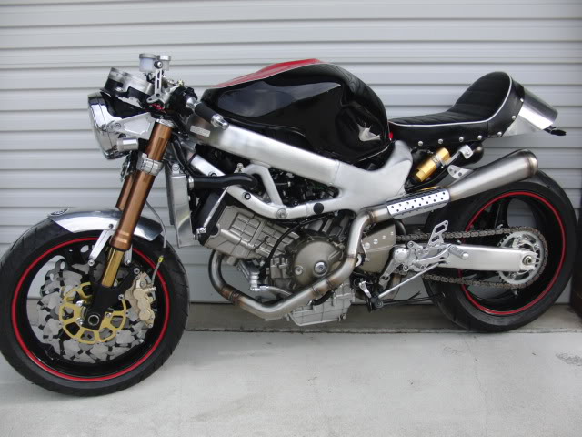

I decided to change the rad to a Suzuki SV one for better steering lock, this one runs 2 deg cooler also. Dont ask me why????

Beautiful bike Pap. Why did you choose to go with a busa front end and not stick with the VTR front end? What did you gain from that?
Old May 31, 2012 | 08:57 AM
  #157
The VTR front end is weak, under sprung, wobbly and generally gives vague feedback when riding at even a mildly spirited pace.
I really liked the performance improvement going to a 954 front end on mine gave back when I did it. I am sure he did it for similar reasons, and perhaps looks too.

I still want more details on that front end due to me getting one this past weekend. When it comes to the bearings, does he mean he used the honda bearing for the top of the tree and the busa bearing for the bottom of the tree? And as far as the wheel, what exactly did he do with the wheel? Did he use the busa wheel or the hawk wheel? If the hawk wheel, where did he come up with the spacers for it?
well if I recall correctly you call AllBalls All ***** All ***** Racing for your bearings, they will have to custom cut the top one for you, but the bottom one you can use a standard one. And if you compare that front wheel to your stock VTR one you will see that it is not the same, so I would assume that is the Suzuki one.

Yeah I'm seeing that now. I looked up the bearings for the hayabusa and the hawk and it turns out the only one that's different is the top bearing. So I'll get on the horn today with All ***** and see if I can get a bearing made here real soon. Those forks are supposed to be showing up sometime this week or early next week.
By the way, this is for any person in the future who wishes to put a busa front end on this bike, the bearing is 40 dollars from All ***** and within the next week they are ordering 200 of them specific for this swap. Mark your calender's folks. Understand that there are only 199 left out there as I have already reserved mine.

Hi Brothers of the Bike, Sorry I have been a little late in getting back to the USHF but I have been busy building a little 2 smoker I bought as a basket case. It is a Yamaha 400 and the guy had stripped every nut and bolt from the thing, threw it in a box, then left it for 3 years. I bought it a couple of months back and built another Cafe.
My wife wants some of these furkin bikes out of my shed that is why I threw the VTR1000 up on ebay, so I will see if it goes, I dont really want to part with it as its a real blast to ride!!
To answer a few questions, I used a complete Busa frt end(wheel, axle inc) I had to fabricate the frt guard. The calipers are 6 spot Busa , which slam your face into the deck when you think the brakes on.. The rotors are Chinese Ebay and work fine.
The bearings are as the other guys said, available from All ***** or just wobble down to your loocal bearing shop, then slam them on the counter with the inner and outer measurements,, simple really.

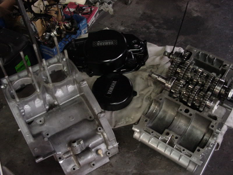

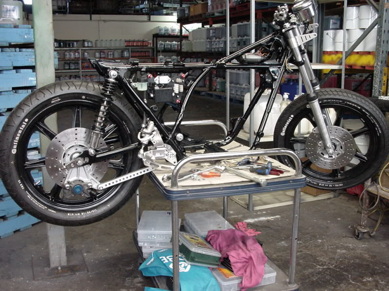

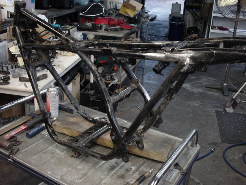

Here is the little RD400 I just finished:
Sandblasted ready for powder coat and assy

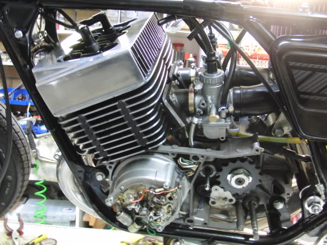

Finally,that 400 is beautiful, I just finished an R5 last year. Where did those scoops on the top of the heads come from, I've never seen those before? I would have a hard time getting rid of either bike after putting all that time and work into them.

Thanks all for the encouragement, its fun to create! The cylinder head is a yamaha item called a "Daytona" head and was used on a model released in the USA.

Has anyone fitted these rams with a K&H high flow air filter and had to change the jetting much?
I haven't used that filter but have tuned for those stacks. There are two ways to approach the issue depending on what jet kit (if any) you have used.
The issue is normally you now have a rich mid-range. So you can either go down one size on the mains (with a DynoJet kit) or plug one lift hole in each slide with a FactoryPro or HRC kit (or modified stock bits)
