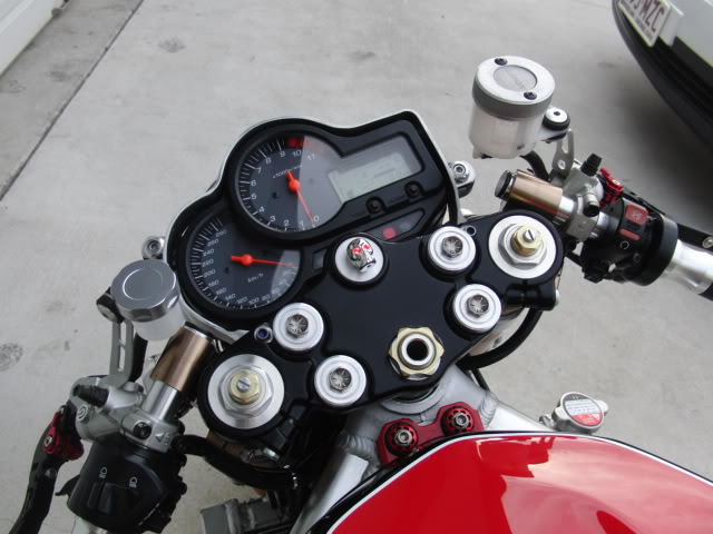

Well tonight in between Stubbies( because its Furkin HOT) I finished all the wiring to the headlight, fitted the gauges for the last time, an drilled the clip on bars to suit the locating pins in the switch blocks then Loctited everything to death.

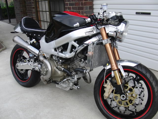

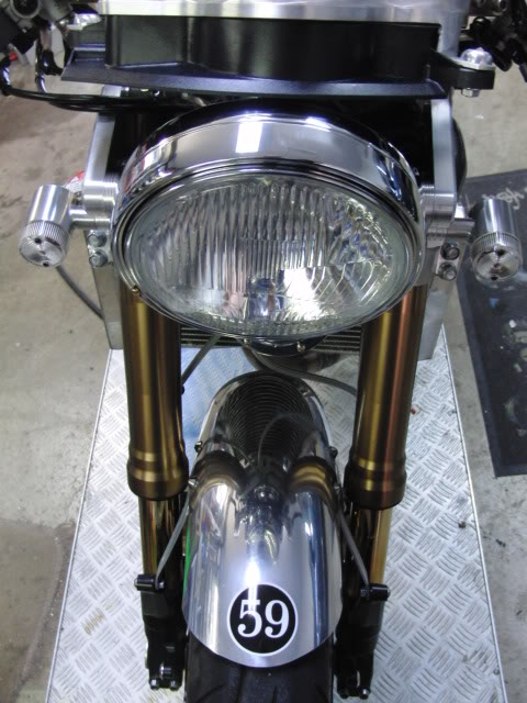

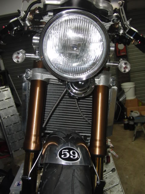

Front all wired up and obligatory "Cafe59" decal on the front guard

Pappy,
Can you give me a side on shot of the radiator to front wheel clearance?
Its just with mine with a standard RHS rad the back of the guard makes contact, but yours is shorter.
Couldn't point me to where the rad came from and which one it is for "reference"?
Thanks mate.

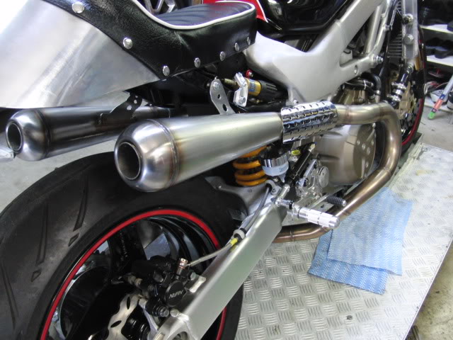

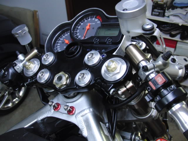

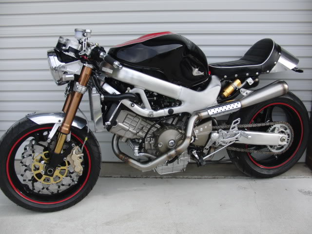

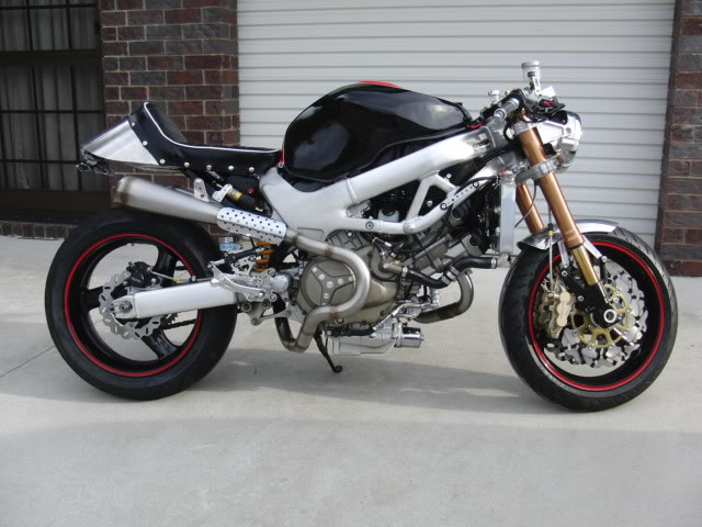

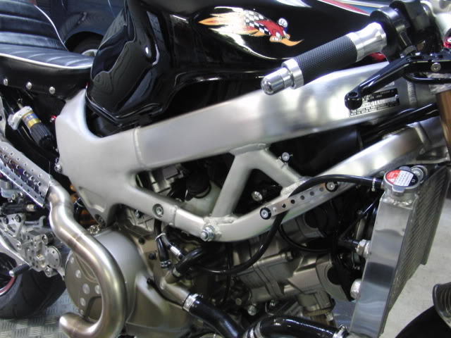

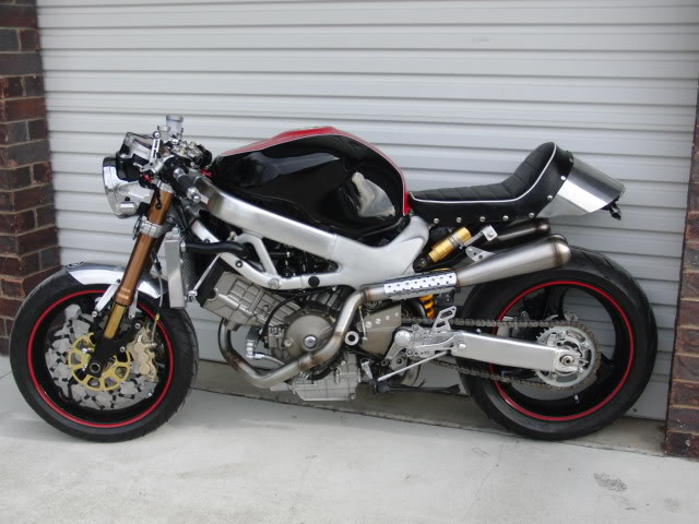

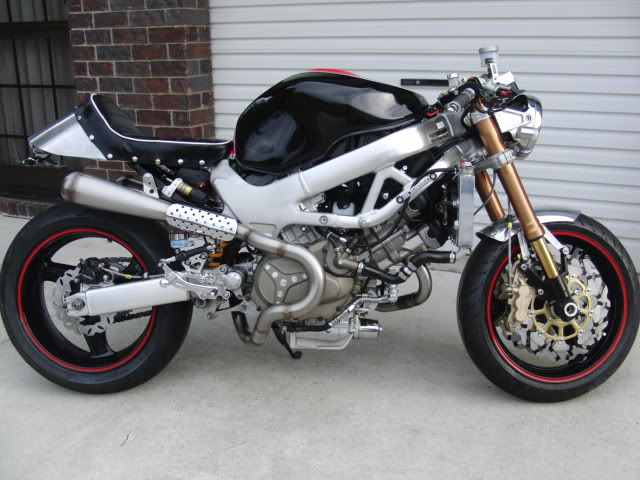

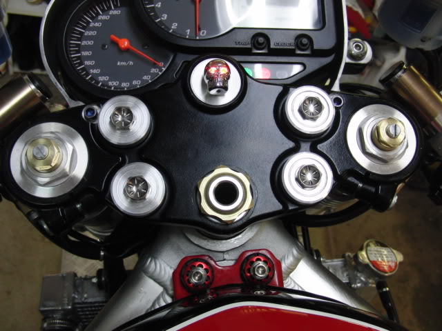

So now after 3.5 months and with only a few little things left to do, like make a chain guard and bleed the front brakes and clutch, the bike is nearly finished with just maybe some decals.. Hope you dig the skeleton eyes on the dash,,, I finally found a use for that front positioning light..Bwhahahah!!

Absolutly beautiful! Those cans are very cool looking. Job Well Done!

  #129
Those tank bolts are cool... where'd you get them?

Originally Posted by BBB
Pappy,
Thanks mate.
Radiator from China mate
Ebay Item # 270790871467
Try here mate.
Factory Washers kit -CRF250, CRF450, KX250F, KX450F, YZ450F, DRZ, Banshee, RMZ | eBay

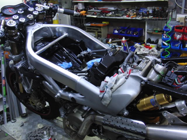

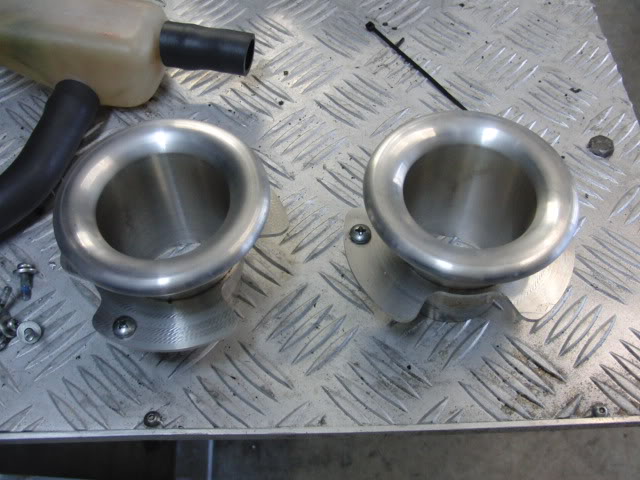

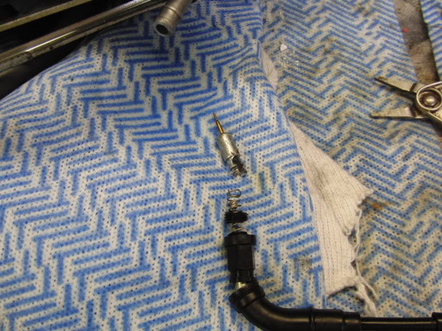

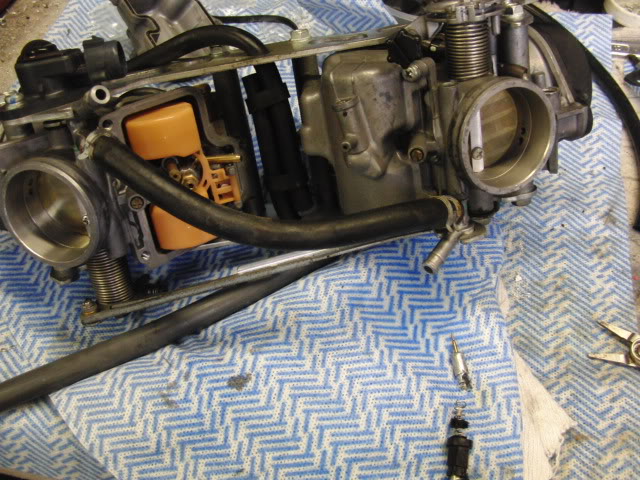

Well after completing most of the bike I was ready to fire it up, so I cranked her over and it ran like ****, seemed like a fueling problem. So I went about pulling off the Carbies and found that the front cylinder choke plunger had broken and siezed in the carb. Now I will either have to make the part or get bent over by Mr Honda`s parts dept.

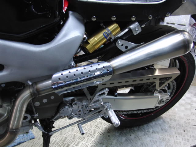

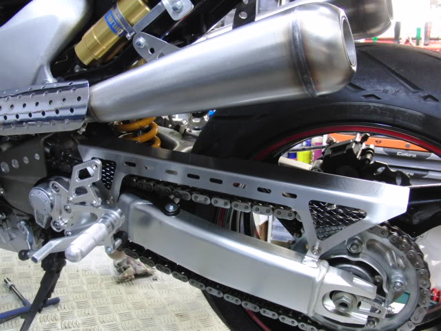

A mate of mine who has a metal folder and a lazer cutter whipped up this chain guard for me in the time it take to drink 2 beers... Gotta love those expensive tool shop toys!!!

That thing gets broken by everyone.
With a little modding (don't quote me, but i think that I had to drill out some threads and put a stop-washer in) you can get this brass polaris scrambler one to work:
SKU: 3130199
Old Nov 18, 2011 | 01:09 PM
  #145
Yep, I tried to make an AL version of it in the mill, but for the $ that polaris one is the better deal.

I have a full choke cable assembly if you want it....

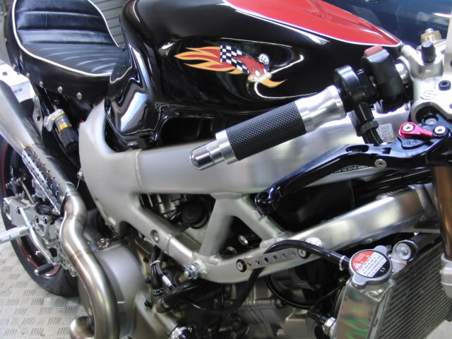

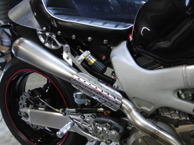

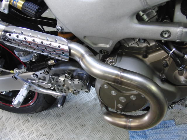

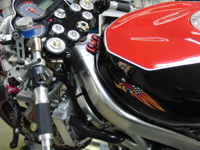

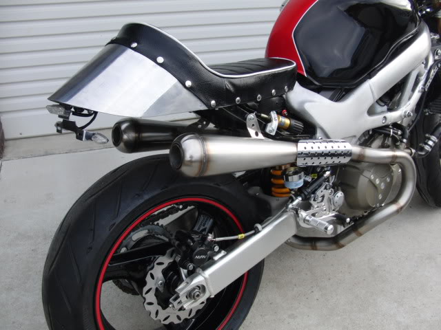

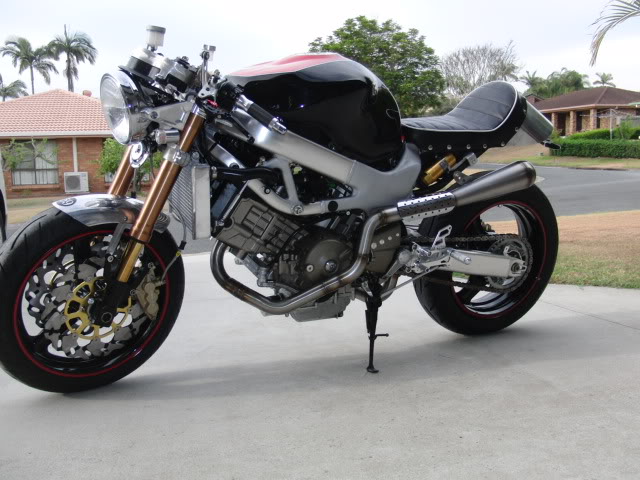

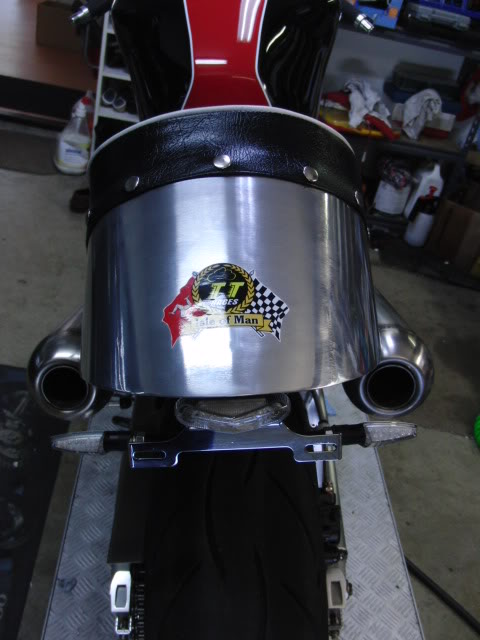

Put some decals on now its back together again and took some close ups.

Been for a couple of rides on it now and with that front rad my temp is around 75-85c. So what do these things run at with the side rads normally?
