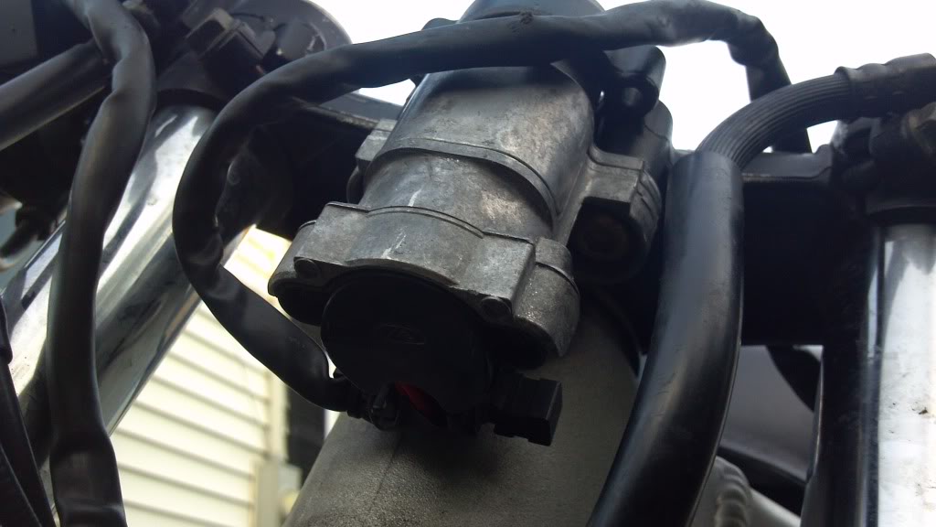

question about the ignition switch... how do i get these out

To remove those ignition screws you have to take the top yoke off and use a torx bit. I used one that is just slightly bigger and tapped it into the bolt and they unscrewed with ease.

You know what PFM is? Seriously though, take to top triple off, get a goo drill bit, and drill the head off. The use vice grips to take out whats still in there, and replace with allen head bolts.

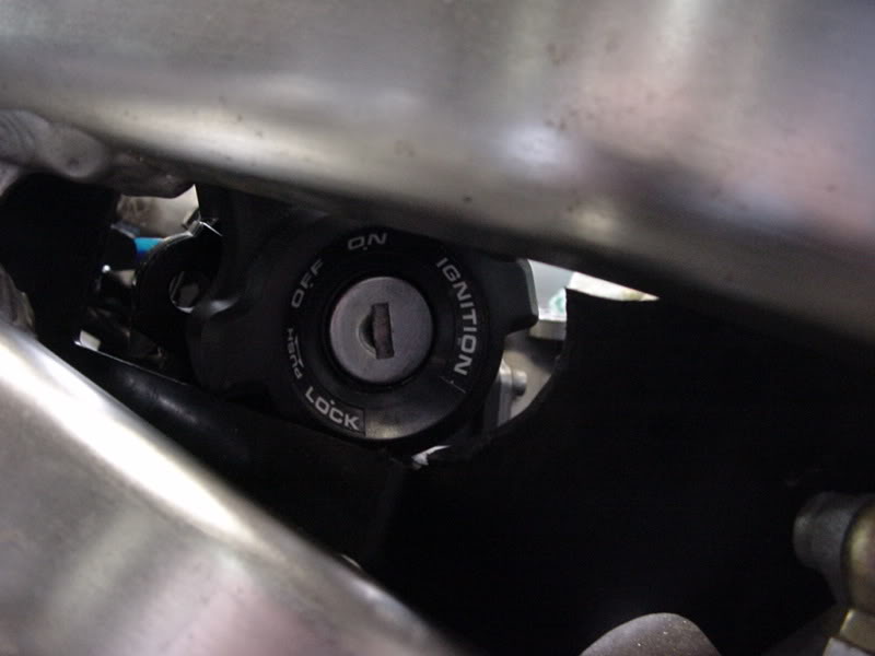

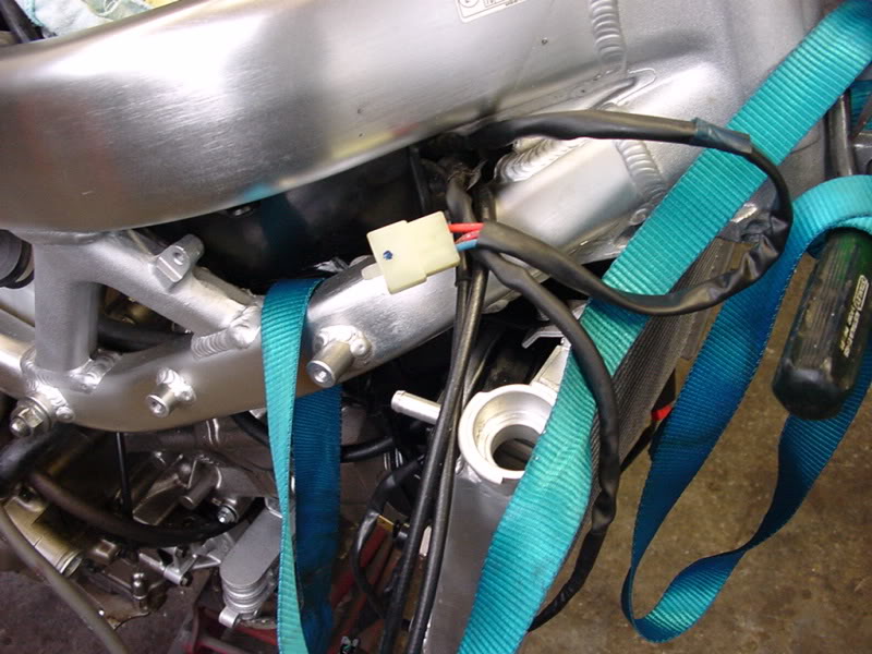

Well after deliberating for a day and a bit to ponder on where the *** I could put the ignition switch and the key identifier, I found this void in front of the airbox where the lot fitted neatly and only needed a firm hose clamp to hold the lot in place... I did sacrifice the steering lock option.

The looms come out the same exit as the throttle cables.

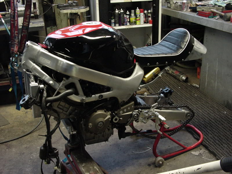

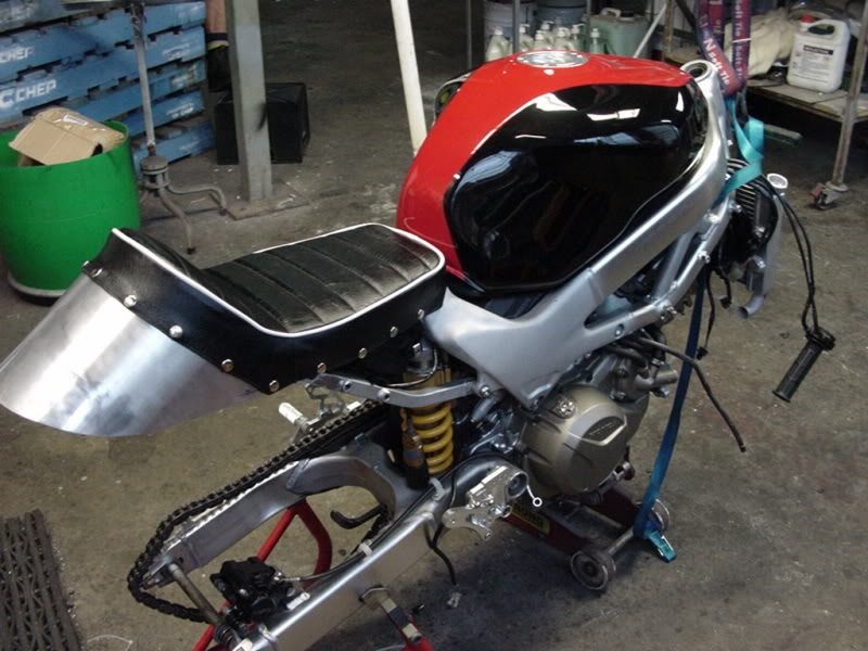

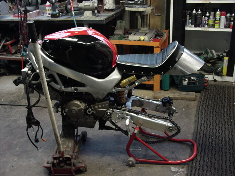

Got the seat back from the upholstrer today.. getting closer now

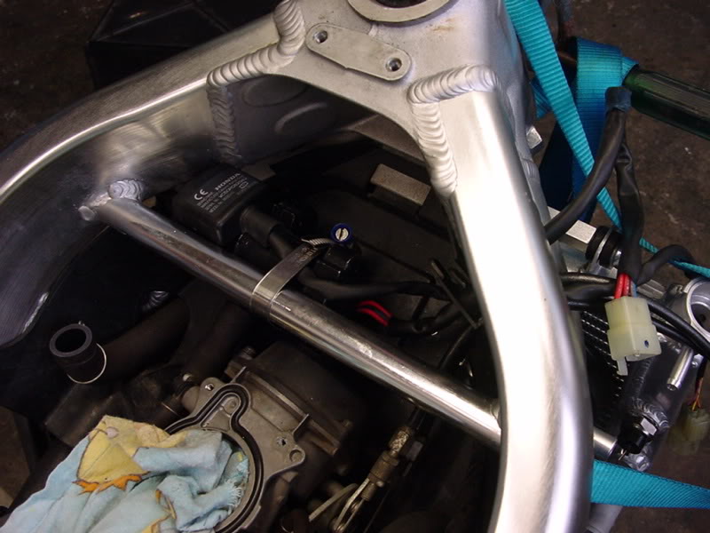

Looked around for a thinner fan than the standard VTR one and discovered that the Yamaha R1 thermo fan is much,much flatter so not having a lot of room between the rad and the head , this worked out perfectly.

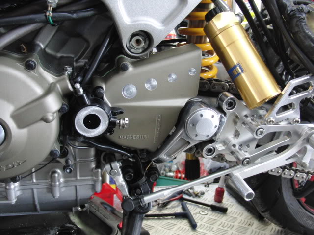

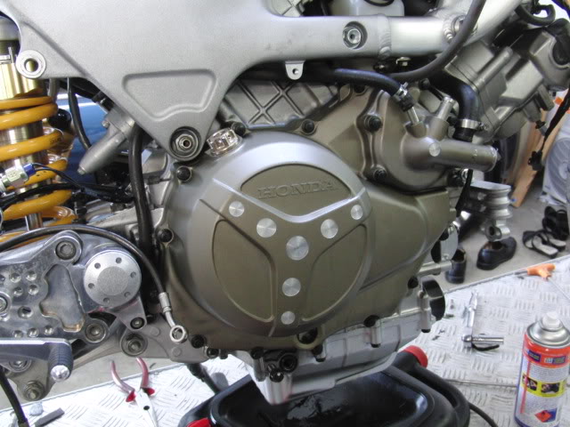

Someone mentioned that they liked my Front sprocket cover, so this morning I decided to play with a few on my end mills and match up the clutch cover, and water pump cover... Nothing like a bit of weekend titivation

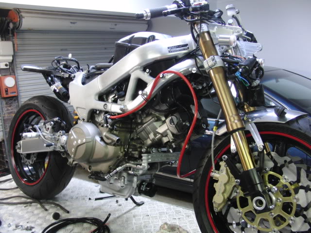

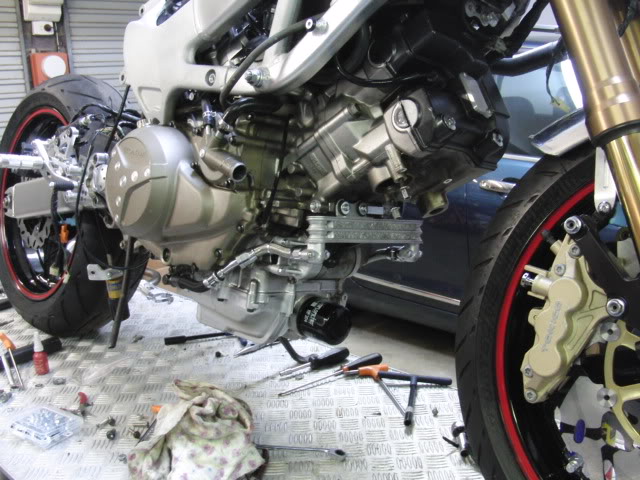

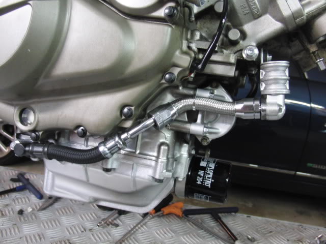

Been a bit slow at progressing lately. Went and did a track day on one of my other bikes and that was a bit of fun. Tonight I got the oil cooler linked up with some braided hose.

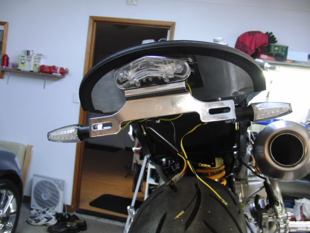

PappySmears is on a distinguished road
Getting down to the electrics now and looked at a few tail light/ indicators and this is what I have settled on for now, it hides away under the seat. I wish that indicators were not needed but it is a case of getting registration.

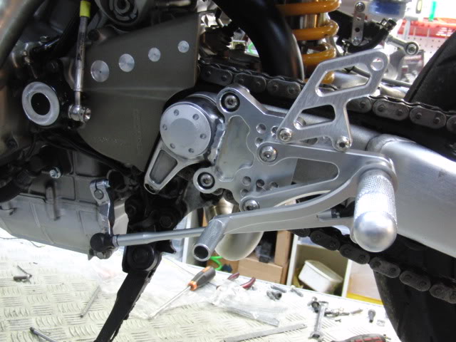

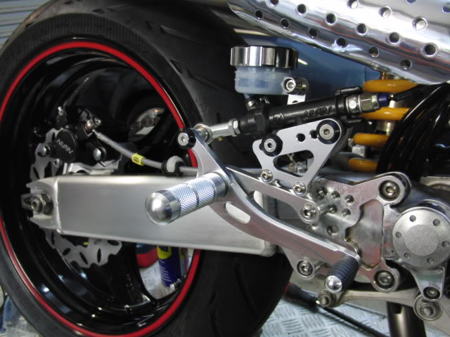

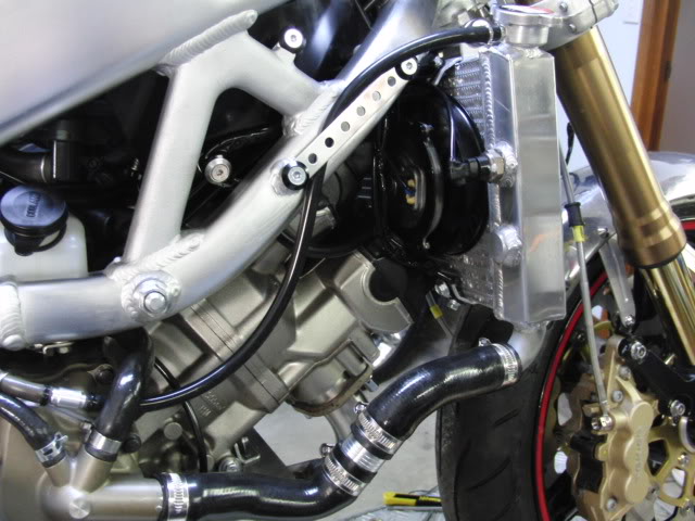

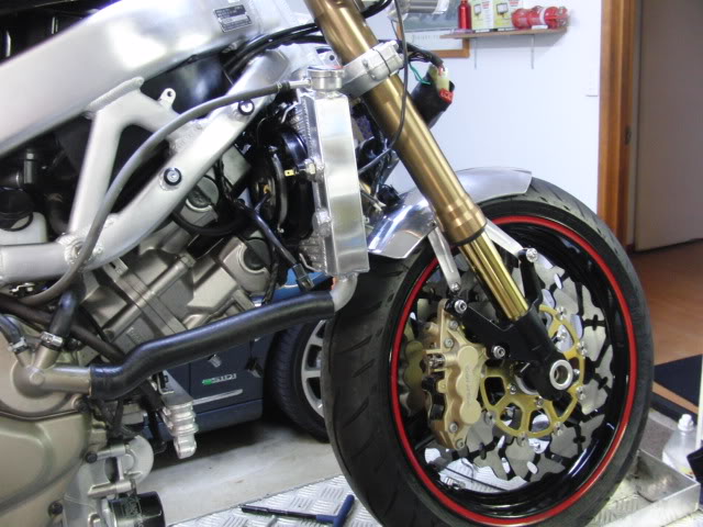

I got some Braided lines made for my rearsets and the front forks as the standard ones will not fit, fixed up a gear linkage and bleed the rear brakes, fitted a cheap ebay reservoir and bingo, there you have it!
Old Nov 14, 2011 | 12:14 PM
  #120
PappySmears's Avatar
Joined: Sep 2011
Posts: 139
From: Australia
Purely for aesthetics I decided to use two bent piece of radiator hose instead of one long straight bit with a little kink, I know this adds more things to leak ect but I think it looks better with a joiner in the middle of these two.
After all I am going for the "Hot Rod" look
