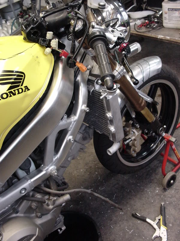

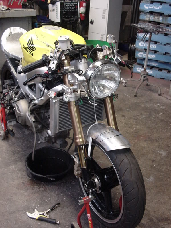

Mounted my Chinese, Ebay radiator today, so far so good, looks like the hoses ect will fit up ok too.

can you still turn lock to lock with that rad???

Steering lock has been made closer by moving the rad up there,,,,but is a cafe racer remember, they have no lock, you are ment to lean till it all scrapes!! You only need lock to reverse park!!!! ha.

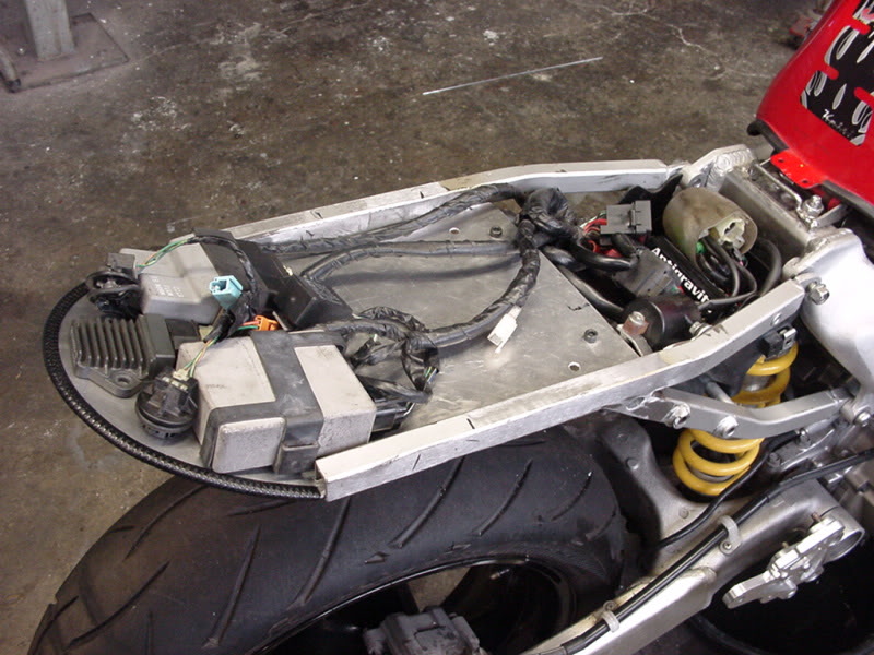

Starting to get the boring stuff sorted out now, like all of this under seat Spaghetti... The only good part is that Honda seem to add plenty of length to the wiring loom allowing some components to to situated where I want them without hours of wire soldering extensions!!

The way you have shorten the rear subframe looks smicko mate

Thanks mate. Far more work than I imagined I was going to do, but one thing flows into another.

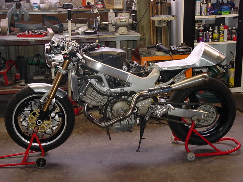

Front discs arrived today and starting to piece the front end together now.

Whoa look at that exhaust. The things I would give for metal fab skills and equipment.
Also, nice detail on the mag sprocket guard... that's probably the best version of a modded stock cover that I've seen (or at least remember)

I see that exhaust getting nixed, or at least cussed at a ton. Looks cool, but also looks painful!

Exh does look MIGHTY gorgeous though. Nom nom nom!

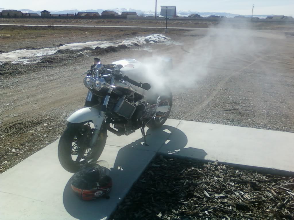

I would advise on relocation of the R/R, particularly if you go to lighter draw lights. I really stripped the electrical system and mounted my R/R exactly as you have, and there is very little airflow through the bumstop. We all know how this ended:
So after I switched to the MOSFET R/R, I relocated it into the airstream, and it stays really cool now. You can see it below my hand above the RH radiator:

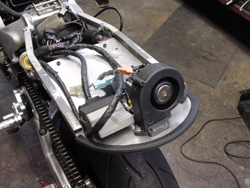

Found this little 12volt computer fan at work..... Now this is getting a bit over the top!! But good for a laugh..

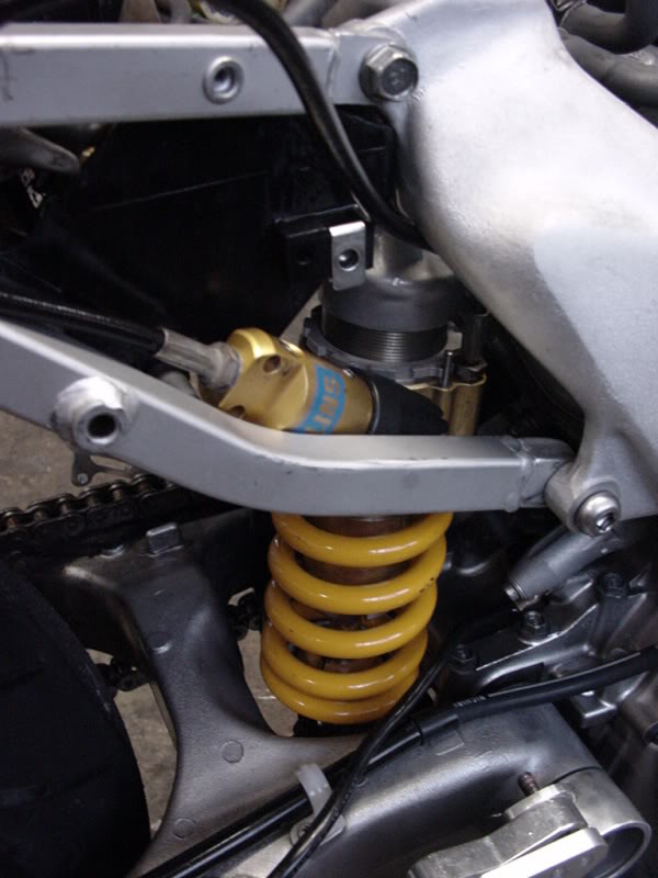

Ohhh and I got some OHLINS gooodness off one of the other bikes I had lying around.

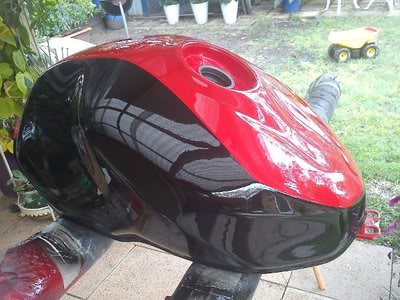

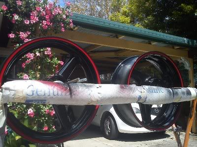

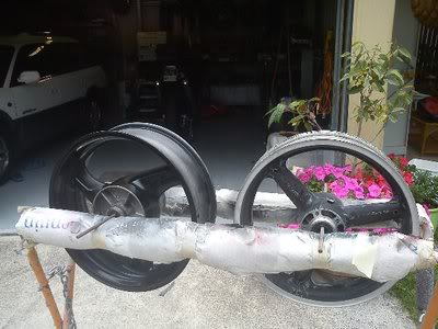

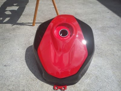

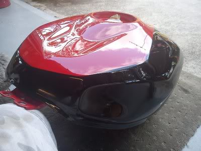

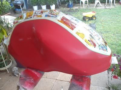

I have managed to finish off my tank and wheels in the colour I like.
I have tried to make the tank look smaller and not so bulky by making the sides Black.

two things
1 those pictures from motoGP are awesome, i could drool over those bikes all day
2 NICE paint on the tank and wheels, what are you using, HVLP?
Old Oct 31, 2011 | 07:36 AM

Sorry I dont know what HVLP is? But I have a auto paint shop just up the road from me and they help and guide me where I have run into problems. The paint that they supply to me is Spies Hecker. Unfortunately I dont have a spray booth but I rigged up a tent, with small fan, and spray with a mask and disposable suit, I sometimes get some dust particles that **** me to tears.

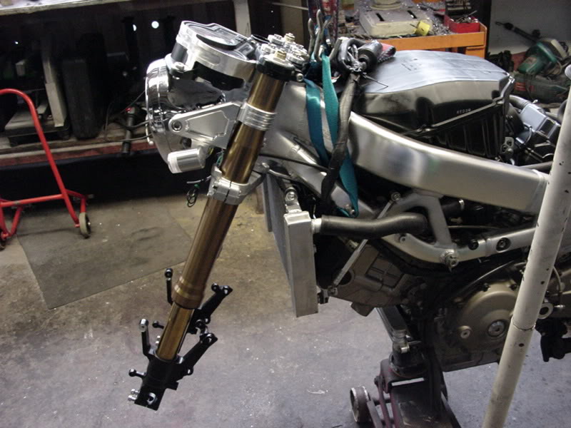

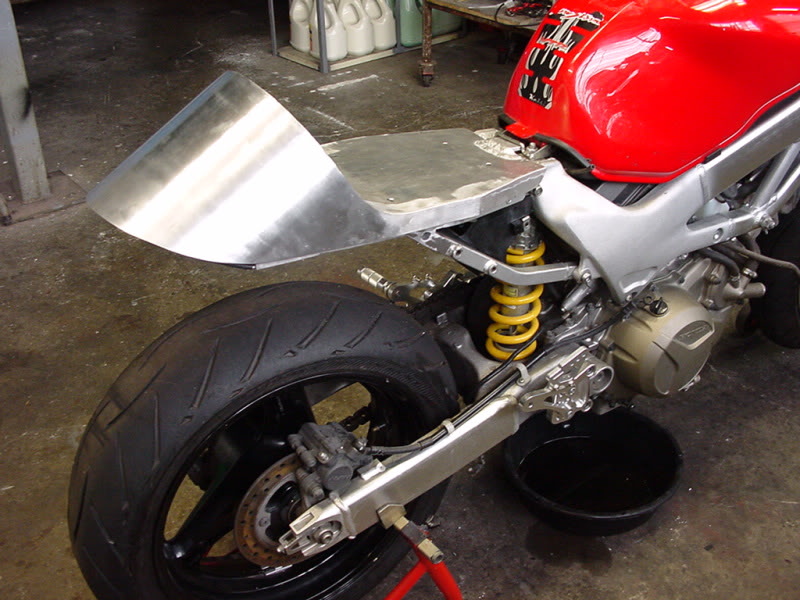

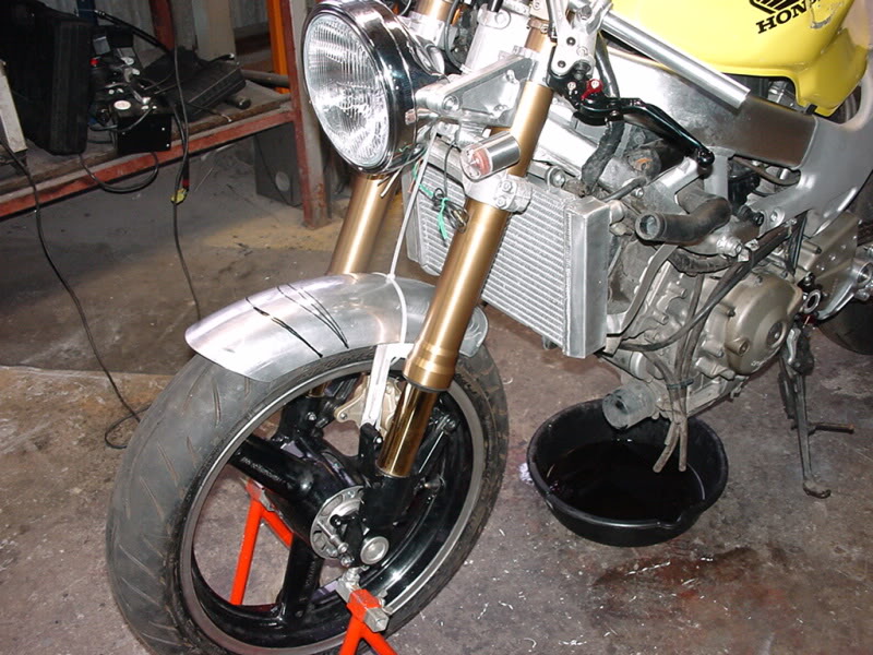

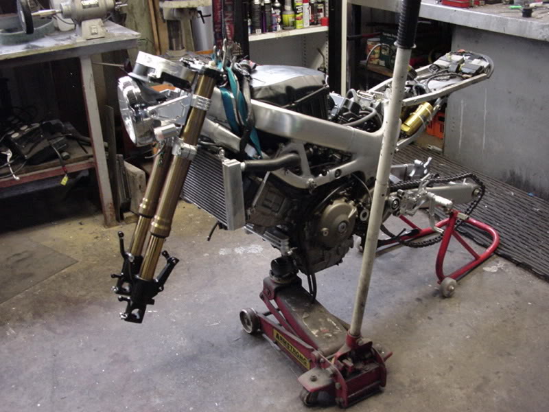

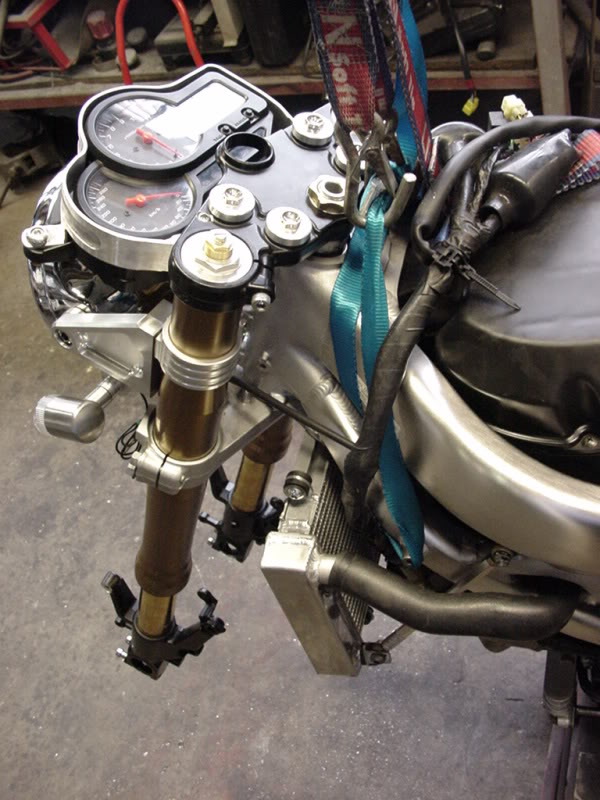

I must have had this Haybusa front end on and off a dozen times to set everything right. The steering stops proved a pain in the ****,with the new Radiator. Now I have to sort the ignition switch out.
