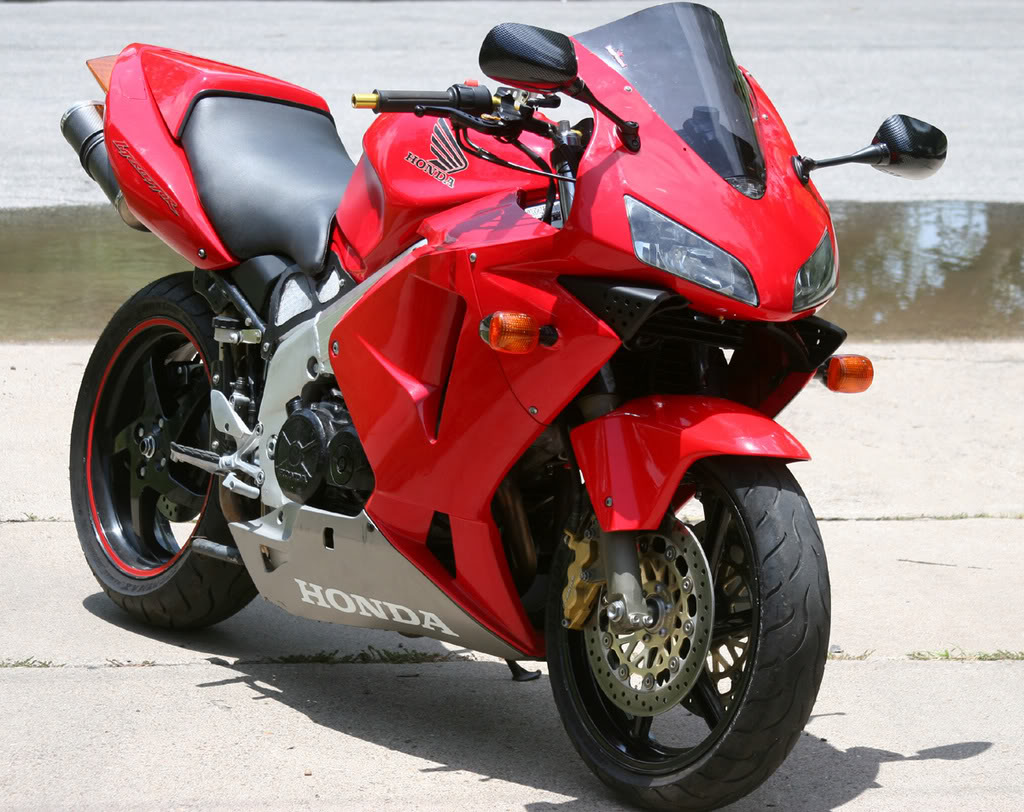

You can use those wheel/rotors with an F4i front end and gain larger 43mm tubes/triples and additional compression adjustment. Just like most USD units, the stock f4i springs are too weak for the vtr but the fork length is longer than most USD so that eliminates quite a few issues.
I'm ran this setup on superbling AND am now running it on my RCBVFR:
Old Jul 13, 2007 | 06:52 AM
Sweeeet looking ride there Bling. You know, I don't think too many of us would be upset if you chose to post a few more pics and listed your mods. Yes, I am giving you permission to highjack my thread (or start up a new one)
cheers

No need to jack, I have one on it you may have missed. I just updated it with new pics:
https://www.superhawkforum.com/forum...0912#post60912
Enjoy.
