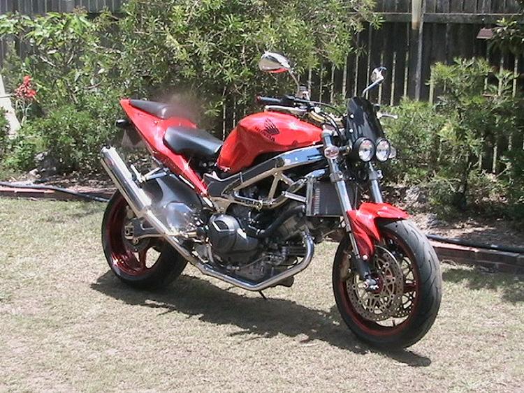

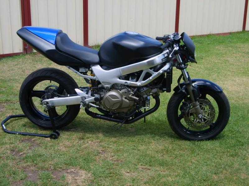

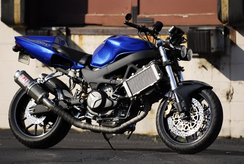

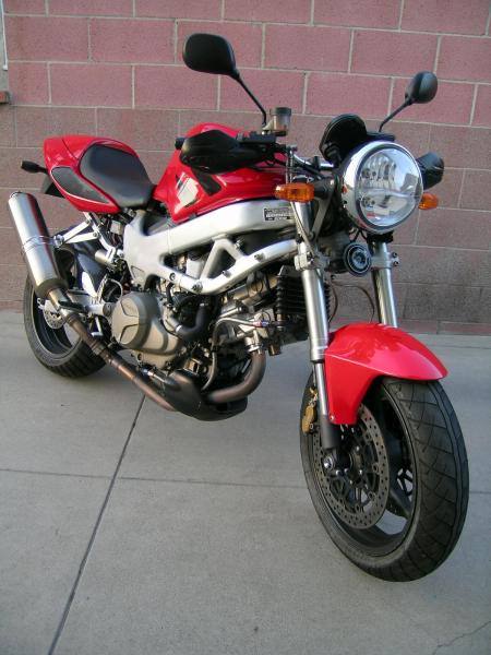

New to the VTR scene...Where do I Begin?????
I'm new here and I have my first SuperChicken! It is a '98 that has been converted to a semi-naked. There is a single headlight but is it attached to the stock fairing stay, which looks kinda stupid. I'm looking to make it look like a true naked without the light and cluster sticking out. I have searched all over and cannot find any pics of VTR's that have been converted. I want a dual headlight setup so that is what I'm trying for. Any help would help to point me in the right direction or pics of conversions done. Hopefully someone will help!!!

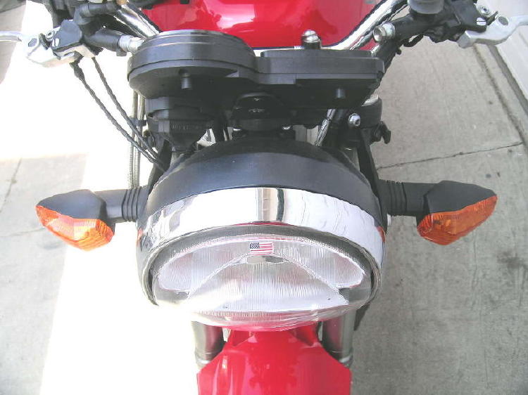

Here you go!
This forum does get used alot & there are plenty of people willing to help. But i dont think you searched very hard.

Thank you. I have found some pics but a lot are in Europe. I guess what I'm looking for is where did the headlight conversion come from or actually what works best with the stock cluster. I really like the Z1000 look but I am having a hard time finding all that I need and will it work with the stock cluster. I have never done any modding like this so bare with me on what seems like stupid questions.

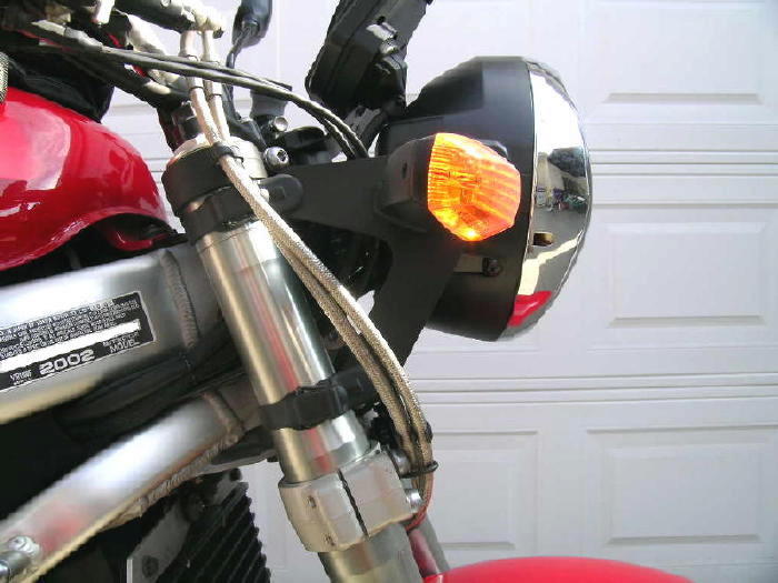

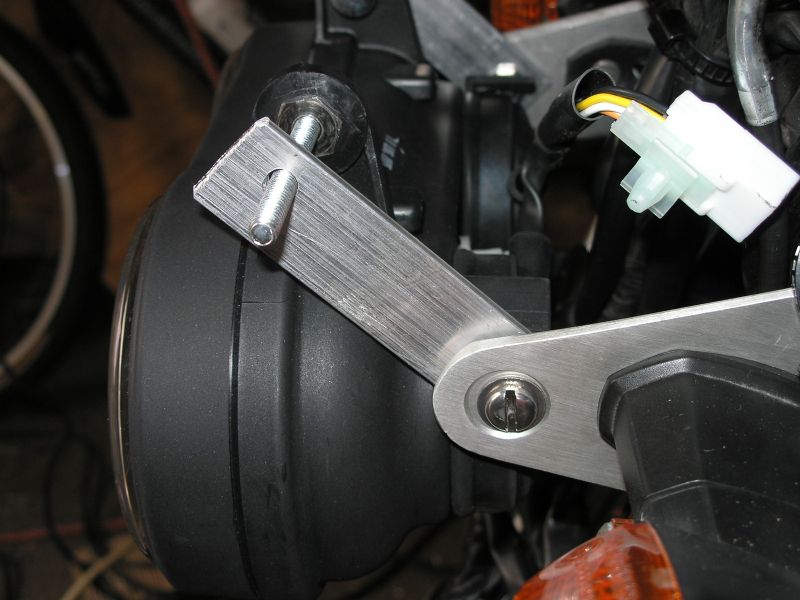

They are not stupid questions, if you have never done this before.
I think most guys doing this go for a headlight that they like the look of & then make custom brackets to make things fit or what ever they have in there garage.
They also change the stock cluster some times to something that will fit better/smaller.
To start with, maybe choose a head light that you like the look of, you have all ready said you like the twin lights.
Then remove your stock head light, cluster & headlight bracket.
then position your new headlight were you like the look & of course will work & not interfere with anything/cables etc.
Then work out a way to mount your new head light, may be you will need to take a trip to your local hardware store & look for some aluminium plates or some brackets, use your imagination & design some thing that will work & may be look good too .
Then see if you can mount up your original speedo cluster in some way that you like, once again you will probably need to make a custom bracket of some kind.
Or you may want to purchase a smaller speedo cluster that will fit better, there are plenty to choose from on e-bay. Also plenty of head light brackets on e-bay.
Hope this is of some help.

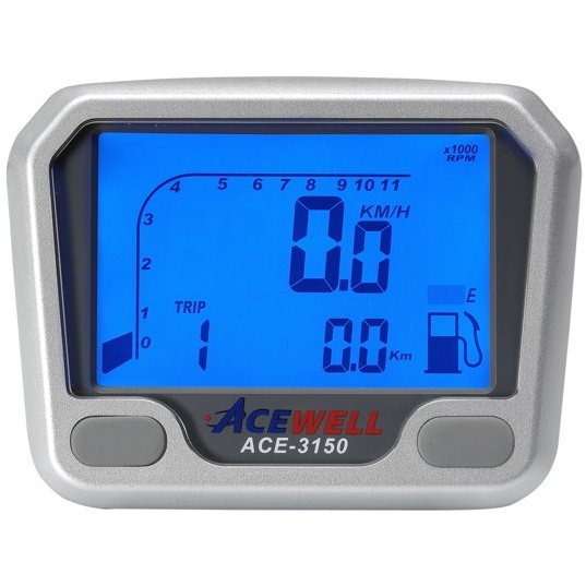

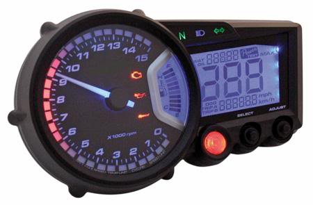

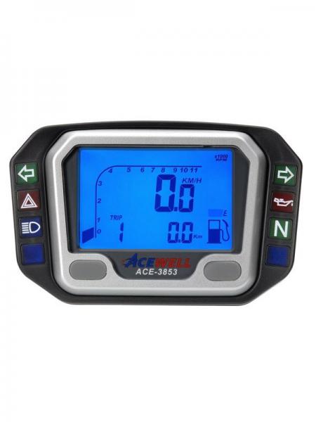

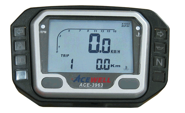

If you search the net for streetfighter motorcycles you will find lots of usefull pictures & infomation as all streetfighters have the kind of set up that you are going for.
Here are some gauges i found on e-bay & the net that you might like.
The companys are,
s3performance.com
digital-speedos.com.uk
Have a look there are lots more styles too choose from & more internet shops selling them. I dont know how plug n play they are, take a look at there web sites & maybe email them if you find one you like.
Attached Thumbnails Where do I begin???-dbo1dim.jpg   Where do I begin???-dl02sdigital-speedos.co.uk.jpg   Where do I begin???-ace-3853_sq.jpg   Where do I begin???-xrsrdim.jpg   Where do I begin???-ace-3150_sq.jpg

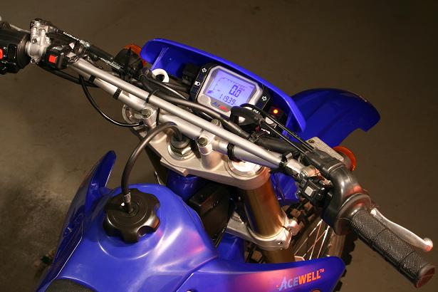

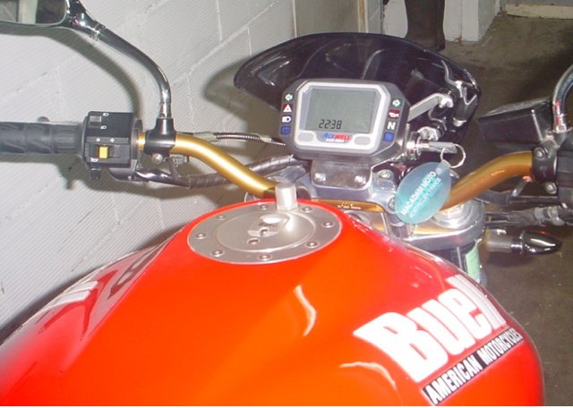

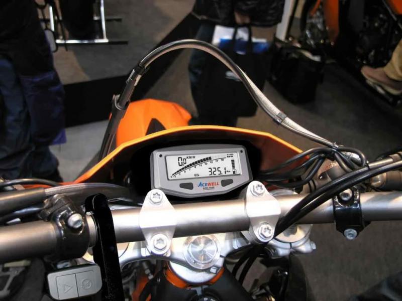

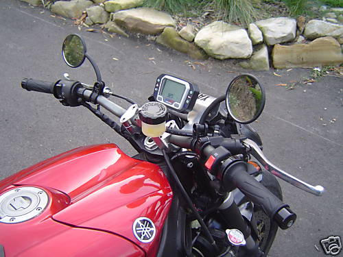

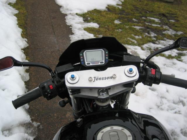

Here are some mounted.
Attached Thumbnails Where do I begin???-3853_on_r1_streetfighter.jpg   Where do I begin???-ace1600_on_ktm.jpg   Where do I begin???-ace3853_on_xjr1300.jpg   Where do I begin???-ace-3803_on_wr450.jpg   Where do I begin???-rx2multics.jpg

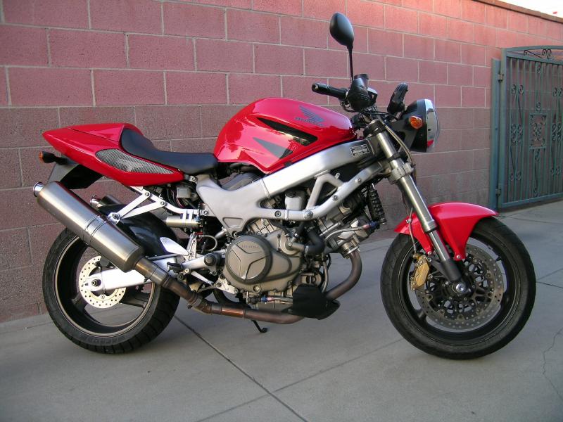

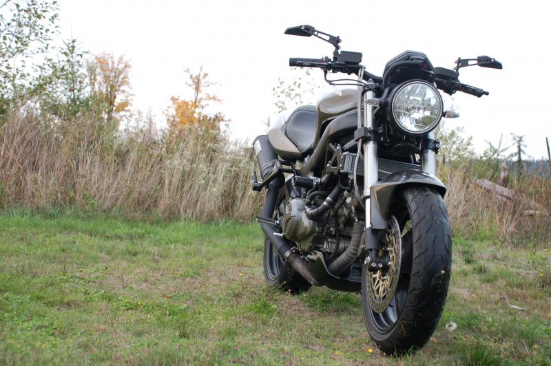

Naked VTRs

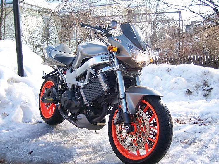

There are several on this forum, mine being one of them.
Here are a couple of pics to save you the trouble of looking.
The meter is off a CBR900RR, the headlight is 600 Hornet aka 599.
The headlight ears are ABS plastic attached with XR650R number plate straps.
Kai Ju
Attached Thumbnails Where do I begin???-image044.jpg   Where do I begin???-image005.jpg   Where do I begin???-image038.jpg   Where do I begin???-image042.jpg

Is the CBR900RR an easy swap into the SH harness? Good looking bike!! I found a dual headlight kit from aztec8 which i might look into getting. The cluster is what I'm the most concerned about now.

The wire colors are mostly the same and you can use the 98 VTR's low fuel sending unit.
What you will have to do is find the meter assembly and it's plug in with enough wire left over to splice it into the VTR harness.
You will also need a Speedo Healer, or a Yellow Box to calibrate the speedo, mine was off by about 17%.
Have fun and let me know if you have any questions.

Here is a wiring diagram, sorry its not the best quality but you can make things out.
There does seem to be guys on other forums using them, as i said in post 6 if you search under street fighter motorcycles you will find much more information than on this superhawk forum.
The manufactures do say they are universal & work on most models.
Attached Thumbnails Where do I begin???-untitledacewell1.jpg   Where do I begin???-ace3963.gif   Where do I begin???-ace3853.jpg   Where do I begin???-ace3753chart.jpg   Where do I begin???-ace3963_on_buell.jpg
