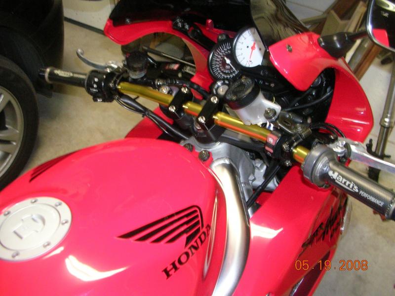

Having sourced a new top Yoke and Mini Bar, from a local dealer via the UK, I set upon converting my bike from Clip-ons to Comfort bar last weekend.
The job was stright forward with no major drama, excvept for the slight trimming of the fairing.
The catch though though is that I think the VTR loses it's character this way.
I do a lot of commuting, and the hands and back really start hurting after a while, whereas, this conversion really takes the stress out of your wrists, arms and back....
But... I think the bike has lost it's character or appeal...dunno the right word..
Anyway, will try this for a while and go back to the old style if I have to.
Your thoughts?
Gerrit

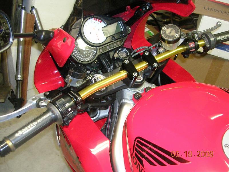

I have risers too and I personally think the bike now has more character after the mod than before
The bike feels both more comfortable and more stable with the wider superbike bars...however, that said it's really a individual preference kinda thing and whatever you decide to use do it for you and no one else

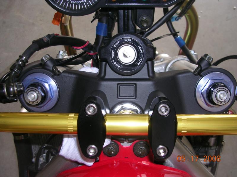

RI, I bought the bar and clamps on Flebay for around $50. You'll have to drill your top triple to bolt clamps down. Superbling gave a good example here:
https://www.superhawkforum.com/forum...superbike+bars
Good luck,
RC

Well after a weeks commuting I must admist that the comfort bars are the way to go, and really a VTR is not a Superbike, more Sports Cruiser and these bars are perfect.
As you can see from these pics, I added a 2nd top yoke, that bolts onto the centre nut. Simple and straight forward.
