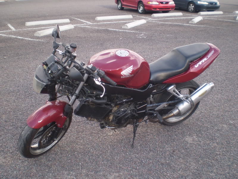

looks a little strange w/no changes, but totally rideable. I rode mine around ratty like this for months.
Disregard the bent clutch lever. I, uh, tried to convert it to a shorty by not using the kickstand...
Birds nest of wires, but hey, gotta crack a few eggs....

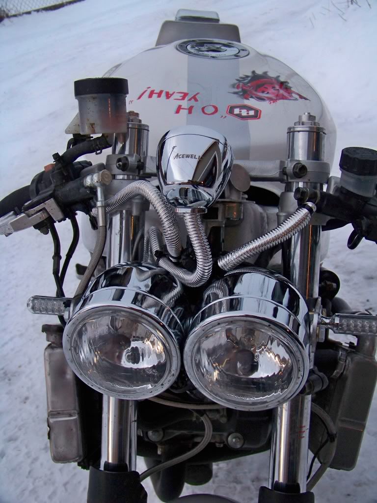

I think any parts of the stock setup used in the naked version look like crap. You can make yourself a couple of headlight mounting ears from flat strap in about 20 minutes, buy a headlight on ebay, and bolt it on. The wiring will have to be cleaned up (and shortened) to fit with the new lights. And you will probably want a new gauge cluster, as the stock one looks really bad with a naked setup. Koso, Veypor, and Acewell all make replacements that work. Here is mine, and has the prerequisite, "I was wrecked" creds
