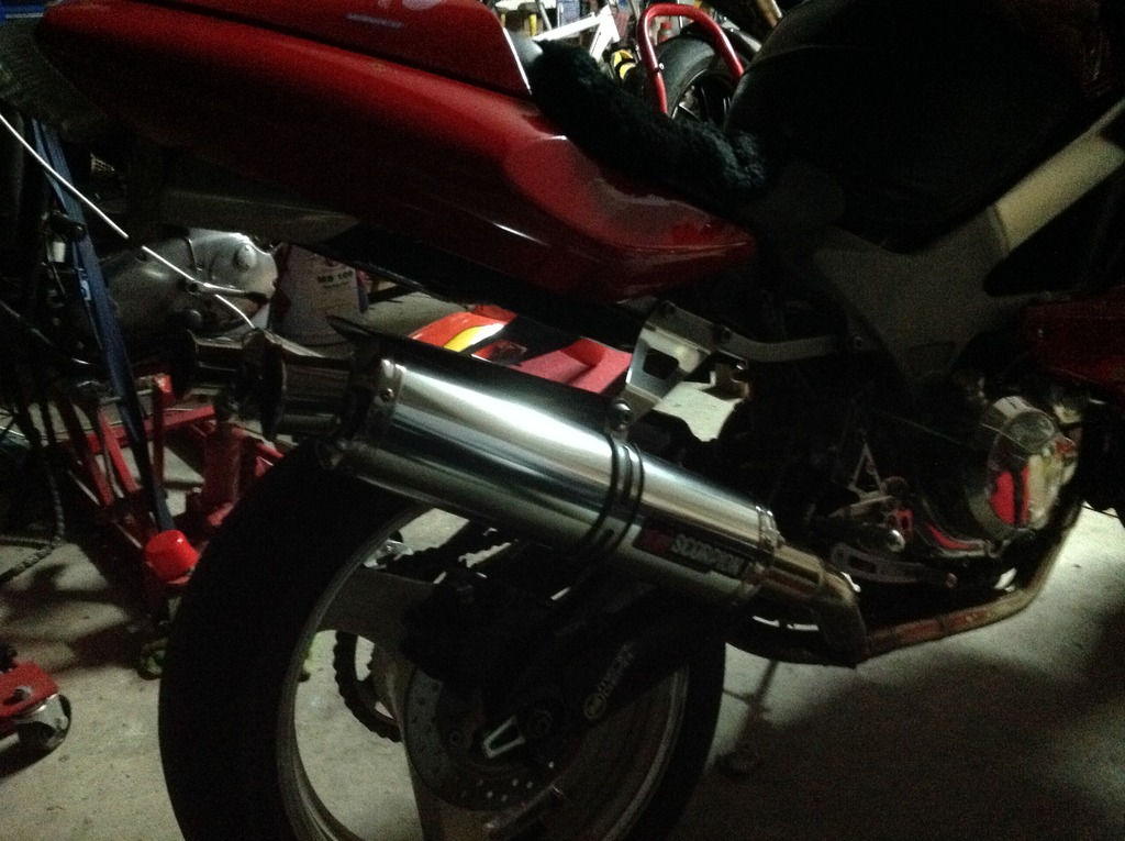

Old Aug 24, 2016 | 01:33 AM
I have projection high mount hangers and with a bit if fiddling they fit.
Have been on the bike for a few years now with no problems.
Here's how they look .
Hope this helps.
Old Aug 24, 2016 | 07:47 PM
Hope this helps.
Don't mean to be rude or burst any bubbles, but from what I can tell those are the standard/low mounts (only ones made by PC; ie. identical to mine).
Old Aug 25, 2016 | 02:04 AM
Funny you say that,
I was worried when I bought them from the dreaded flea bay as they were listed by projection as high mount and I was thinking that because I had just ordered a new set of cans and link pipes that I was going to have to do some major mods to get them to fit.
I did have to fiddle a bit but got it all to work. I took the measurements from the standards as compared to what I now have and from memory the cans were about 3 " higher and located closer to the bike.
Here is another view from the rear that accentuates the difference over standard . Sorry it's on an angle as my rear stand is under another bike at the moment.
[URL=http://s1000.photobucket.com/user/kbarr2/media/Mobile%20Uploads/2016-08/8FEBC9D5-B158-4C16-9DF7-ADD90D24999F_zps24u5xtuk.jpg.html]Name:  8FEBC9D5-B158-4C16-9DF7-ADD90D24999F_zps24u5xtuk.jpg
Sorry it's a bit dark in the man cave at the moment but you should get the idea. The distance from the rear cowl to the can is somewhat diminished.
If you can't see that here is a pic of a standard VTR.
Granted they are not as high as some but they are higher than standard.
It's not a bother to me as I prefer the more traditional look rather than the really high mounts like staintune etc.

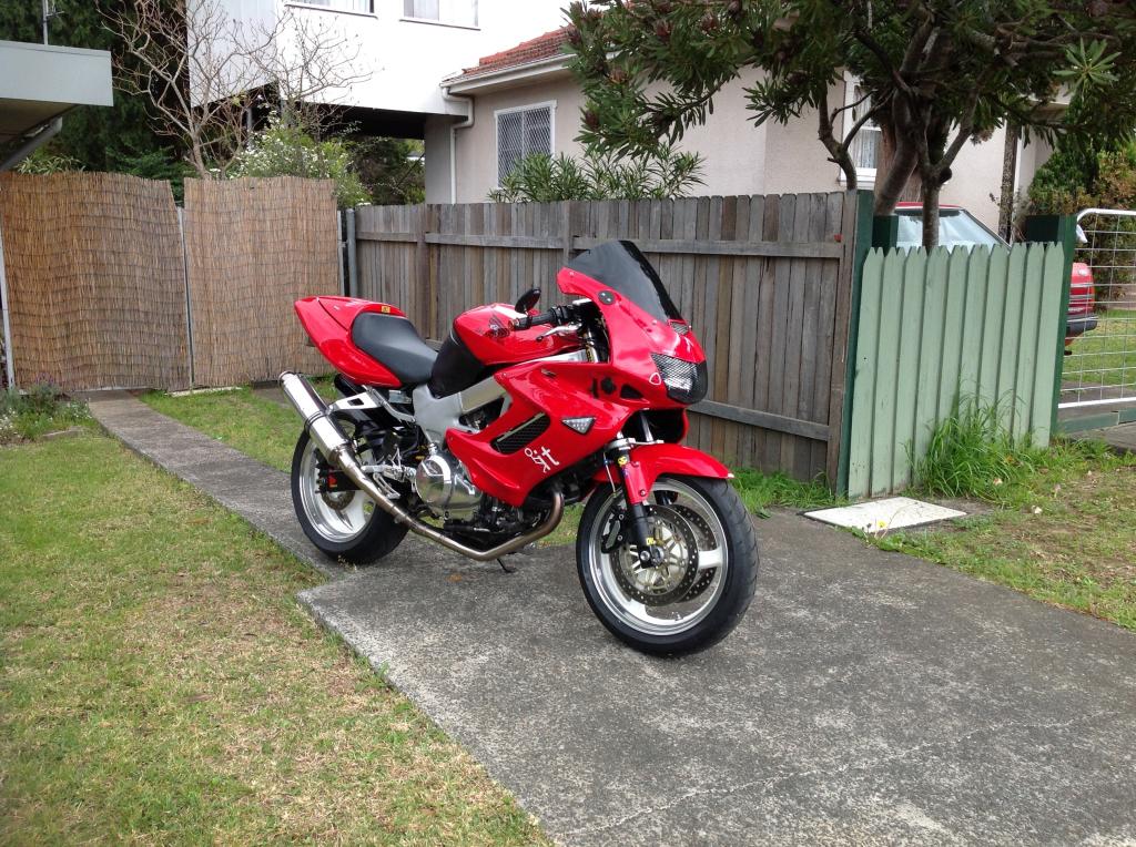

Have a go and make em yourself ,not hard did mine using mild steel and then getting it chrome plated
