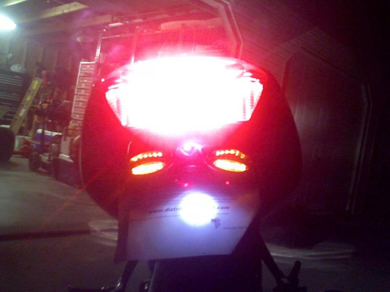

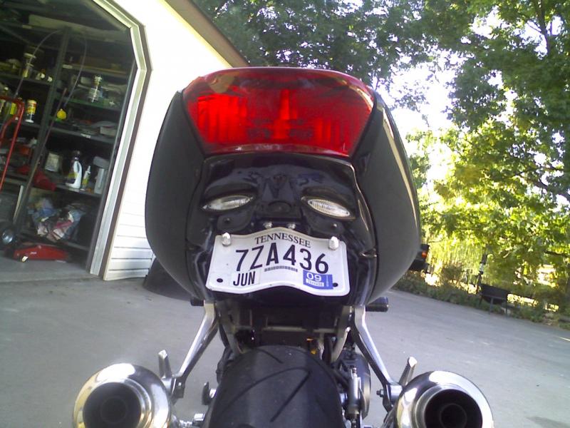

I superglued the led's in place and then glued the covers in place. They snapped right in place for me, but I glued it anyway.
