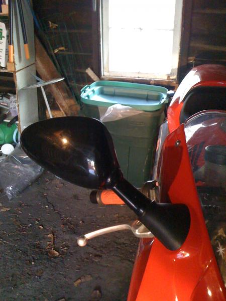

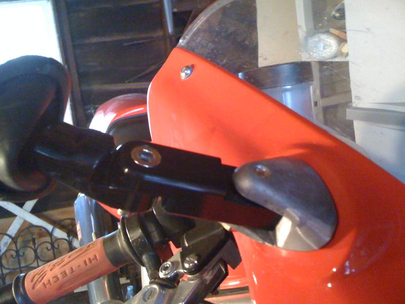

SW-MOTECH extender pics
Originally Posted by Tormoz
Well, I FINALLY got them just before New Year. Look fine. I'll try to get off my butt tomorrow and put them on and take a few pics. Communication from the seller wasn't the best, but they did let me know they were backordered, so it's all good there.
From another post it sounds like they went up in price?
Finally got up the courage to go out to my old garage and put them on. They feel sold and appear to be very well made. Putting them on took about 10 - 15 minutes max. Basically you roll back the rubber sheath covering the area where the mirror stalks attach to a brace on the outside of the fairing; then undo the bolt holding the mirror stalk on (a few washers might fall out, so catch them). Re-use that bolt and one washer to attach the new extenders; then attach the existing mirror and stalk to the outer part of the sw-motech extender, using their allen-heat bolt and 13mm nut. Nicely done, and they even include small covers for both the nut and the recess of the allen head.
From bolt center to center is 2 inches, which is pretty much what I wanted. Great deal for $30, but as someone else pointed out, they've now gone up to $65, which seems like a lot of moola for what you're getting, no matter how well made.
The pics of my bike here are before putting the extenders on ... I'll have another post in a few minutes with the "after" shots.
Attached Thumbnails Mirror Extenders-img_0064.jpg   Mirror Extenders-img_0065.jpg   Mirror Extenders-img_0066.jpg   Mirror Extenders-img_0067.jpg
Old Jan 15, 2012 | 03:14 PM
  #42
Tormoz's Avatar
Joined: Jun 2011
Posts: 231
From: Saint Paul, MN
Tormoz is on a distinguished road
more sw-motech pics...
Now for some "after" pics. The third pic is a shot with one mirror extended and the other not ... shows the difference pretty well.
Attached Thumbnails Mirror Extenders-img_0070.jpg   Mirror Extenders-img_0071.jpg   Mirror Extenders-img_0072.jpg   Mirror Extenders-img_0076.jpg
