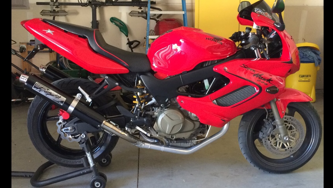

Zero prep for NitroPlate. I shipped mine super gicky. They sandblast it, then coat it inside and out.
I really like the silver i had them do, but i don't like where the silver meets the Erion chrome mid pipes.
I'm actually considering either sending the headers back to have them coated in black, or removing the chrome on the Erion midpipes and sending the Erion midpipes to NitroPlate for silver coating.
Gonna wait and get some more things powder coated black first, then make a decision.
James

No thread jack taken. I would like to get as much info as I can on the subject of ceramic coatings. My understanding of the coating process, someone chime in if not correct, is that the shop will surface prep the part to accept the coating. If the part has surface imperfections, deep scratches, dents. weld spatter, etc. those imperfections will show through the coating. Don't know how deep a scratch the coating will cover and not show. A question I want to ask whomever I I end up choosing. I have sanded most of the header already and have it quite smooth as I was going to bring them to a polished condition. Don't know if this is overkill, but want to err on the side of too much than not enough and be unhappy with the results.
James[/QUOTE]
IMO the silver looks good on it's own, but I don't think it works with the black out you have going on. Engine case, mid pipe and header are a bit dis-harmonious. I say this ever so cautiously as to not offend. Can I ask what you had to pay Nitro Plate?

No offense taken. I'm still trying to get the look just right too.
Clutch cover and oil pan will be powdercoated black this winter. Engine case will stay silver. Basically everything attached to the engine (externally) will be black including suspension parts.
I think it was $130 shipped? Maybe $145... Definitely under $150 though.
James
James
Once you get all the parts of the engine done in black how to do the exhaust will be clear. Get the mid pipes done same as headers.
Already a visually striking SH. The finished project should be a VTROTM.
