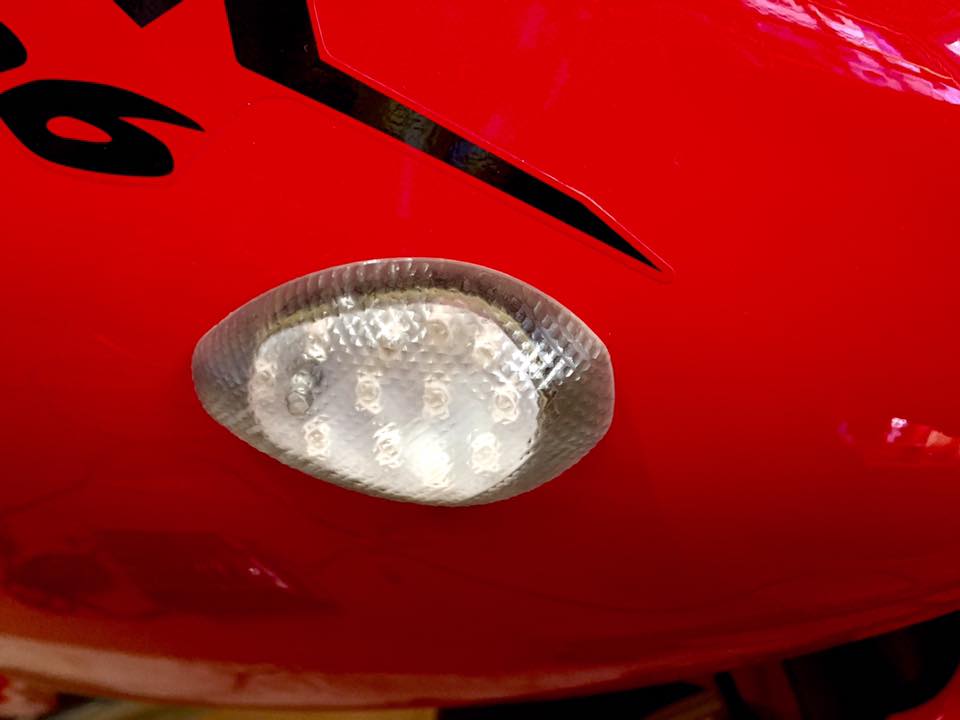

RC-51 Protons fit very well you have a choice of flash patterns and will function as running lights, definitely not $40, but you get what to pay for. With LED blinkers, you will need to change the flasher to a no load unit, this one plugs directly into the harness plug and mounts to the stock mount.
https://www.superbrightleds.com/more...asher/787/842/
Attached Thumbnails Flush mount turn signals-17309358_1547272998640082_6584956354749854929_n.jpg
