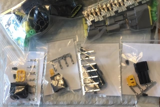

Welp I just ordered the Furukawa sealed connectors to do this So its happening
We will see how it all works out... My vision of it working is awesome..we will see if reality comes close...LOL
Oh And I decided on a 2 connector plan, vice larger single which i think would have been just too bulky.
So its a 3 way connector for the headlight for the larger current of the headlight and a 6 way connector for all others.. Since those are all LED, I can use 22 ga wire making the bundle much smaller then if I had done a 9 way plug.
Im also considering making a mount for the wiring harness side connector. would be even easier if you only needed one hand in there to lift the locking tab of the fairing side plug, then two hands to hold both and lift the locking tab......I think....well pretty sure..ya Im positive Im pretty sure

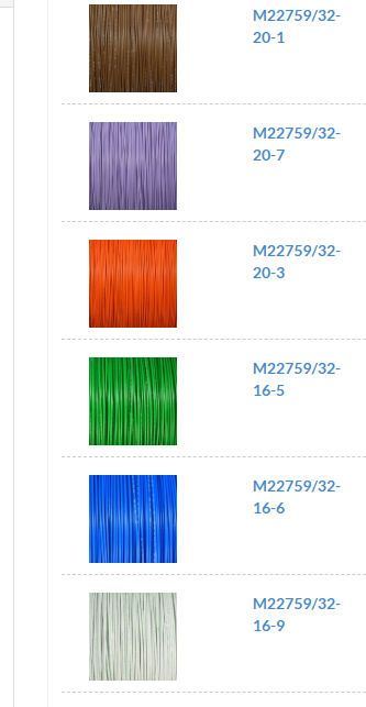

My Tefzel wire flame-retardant ETFE insulation high strand tinned copper wire order did not process last week ..some glitch in the check out system I guess and I did not notice the account was not charged... called today to check on shipping time line and they said....what order.......buggers..
So now on hold another 3 days for shipping the order....
