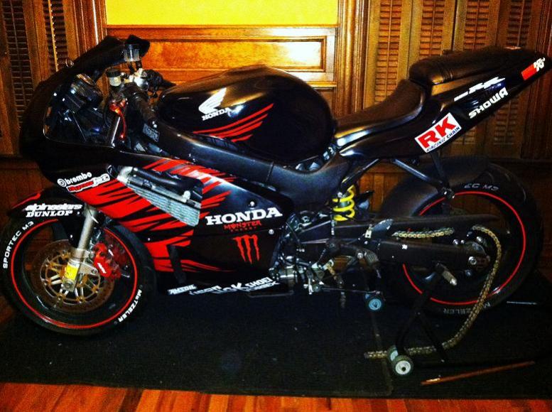

well well well, where to begin! Theres been numerous upgrades to this project since the last posting! The long upstate NY winter has been depressing as usual, but super beneficial for my Hawk! Although I loved the look of the RC plastics, rather than retrofitting a busa headlight to the fairing and fairing stay, I decided to keep the hawk headlight and chopped the RC upper fairing. I took the middle section of the superhawk upper fairing and spliced it into the RC bodywork. I must say, it looks absolutely awesome, still fits into the stock hawk fairing stay, and the mirror mounts even line up perfectly with the fairing stay.
Along with the headlight work, the upgrades that I have done include: New clutch plates and discs, factory pro shift kit, K&N air filter, Manual CCT swap, PAIR removal, Vortex -1/+2 sprocks with 520 chain, DynoJet stage 2 jet kit, New NGK iridium plugs, MOTY race battery, and I think thats about it. Im still up in the air about what I wanna do with the exhuast but I wanted to get the cosmetics buttoned up in the meantime. I kept the gloss black bodywork with the blacked out everything else (frame and swingarm, foot controls, etc.) and went with a Honda tribal wing graphics kit from All Out Graphics. If anyone is looking for a graphics kit but doesnt want to spend the 200+ dollars on a Tapeworks or similar company, I would HIGHLY recommend AOG, their products are high quality, their turn around time is quick, shipping is quick, and their customer service is awesome! This kit only cost about 85$ if memory serves. So here is an updated pic. I think Im also going to mold my own Carbon Fiber windscreen, I think that would look trick. So heres my 98 Hawk, with RC51 fairings and a ducati 748 biposto tail. Look for it soon in the VTROTM and vote for it to win!! I have included also, a pic of it after my accident, before this project began. The transformation has been amazing.
PS....Dont mind that the chain is hanging...Im waiting on my MotionPro chain tool kit to come.
Attached Thumbnails been doin work, rc51 fairing swap, ducati tail!-img00317.jpg   been doin work, rc51 fairing swap, ducati tail!-photo-2-.jpg

Not normally a fan of black bikes, I have to say that look rocks!. Nice work.

Aw c'mon, more pics. That looks awesome. What tail section? I didn't see where you said where its from.
For sure more pics. This is the answer to the winter doldrums.
The tail section is from a Ducati 748 biposto

Very nice mod. The front fairing and rear tail look great together and flow very well.
