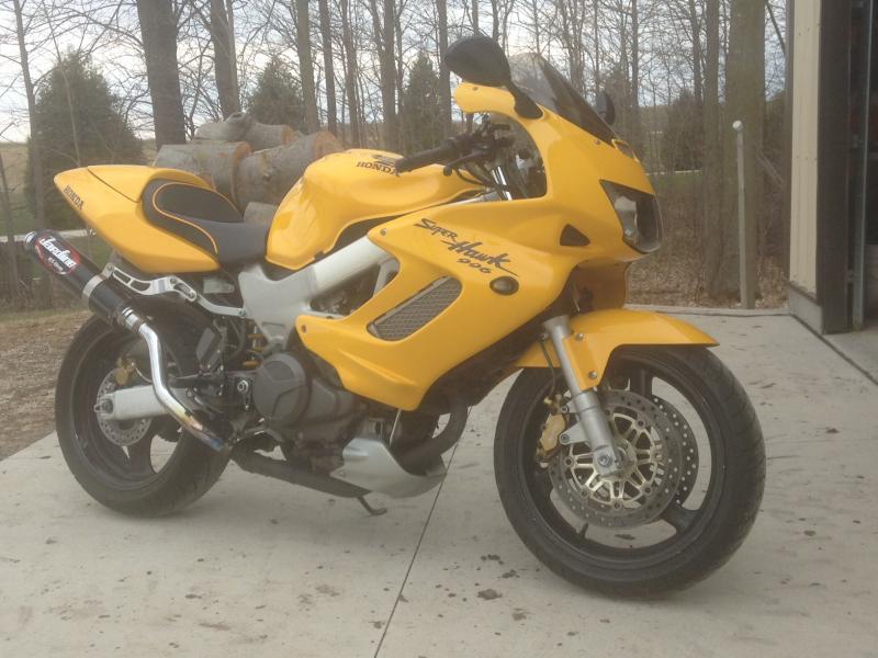

Hey guys!
Just bought my 2000 superhawk from a member on here appletonhawk! Pretty sweet ride and one heck of an upgrade for me. My daily before the superhawk was an 82 yamaha 400 that i restored and I'm currently wrapped up in two project 600r ninjas. Glad to see such a great community here, I was pretty active one the maxim forum and this feels just as friendly and helpful. The superhawk will be put to good use getting me back and forth between milwaukee and green bay. Only thing I plan on doing now/early in the season is installing manual CCTs after seeing so much about it here and talking to the PO about it a bit. Looking forward to using this forum to get up to speed with the superhawk!

Welcome to the forum. You bought your machine with some nice mods and it's already the right color. Congrats.

Love the seat with yellow piping.

Hey nice bike! HAHA! He got a bike set to go with almost every good mod you could ask for already done! I might be a little bias. LOL

Good thing you are used to the slower speeds from the 400. You got the speed-limited yellow color.
Still a fun bike FWIW.

Which seat is that? Corbin or Sargeant?
Old Jun 13, 2014 | 12:51 PM
Sarg

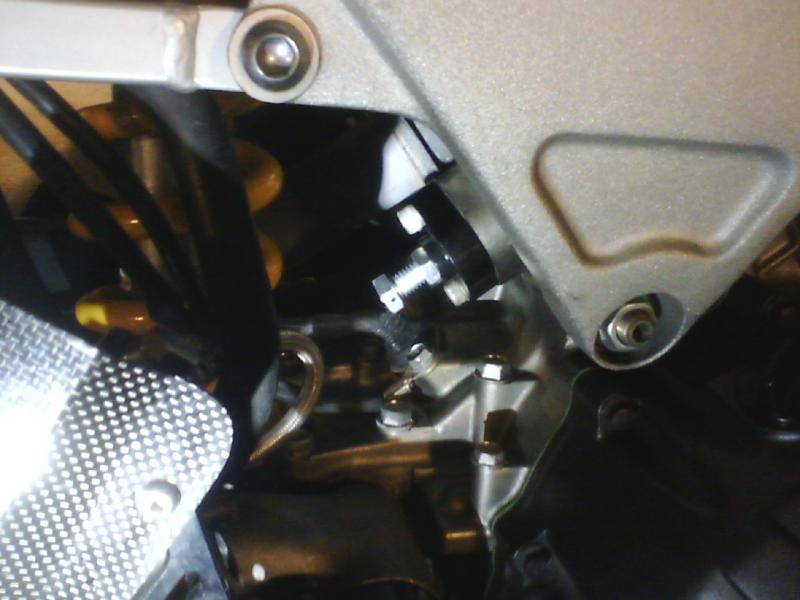

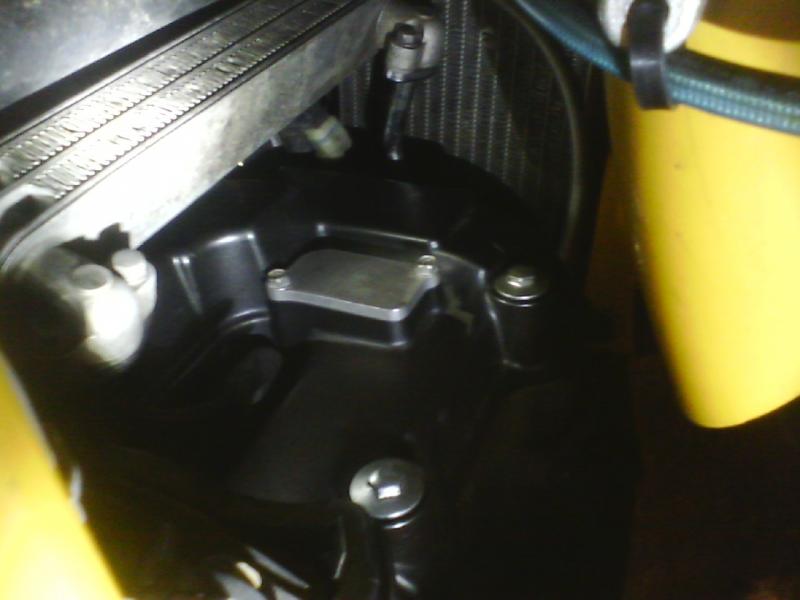

Big thanks to Crux , helped me out all afternoon installing MCCT's, PAIR blockoffs, and doing a quick sync . Huge help, great to have such helpful, knowledgeable people in the superhawk community!

That's an afternoon well spent, that you'll never regret. Once you get the R/R replaced (unless it was already done for you), it should be pretty much bomb-proof. Congrats!
Already done so I'm good to go!

No problem man. Was glad to help.
Once you clean and adjust your carbs, you'll be able to pull wheelies in 1st gear anytime you want.
