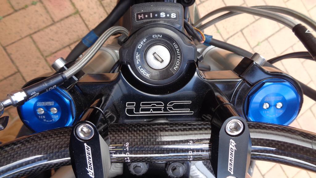

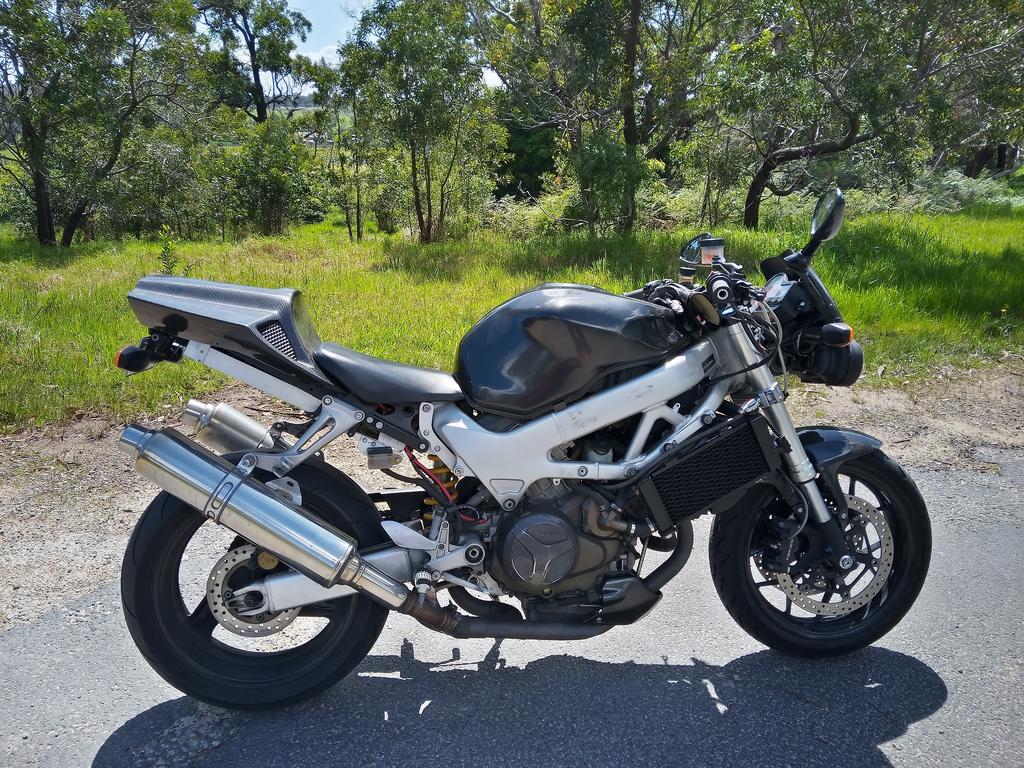

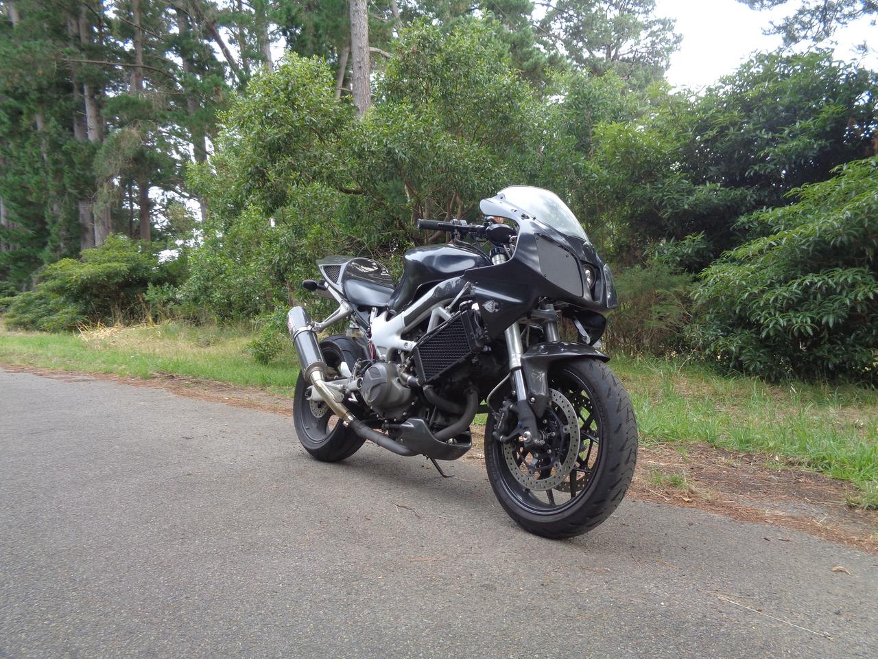

My Custom/Streetfighter

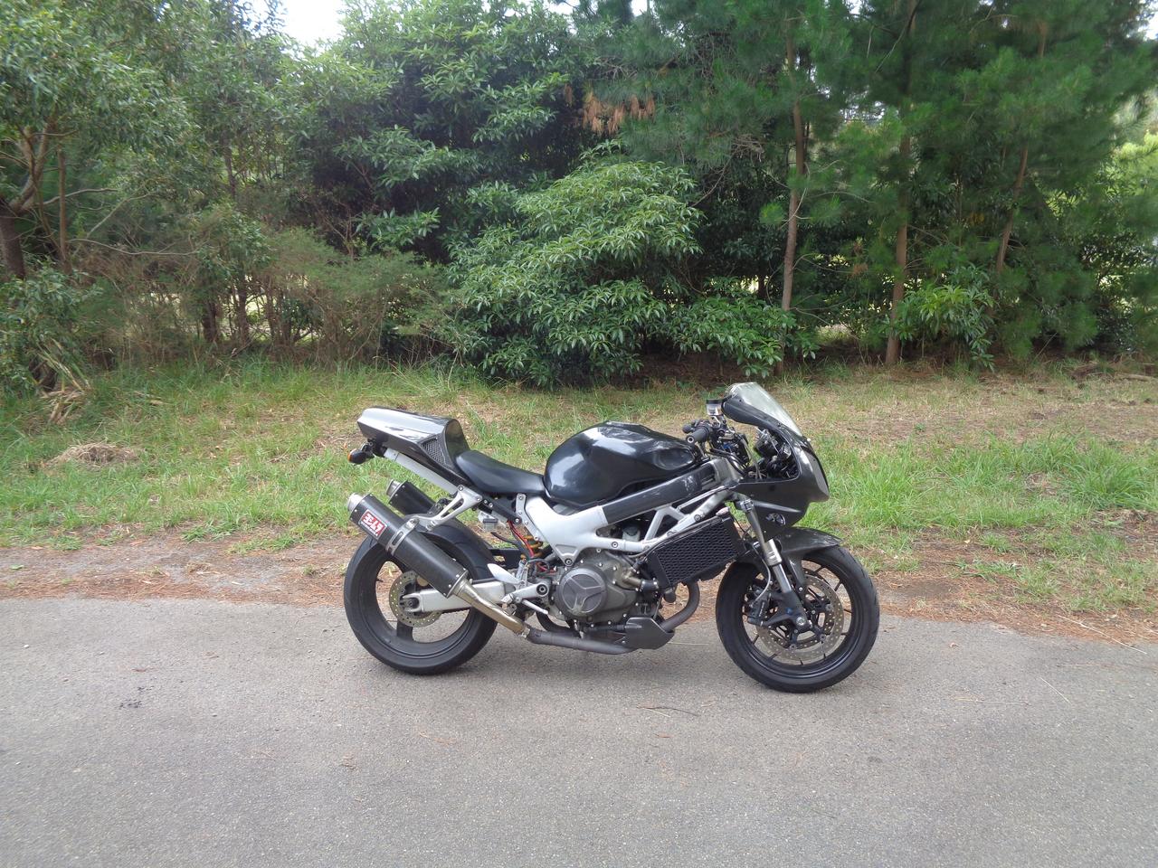

List of mods, .. what I can remember !

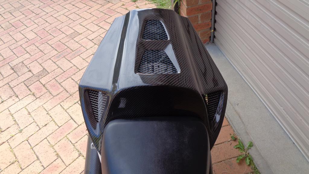

2007 CBR1000RR rear subframe,
2007 CBR1000RR shortened Carbon fiber rear tail,
Yamaha YZF R1 regulator/rectifier,
12amp hr battery,
2012 CBR1000RR front end (forks, front wheel, disc's, brake calipers, etc)
Venhill stainless front brake/clutch lines,
Buell XB headlight,
Carbon fiber Buell XB front screen,
Carbon fiber CBR1000RR front guard,
2005 VTR SP2 front brake master cylinder & clutch master cylinder,
K&N oil filter,
CRG Spectrum adjustable shorty brake/clutch levers,
2012 CBR1000RR triple clamp with VTR SP1 stem swap, and custom spacers,
Custom rear LED brake light designed and fabricated by myself,
PAIR valve removal,
PSR PAIR cover plates,
CBR600rr stick coils mod,
Driven Racing Carbon handle bar,
Driven Racing bar risers,
Driven Racing grips,
I painted the tank myself, the colour is Black Pearl.

Old Jan 2, 2022 | 12:10 PM
Posts: 1,997
Very nice. Yeah, you have the sickness too.
Old Jan 2, 2022 | 12:24 PM
Vinracing315's Avatar
Joined: Sep 2020
Posts: 13
Vinracing315 is on a distinguished road
Good job on the tail section!

Old Jan 29, 2022 | 07:42 PM
hondavtr1000sp2's Avatar
Posts: 348
From: Melbourne Australia

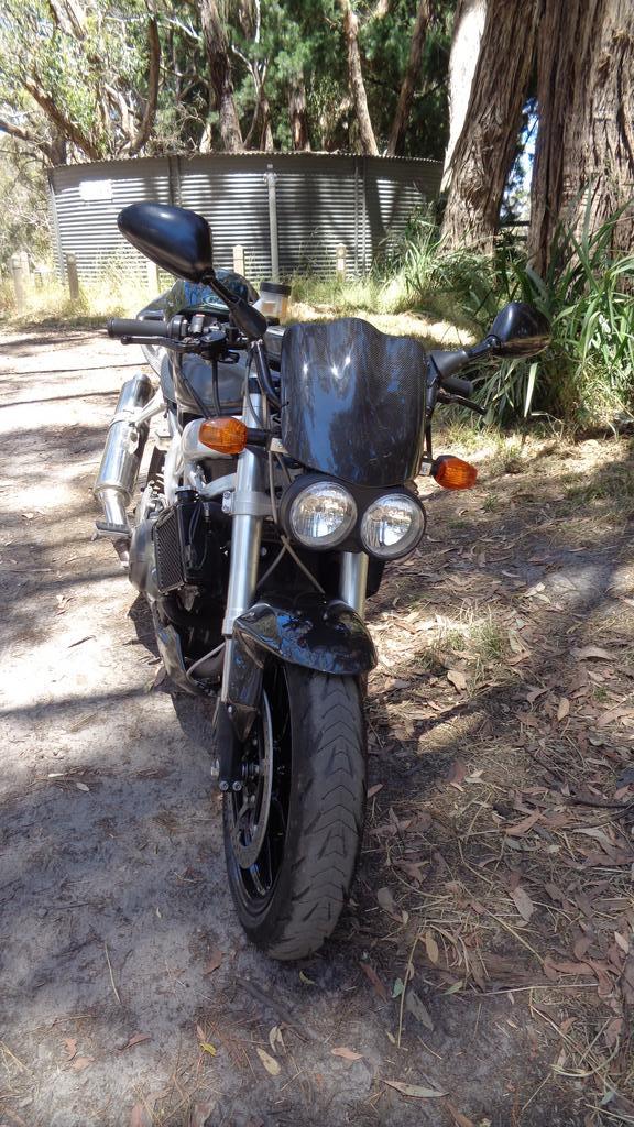

Old Jan 30, 2022 | 07:40 AM
Posts: 5,223
Very nice execution!
Old Feb 7, 2022 | 07:50 AM
misnblu's Avatar
Adrenalin Junkie
Joined: Aug 2020
Posts: 123
From: Gulf Coast MS
misnblu is on a distinguished road
I love it. 🥰
I bet it's a blast to ride and turns heads.
The custom work is superb and looks like a factory bike it's so well done.
Exceptional and thanks for sharing. 👍🤙

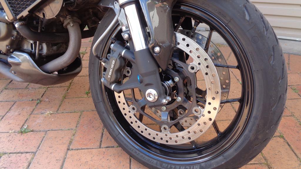

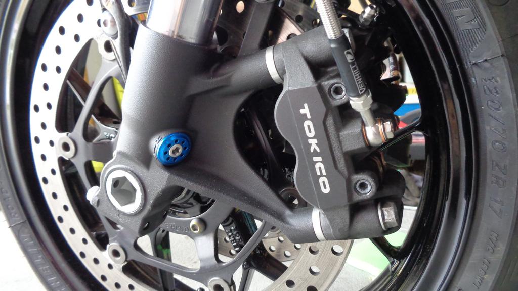

Um, maybe call this a long term update on the front end swap,
its been around 10 month's and 3,000k's since I did the CBR1000 front end swap,
all seems to be going well ... chicken strips on the rear tyre virtually gone ! , so I suppose the new front end works fairly well then !?

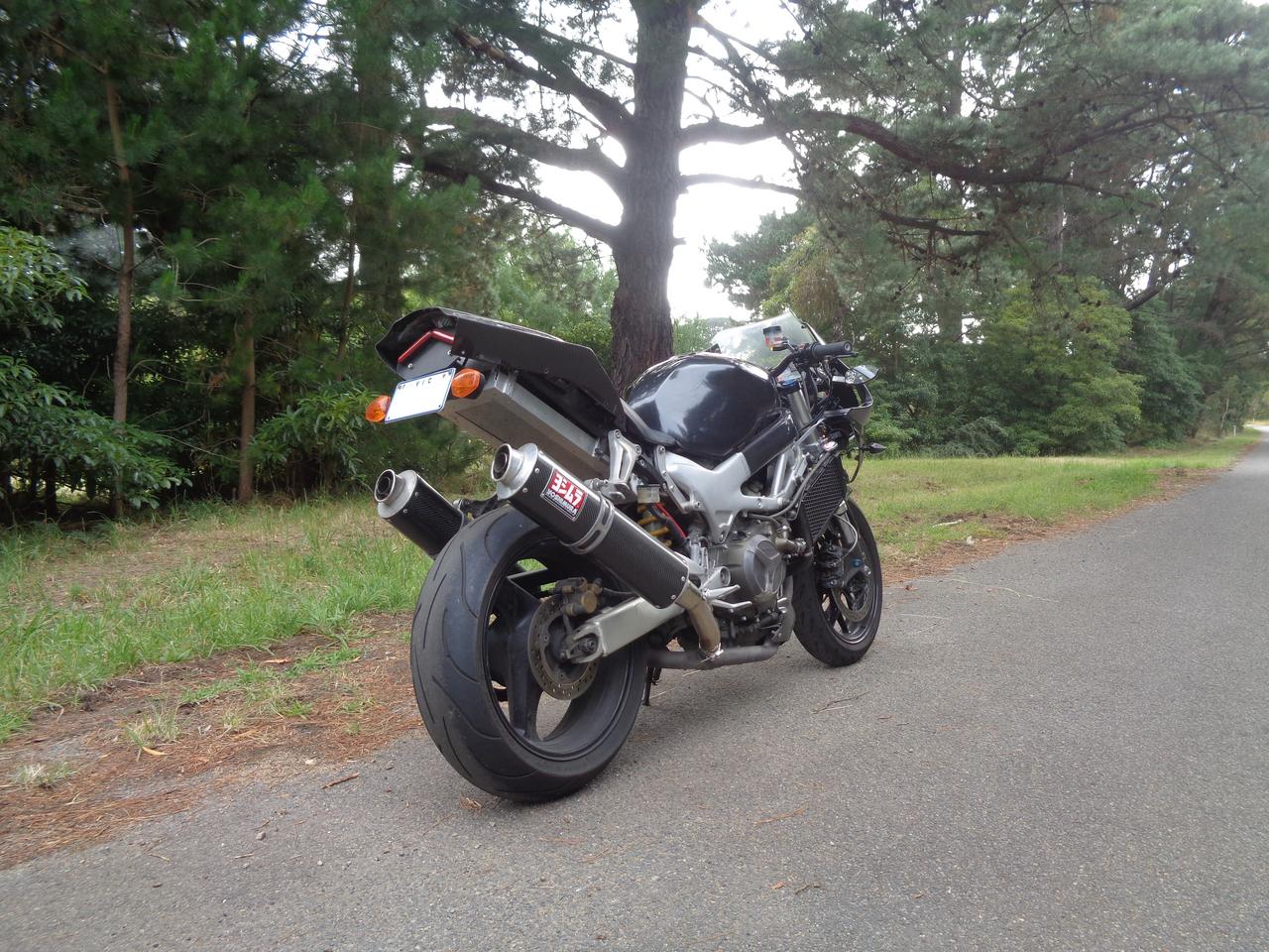

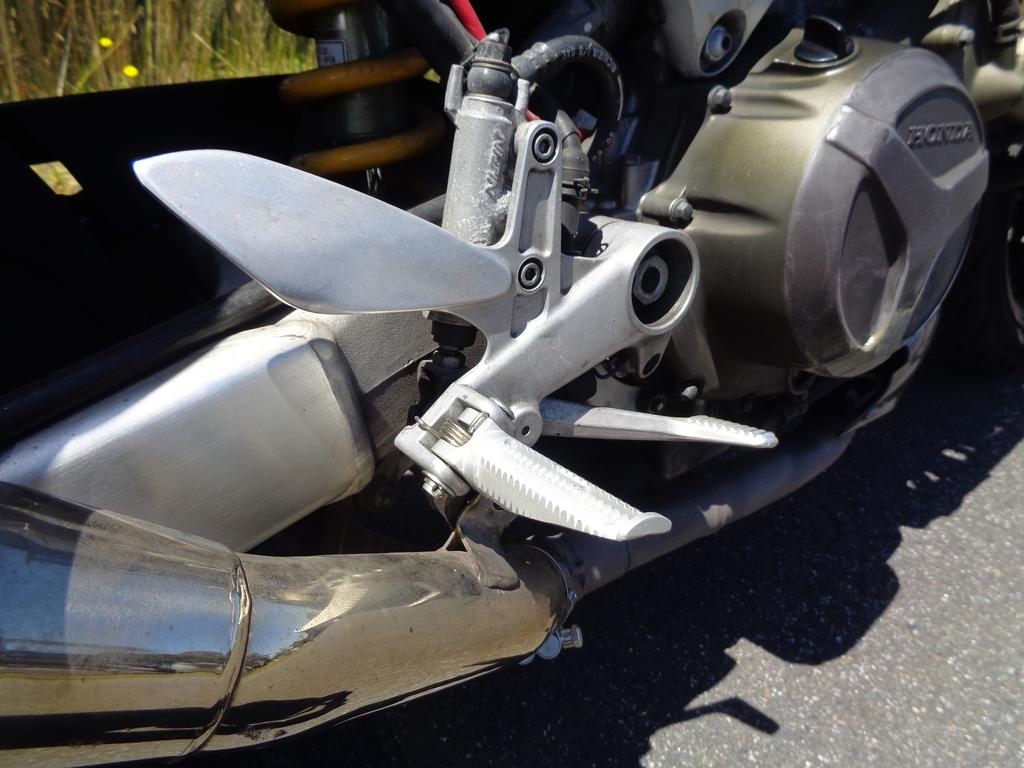

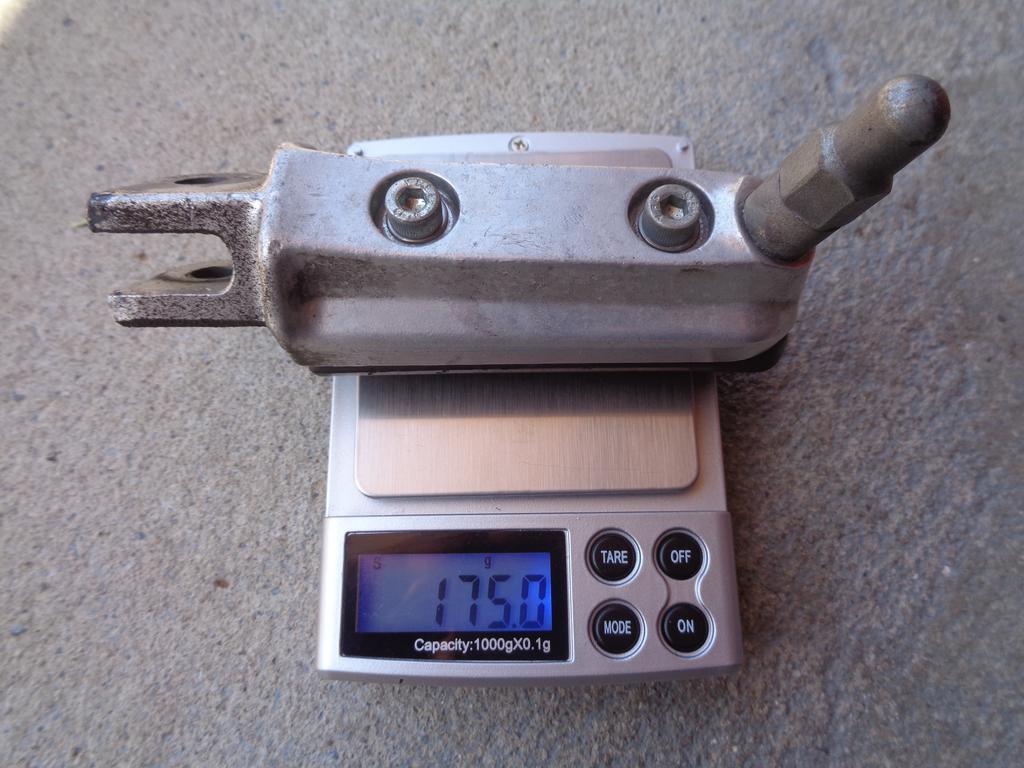

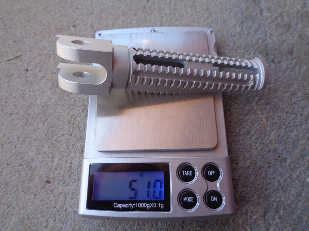

Carbon fiber Yoshimura's back on,
Carbon fiber/Kevlar frame covers on,
and a bit more weight saving with new foot pegs,

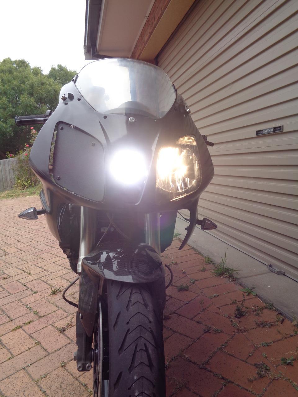

Had this RC51 fairing sitting around collecting dust,
also had left headlight,
thought I would do this,
old Firestorm windscreen fits with some minor modification, trimming & a few new holes drilled,
wired everything up,
coat of paint,
new front L.E.D indicators and L.E.D driving light for High beam ,
made a cover/fill in plate for the missing headlight and also wired up the positon light for the headlight,

Old Feb 5, 2023 | 06:04 AM

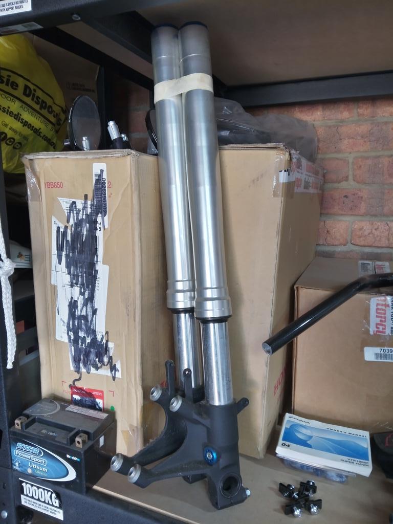

Posts: 5,223
What fork set did you use?
Old Feb 6, 2023 | 10:26 PM
Posts: 348
2012 Honda CBR1000RR Big Piston ...
I had a suspension shop strip the black off and clear anodize them.
