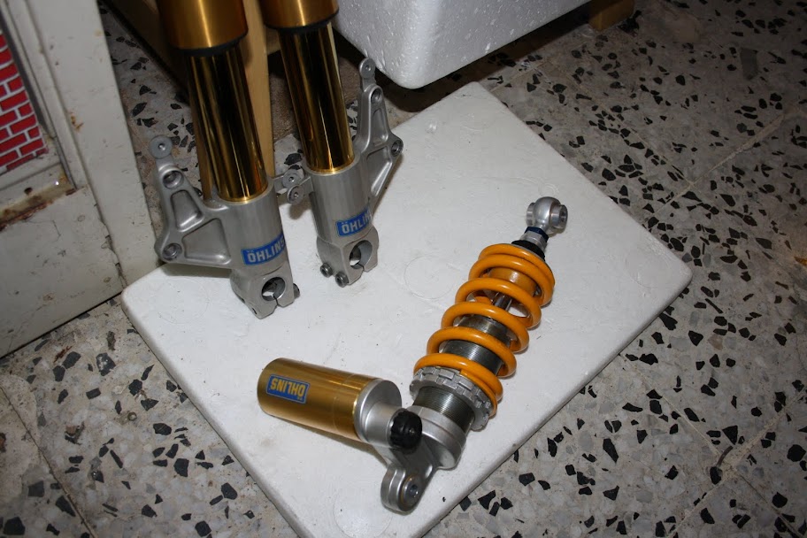

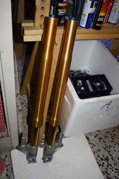

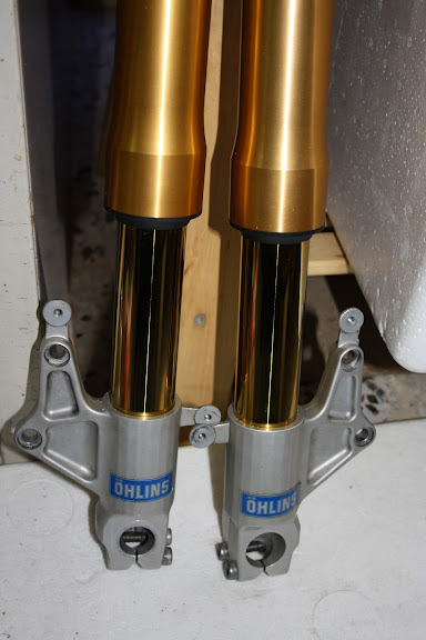

My work are in progress, last night i've finish to mount the fork (a Showa from Ducati 998s whit ohlins internal mod) and i'm waiting for a complete exhaust system by Rumi. I've to mount a Starlane electronic quick-shifter and a GPT 3d instuments (for tachometer, RPM, lap-time, temperature, ecc...)

Is that a RS250 rear shock?
Col

Yes, but I would to change whit the ohlins in one of the latest photos...

This shock was full-regolable, and whit a bush (?? I've translate this word whit google... i hope you can understand!!!) of 25mm I have change the the entire length... (and now the distance from the top bolt point and the low bolt point are the same like the original vtr shocks)
It's a good shock, expecially if you lighten your bike (near the weight of the RS...), but... the problem is: for every kg that my bike lost, I gain it on my belly (1 beer for 1 hour of work in garage on the bike.... and that's the results!!!)
So.... I need to change whit the ohlins shock (it can sustain me better...)
Ah, the Ohlins shock was stolen from a RSV R, is not for the SH...
