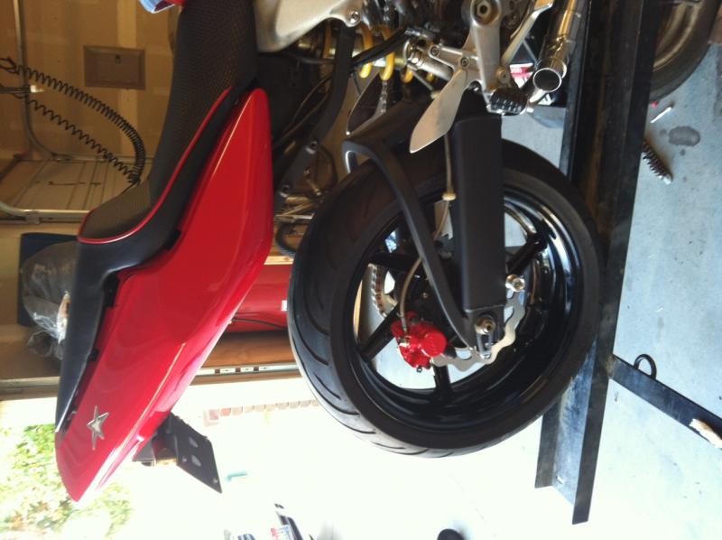

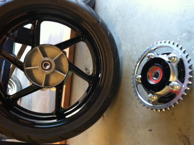

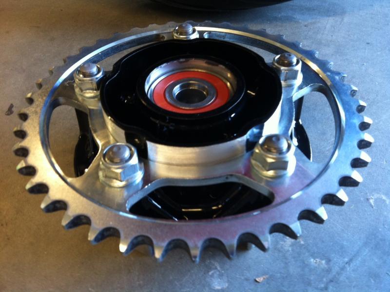

Wheel is waxed, balanced, and ready to go.
Cush drive is sanded in the sprocket area, and waiting for a new seal.
James
Attached Thumbnails James' 2001 Honda VTR1000 Build-photo-1-2.jpg   James' 2001 Honda VTR1000 Build-photo-2-2.jpg

Curious on the gloss wheel/flat swinger look. Will have to wait and see. I personally think your Ohlins shock w/ gold slider fork would look great. Maybe anodize a pair of the danmoto rear sets...

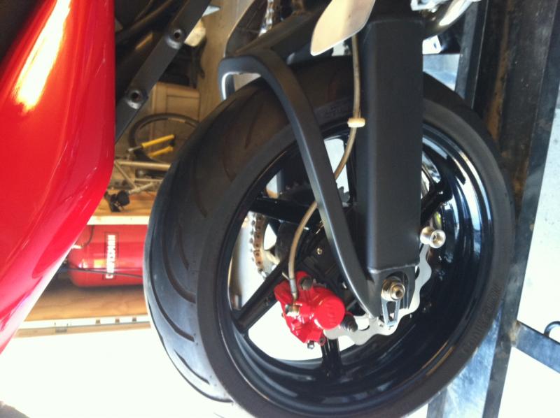

The theory is that the flat black frame will fade into the background, and give the red fairings a deeper red look. The gloss black wheels should pop quite a bit in comparison.
I really need to figure out what to do with the front wheel. It looks terrible. Maybe just an F2 front wheel as a temp fix....

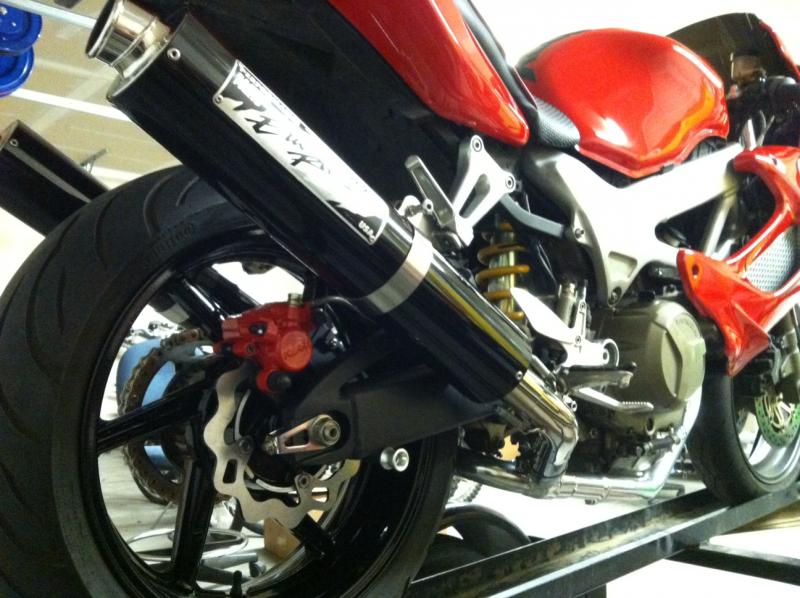

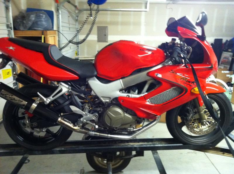

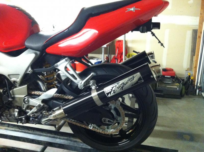

The install....
Attached Thumbnails James' 2001 Honda VTR1000 Build-photo-1-3.jpg   James' 2001 Honda VTR1000 Build-photo-2-3.jpg   James' 2001 Honda VTR1000 Build-photo-3-1.jpg   James' 2001 Honda VTR1000 Build-photo-4-1.jpg   James' 2001 Honda VTR1000 Build-photo-5-1.jpg

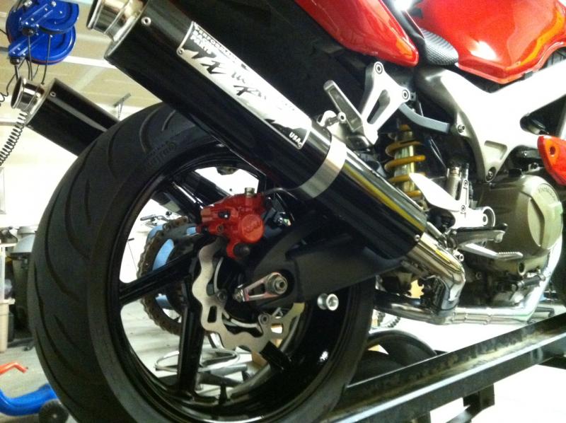

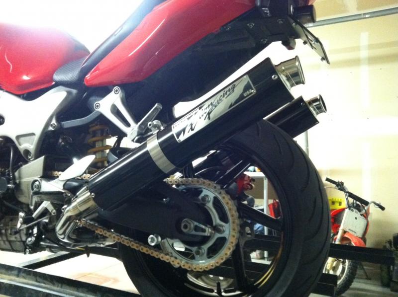

Final install...
Attached Thumbnails James' 2001 Honda VTR1000 Build-photo-1-4.jpg   James' 2001 Honda VTR1000 Build-photo-4-2.jpg   James' 2001 Honda VTR1000 Build-photo-5-2.jpg

James, just an observation while I'm camping with friends @ a local bike week. I'm seeing my Ohlins remote reservoir near the forks on a 'Busa which are gold coated. The 2 aren't even close. I don't think it would achieve your desired look. If you want me to try to get a pic, lmk.
To comment on the above pics... with your VTR being a work in progress, I think you're on the way to have one cool *** Hawk. Excited to follow along and watch the progress. Thanks for takin' the time to post pics. You definitely peaked my interest in the possibility of doing the swinger brace. Can you share how much you have into ($$) that one mod?

Yes... Pics
(FYI - I had planned to re-anodize the forks to match)

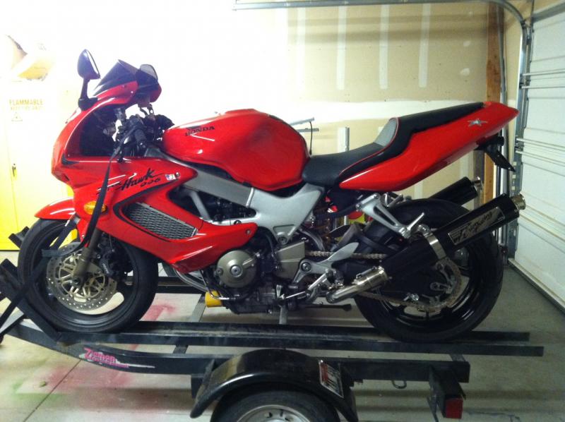

Did 100 miles today with friends from church. Road from Caldwell, Idaho, to Black Canyon Reservoir, then to Horseshoe Bend, then into Eagle, then back to Caldwell.
Superhawk did well. Few things are on my list to fix before the next ride, but overall it was a great time!!!

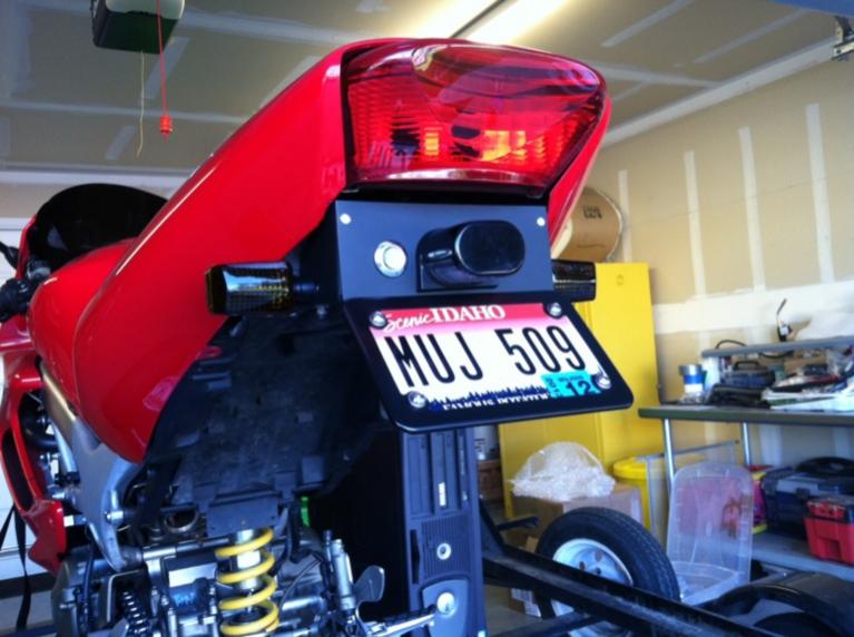

In your turn signal pic, the rear section where the seat unlocks is a black aluminum box. Mine is similar, only silver aluminum- I bought it that way.
I'm guessing that's something that a member did here, and sold? It's before my time. I'm sure it isn't stock, but whoever built it did a good job with the design.

I think I replied about this in another thread. It's a Competition Werkes (or Lockhart Phillips) Fender Eliminator Kit. It is comprised of a 3 piece stainless steel plate setup.
I had mine powdercoated flat black so it blends in, instead of the shiny stainless...
It's a $100 kit available through any aftermarket retailer.
