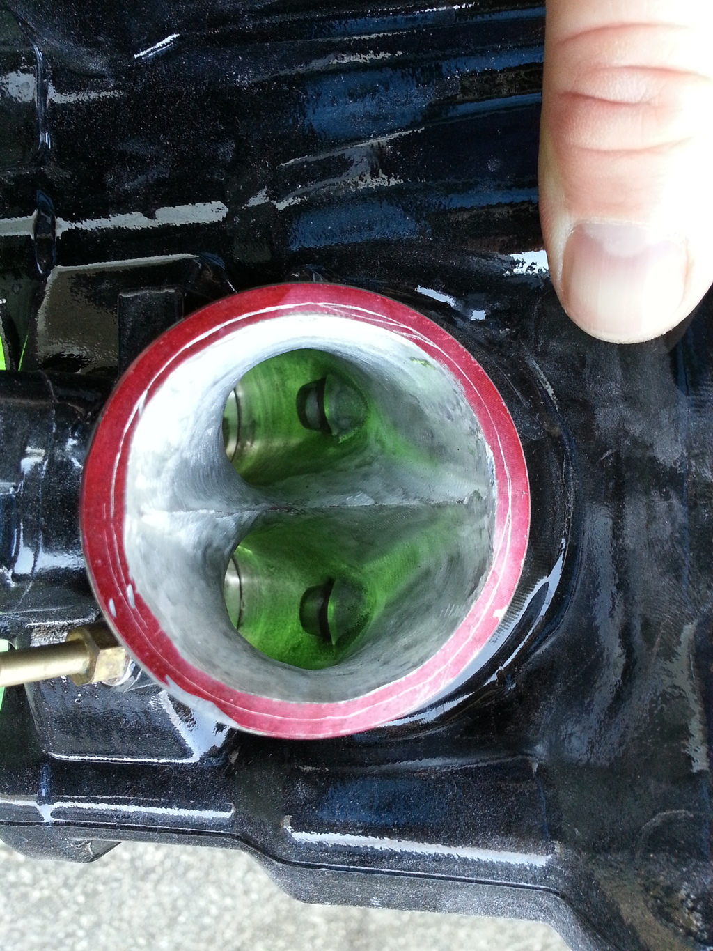

With this fantastic weather, I decided to **** off my neighbors and tackle the heads. I got the first one 90% done. Still need to open the intake up a bit more and then polish the exhaust side. Tomorrow, I'll tackle the other head.
The powdercoating guy didn't call, so it looks like I'll get my stuff next week. I hope.

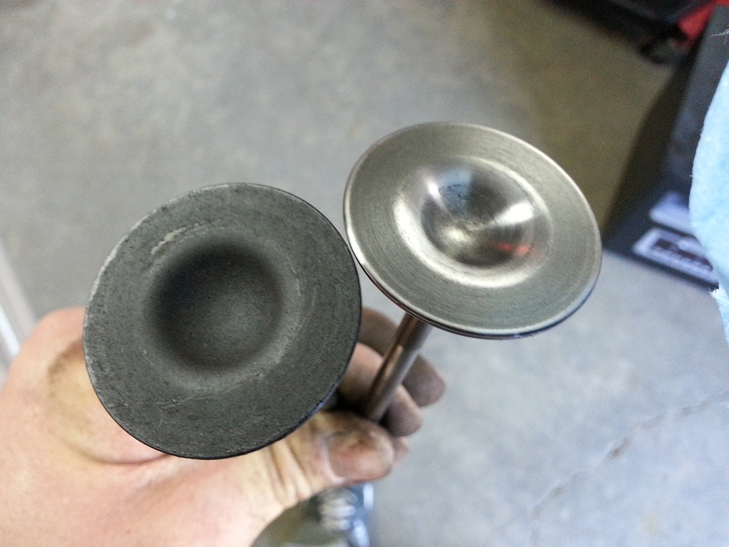

Awesome weather today. Could it have been any better? I submit that it cannot! Got both heads ported. Polishing is up next. Found a neat trick to help lap the valves. Involves a piece of vacuum tubing and a drill. Makes it so much easier! Those wooden sticks with rubber suction cups on the ends can suck it.
I chucked the valves in the drill press and cleaned them up.
Grilling chicken & veggies while I write this out on our deck. First time we've been able to do this since last year. I live about a quarter mile from a major highway and all day I have been hearing motorcycles flying down the road. Talk about motivation!
Anyways, more pictures tomorrow. Hopefully an engine with the heads on.

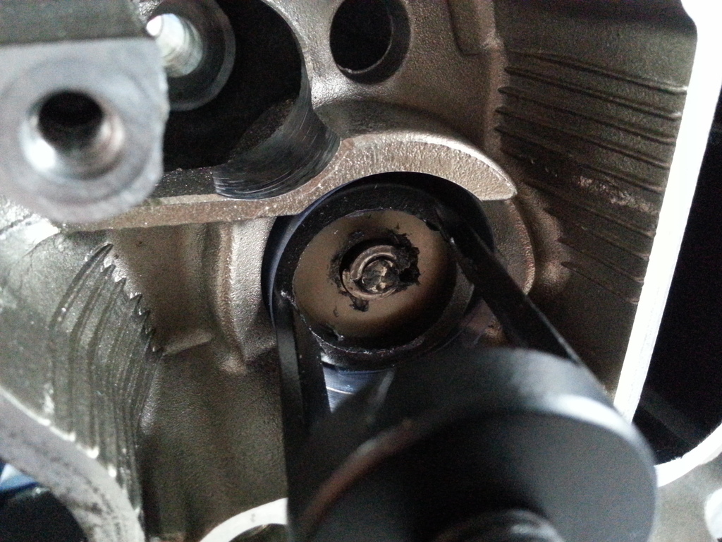

Got the heads on and torqued down! After the first set of collets, the rest go super easy. Next up, installing the WebCams cams and degreeing them in.

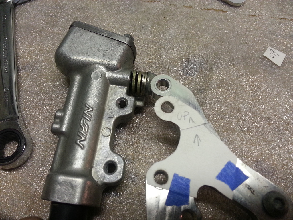

First project I need to tackle tomorrow is the cutting and welding of the Moriwaki rearset for the new rear master cylinder. So, I'll update with pictures of that tomorrow. Wish me luck!

So, tonight after dinner, I got some energy, the first amount of any energy since my procedures this past Monday. I needed an outlet, so I decided to tackle the rearset. In hindsight, I should have waited untill I was more clear headed. I still feel like I'm in a fog with my body healing. And then this happened. I cut it, welded three sides removed the master cylinder and while welding the fourth and final side, I put too much heat into it and...we have meltyness. Oops. Looks like I'm going to Speedy Metals tomorrow to pick up a 1/4" sheet of 6061 aluminum. I am glad I made a template before I even started cutting anything. It's an easy fix, just takes time. At least it's a small part.

EDIT: Xeris, the rear master cylinder is from a '04 Suzuki RMZ250. Looking at the stock rearsets (if you have them), it wouldn't be to hard to make a bracket to attach this master cylinder to.
I went to Speedy Metals and asked for some scraps they have laying around and for $7.30, I got more than I needed!
The weld isn't pretty, but it works. The weld is hidden by a heel plate anyways.

I polished it up a little to help it match the rest of the rearset. On the bike this master cylinder comes from, it is rotated 180 degrees. After putting it all together, I realized that it would in fact be possible to mount it 180 degrees. I will see how this works out first. In this configuration, if a resevoir extension is needed to make the reservoir bigger, then I will forgo that resevoir extension and remake the mount so it sits 180 degrees from how you see it in the pictures. That way the top of the resevoir will be flat and parallel to the ground, like it was on the bike it came from. Then, I can get my rear brake line made.
I need help from you guys with one question. In the picture below, it shows that the brake arm is slightly off (~1/8") from being right below the master cylinder. I noticed that the stock rear master cylinder and this new one both have a little movement in the shafts. Is it okay to have it this far off? Will it wear out seals faster? If I have to fix this, then I will remake the mount and flip the master cylinder 180 degrees.
