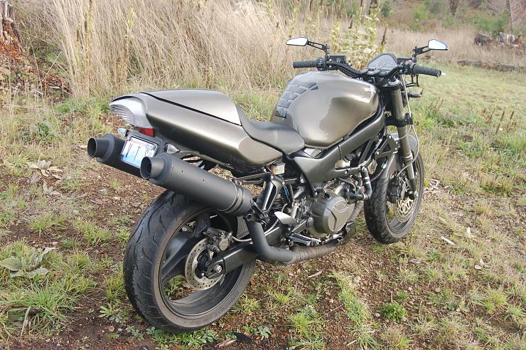

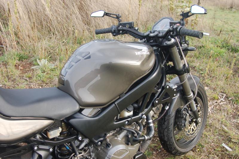

2001 naked, I know, but it turned out nice reeel nice
Currently I am working with JD on the F4I rear shock conversion. I am soon to change the handlebar clamps to install a Scott's damper. I need to vent the rear cowl for the underseat radiator. Installing a Vortex rear sprocket 41T this weekend, down from the 43t. Hoping to get some MPG back????
Lots of bikes here.....
954RR front end, CBR1000RR meter assy, CB1000 Clutch master, 919 Brake master, CBR1100XX footpegs......
Powdercoated engine and valve covers, frame swingarm and brake calipers.
What a fun bike to ride, I've had many CBR's and VFR's and I really like this bike...... Other than the fuel range....
Any Ideas or feedback??? On anything???
Attached Thumbnails 2001 naked, I know, but it turned out nice reeel nice-vtr-11-08-132.jpg   2001 naked, I know, but it turned out nice reeel nice-vtr-11-08-135.jpg   2001 naked, I know, but it turned out nice reeel nice-vtr-11-08-136.jpg

Very well executed. Actually looks right with everything in proportion and no bits and pieces hanging off looking like they don't belong.
Wouldn't mind a few more pics to see how the front looks.

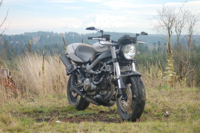

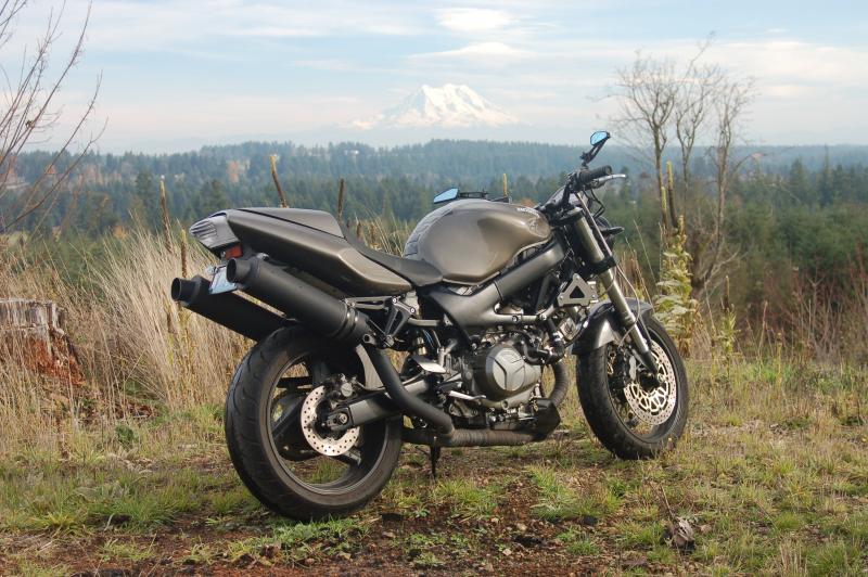

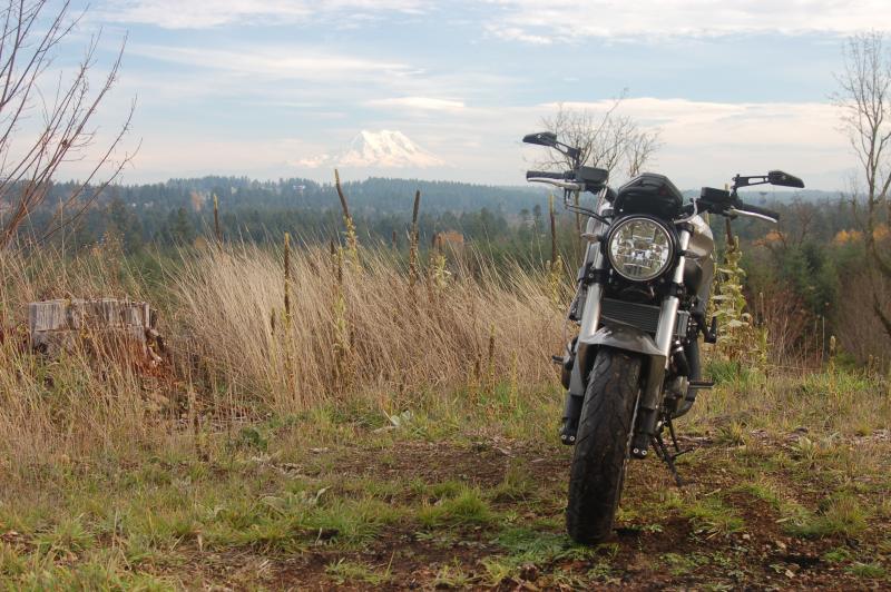

Front photos
Oil cooler will be black soon....

What's cooling the motor? I see coolant hoses but can't tell due to small pics.

How in the heck do I post larger pics, like others I've seen posted.
The radiator is underneath the seat. I had it custom made. It is brass and thick to add as a heat sink. So far here in mild Washington the engine temps vary. The last time out it was 45-50F outside and the bike ran around 204-206F. I will cut out vents on the rear cowl to help it breathe. I may go with another small aux fan like the 1000rr.
